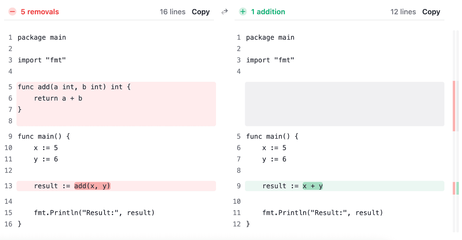

Here’s a side-by-side diff comparison of the code, exhibiting the inlining:
A side-by-side comparison of code with and without inlining.

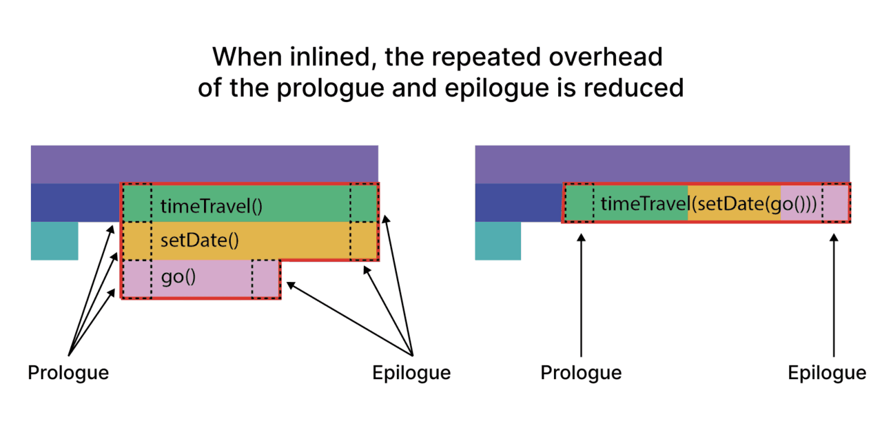

In the example below, inlining transforms a flame graph with several layers — timeTravel(), setDate(), and go() — each with their own prologue and epilogue, into a single layer where the calls are combined: timeTravel(setDate(go())). This again demonstrates how inlining reduces the repeated overhead of prologues and epilogues.
An image depicting reduced overhead from inlining.
There is one important thing to note: while the inlining concept is visually represented here for clarity, the actual inlining process happens during compilation, without altering the source code. The real effect of inlining is observable in the optimized binary or the generated assembly code, where the function call overhead is eliminated, improving the execution efficiency of the program.

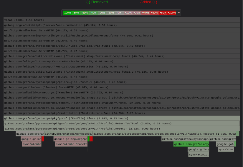

Internally, we’ve found low-hanging fruit of 2-5% performance improvements, which are easily measurable in our diff view:
A flamegraph showing performance gains.
While this percentage may seem small, using PGO in your Go workflows provides a lot of value with minimal downside, so we recommend trying it out!
