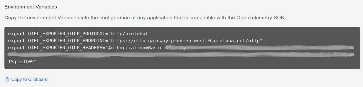

Next, we need to gather authentication environment variables to connect to Grafana.
  1. Sign into Grafana Cloud (don’t already have a Grafana Cloud account? Sign up for a free one today). The browser will navigate to the Grafana Cloud Portal page: https://grafana.com/profile/org. If the account has access to multiple Grafana Cloud organizations, select an organization from the top left organization dropdown. If the organization has access to multiple Grafana Cloud stacks, navigate to a stack from the left sidebar or the main Stacks list.
  2. With a stack selected, or in the single stack scenario, below Manage your Grafana Cloud Stack, click Configure in the OpenTelemetry section.
A screenshot of the Configure button for OpenTelemetry.
  1. In the Password/API Token section, click on Generate now to create a new API token:
  • Give the API token a name for example, test-service.
  • Click on Create token.
  • Click on Close without copying the token.
  • Click on Copy to Clipboard to copy the environment variables to the clipboard.
A screenshot of environment variables.
  1. Pick a Service Name to identify the service for example, test.

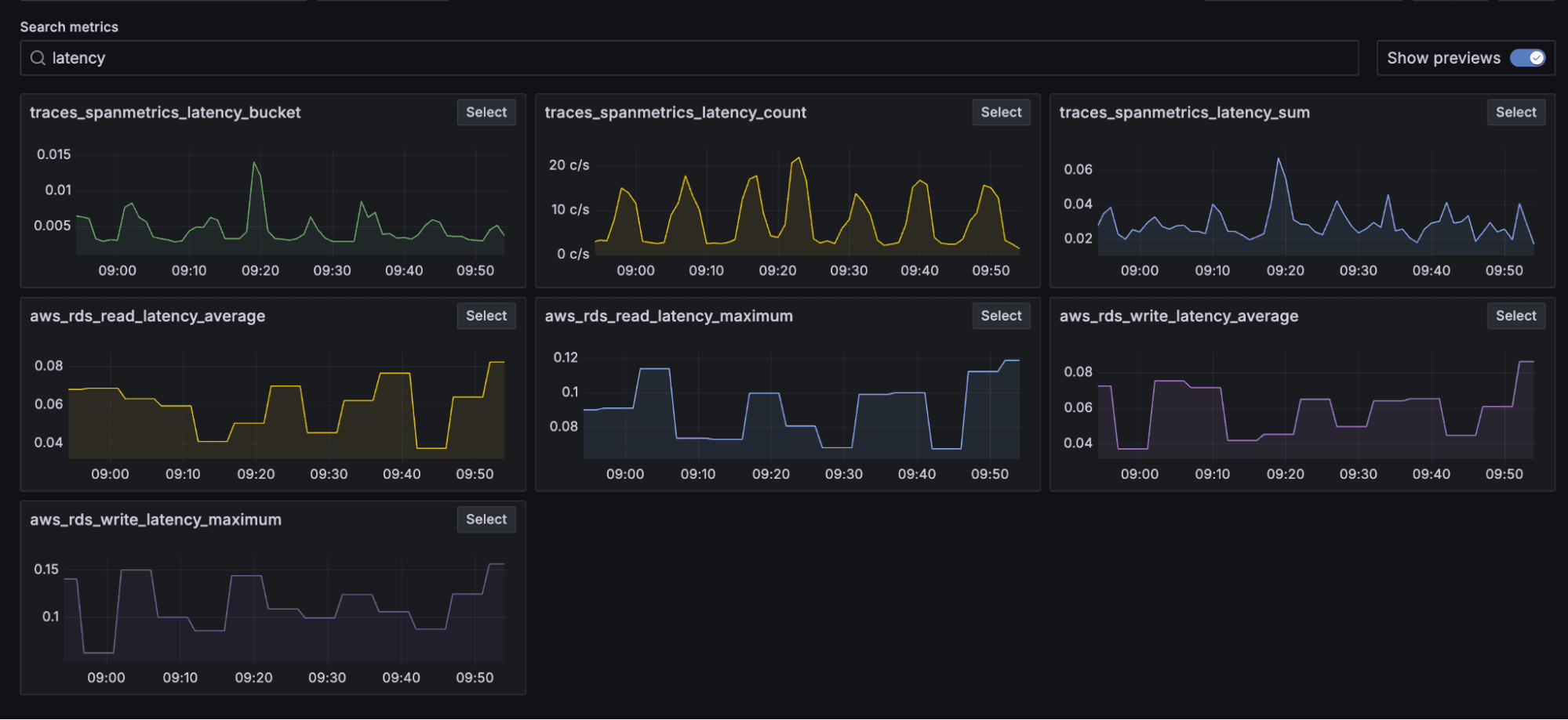

Identify problematic resources
The metrics page will list all metrics that are currently being sent to your Grafana instance. You can also filter by the metrics you want to focus on, such as latency.
A screenshot of the filter by metrics feature.
From the list, you can then choose the charts you want to further analyze by clicking Select.

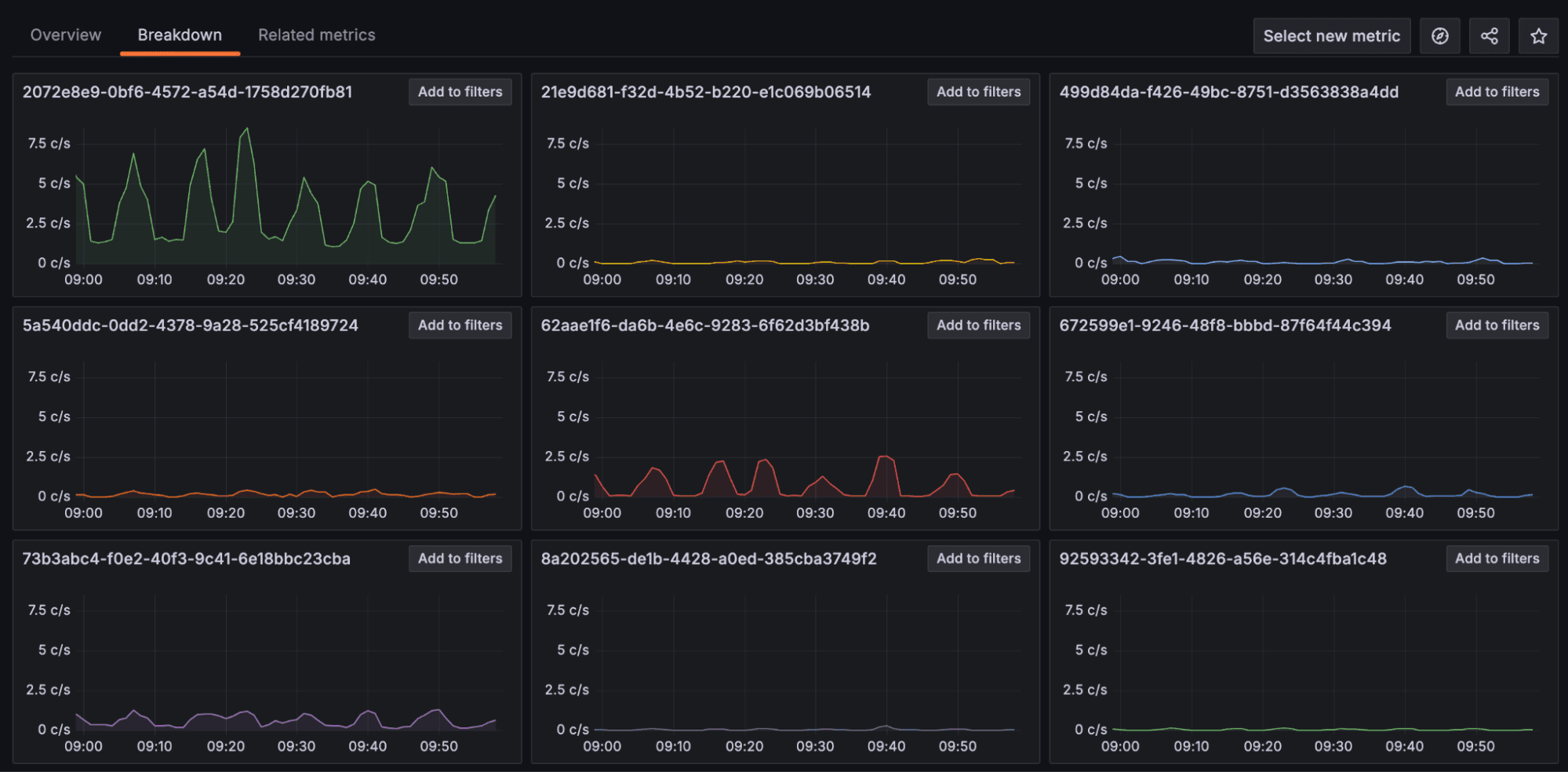

For example, select the chart for traces_spanmetrics_latency_count and it will open a page that lists all possible resources that you can do a breakdown on. By clicking on any of the values, you can see different charts broken down by the different attribute values of the resource you selected. You can also make this selection by clicking on the Breakdown tab, and then on any of the resource names. Here is how it looks when selecting host_id:
A screenshot of the Breakdown tab.
In this example, we can see that the first chart has higher values compared to the other ones. If you already know the difference of that host compared to the others, that can help you identify what is causing the higher latency values for that specific resource. This would work similarly if choosing other resources, such as service_instance_id and so on.

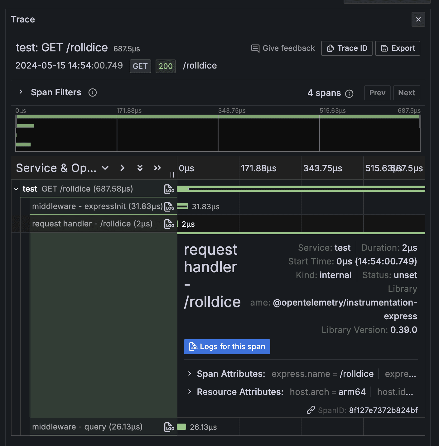

This will list traces that match the value you selected. To get more details about those traces you can:
  1. Click on the value of the column Trace ID for the trace you’re interested in. This will open a new area on the right with details about the trace.
A screenshot showing trace details.
  1. Click on any of the rows within the Service & Operation section and it will open details about that span.
A screenshot of the Service and Operations section.
  1. Click on Resource Attributes or Span Attributes and it will list all values sent with that span.
A screenshot of the Resource Attributes section.
With the value of the resource attribute in hand, you can make decisions around which values are the best for your application and then adjust parts that are not performing as desired.
