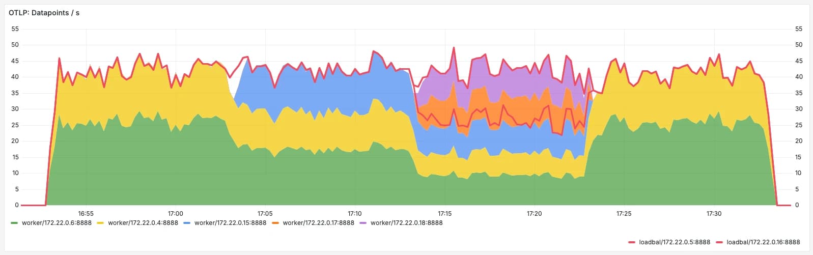

Once started, we can clearly see the even distribution of data points across the different workers, using the following query:
rate(otelcol_receiver_accepted_metric_points[1m])
In this example, the number of workers was scaled from two to three, then up to five, then back to two.
OTLP panel
The instances were DNS discovered as they came and went, with loadbalancing always evenly distributing load between them.
The load-balancer (red line) was scaled from one to two and back.
