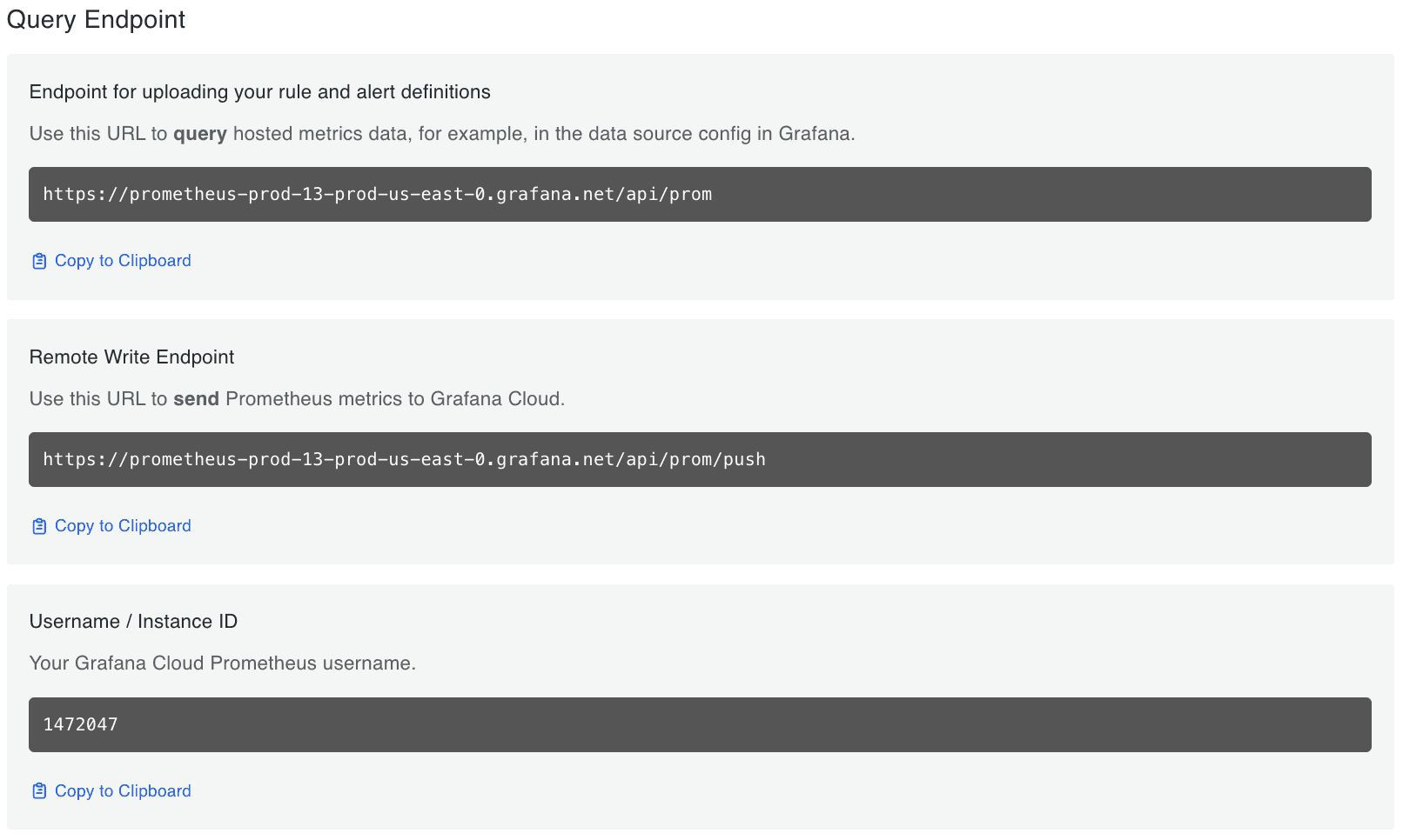

To send metrics to Grafana Cloud, get your credentials needed for Grafana Cloud Metrics. You can find the details in the Cloud Portal.
Screenshot of Prometheus data source button in Cloud Portal
Click on Details, and you should be able to see your Metrics User ID and Metrics URL.
Screenshot of query endpoint in Grafana Cloud Metrics
Next, you should adjust the endpoint URL based on your Prometheus card details in the Grafana Cloud portal. The general format would be replacing prometheus with influx in your endpoint and modifying the path accordingly.
Example:
Original: https://prometheus-prod-03-prod-us-central-0.grafana.net/api/prom/push
Modified: https://influx-prod-03-prod-us-central-0.grafana.net/api/v1/push/influx/write
