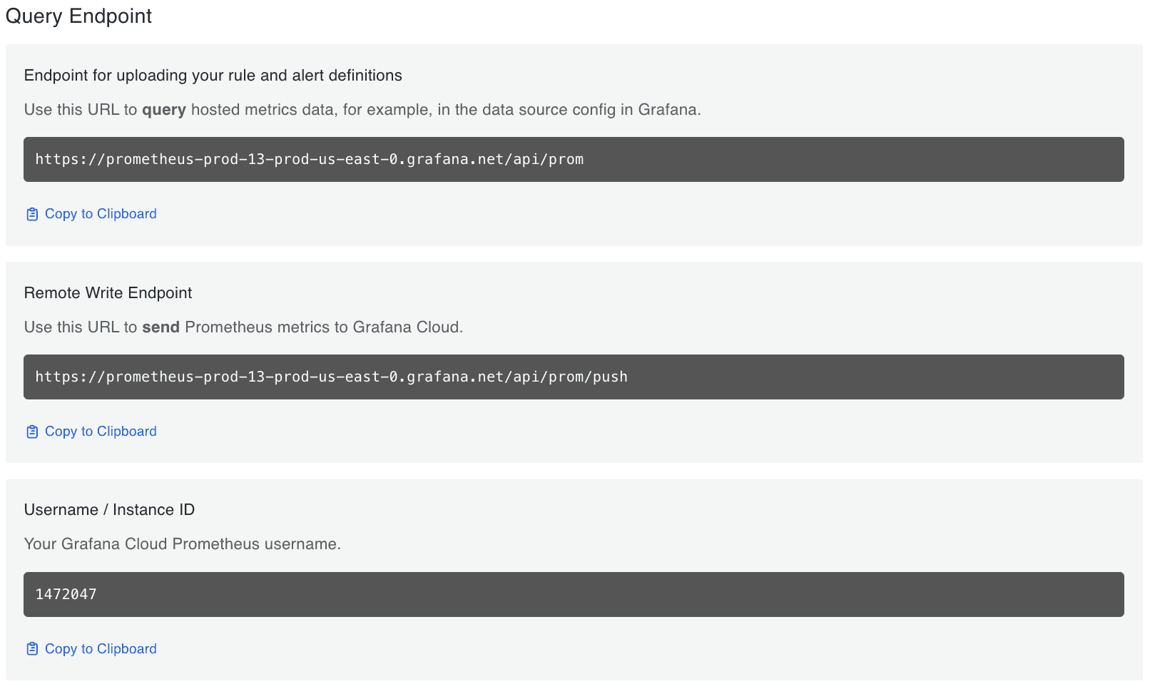

Click on Details, and you should be able to see your Metrics User ID and Metrics URL.
Screenshot of query endpoint in Grafana Cloud Metrics
Next, you should adjust the endpoint URL based on your Prometheus card details in the Grafana Cloud portal. The general format would be replacing prometheus with influx in your endpoint and modifying the path accordingly.
Example:
Original: https://prometheus-prod-03-prod-us-central-0.grafana.net/api/prom/push
Modified: https://influx-prod-03-prod-us-central-0.grafana.net/api/v1/push/influx/write

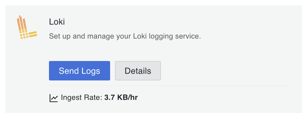

You can send logs to Grafana Cloud Logs using Grafana Loki’s HTTP API. (Grafana Cloud Logs is powered by Loki.). The process is straightforward and involves posting JSON payloads representing your log entries.
To get your credentials needed for Grafana Cloud Logs, You can find the details in the Cloud Portal.
Screenshot of Loki data source button in Grafana Cloud Portal
Curl
curl -X POST -H "Content-Type: application/json" -H "Authorization: Bearer <LOGS_USERID>:<API_KEY>" -d '{"streams": [{"stream": {"Language": "Curl", "source": "Shell"},"values": [["'"$(($(date +%s)*1000000000))"'", "This is my log line"]]}]}'
