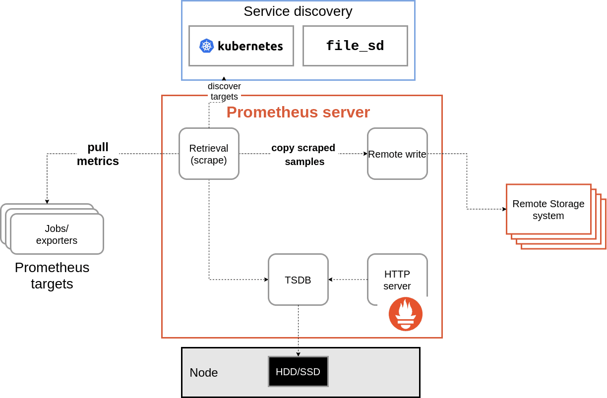

First, let’s discuss how remote write is implemented. In the past, remote write would duplicate samples coming into Prometheus via scrape.
This was beneficial because it meant remote write would receive all relevant info for a sample. It would then send the data on to the remote storage endpoint. The main issues here were that we needed to use a fixed size buffer to buffer samples from scrapes if, for any reason, there was an issue with sending samples on to the remote endpoint.
It’s important to note that one of our design goals with remote write is to avoid data loss, meaning we try to ensure every sample that’s scraped and stored in Prometheus is also sent out over remote write, if possible. This fixed size buffer meant we either had to drop new samples or older samples already in the buffer if we tried to append to the buffer and it was full. The other scenario is that the buffer could be sized to handle a larger amount of samples, but in many cases, Prometheus instances are running at or near their memory limit when remote write is behaving properly in the first place.
Increasing the buffer size would mean any disruption that would interfere with Prometheus sending to the remote endpoint could OOM that Prometheus instance. In both scenarios, we could lose data. In an effort to reduce the chance of data loss, we decided to make some design changes to remote write.

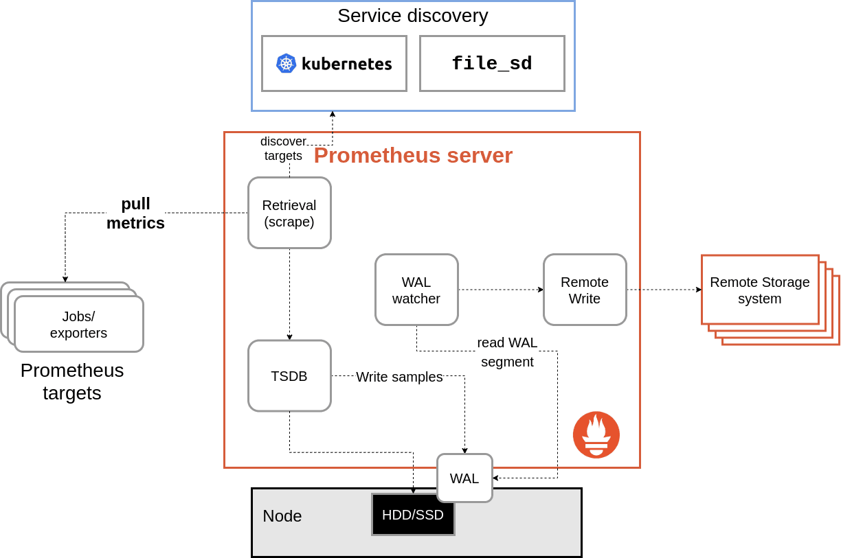

The major change we made is that remote write now reads data from Prometheus’ write ahead log instead of buffering samples directly from scrape.
Data generated by scrape is written to the WAL, so this essentially gives us a 2- to 3-hour buffer on disk of data for remote write. The RW system now has a subroutine that reads the WAL and passes the data back to remote write.
Remote write still has a small in-memory buffer, and the routine reading the WAL pauses where it is if it’s not able to append new data to the buffer. This means we no longer drop data if the buffer is full, and the buffer doesn’t need to be large enough to handle a longer outage.
As long as the remote endpoint isn’t down for hours, remote write no longer loses data (with some caveats, like Prometheus restarts), since the WAL is truncated every two hours or so.
