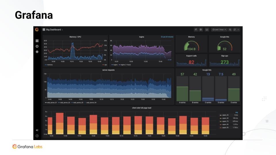

As everyone knows, the Grafana project began with a goal to make the dashboarding experience better for everyone, and to make it easy to create beautiful and useful dashboards like this one:

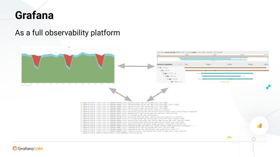

What Grafana Labs is really aiming to do now is make Grafana into a full observability platform. That means not only showing users their metrics, logs, and traces, he said, but also providing them with the ability “to be able to correlate between them and be able to use all three of those pillars to quickly solve their issues.”
Embedded image
In his talk, Ocenas covered the current capabilities of Grafana to integrate metrics, logs and traces, gave demonstrations of how to set up both Grafana and application code in order to enable them, and discussed plans for how to make all of this even easier in the future.

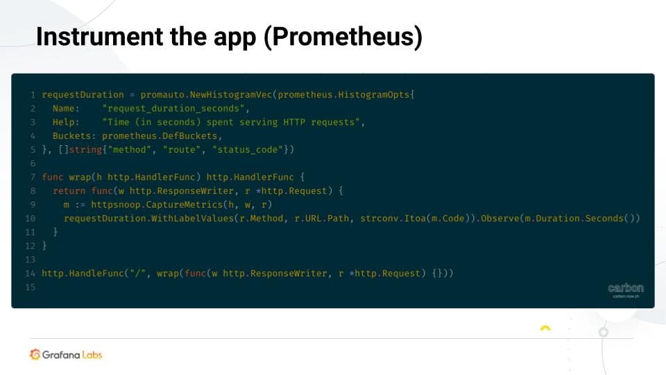

This is a go snippet of how you would instrument your app in Prometheus.
Embedded image
“Prometheus works in a way that you need to expose your metrics in one endpoint, then Prometheus scrapes that endpoint and gets the metrics from there in periodic intervals,” Ocenas explained. “There are lots of client libraries or exporters that will do this for you.”
In this particular case, it’s exposing a histogram of your request duration.
Embedded image

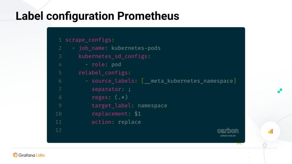

You have to configure labels on the server side of Prometheus, where you define what targets should Prometheus scrape.
“In Grafana, we use Kubernetes a lot, and Prometheus has a very nice integration with Kubernetes where it can autodiscover all your services and labels from the Kubernetes API,” he said. “So it’s easy to create labels.”
This is configured by the kubernetes_sd_configs key.
One thing to note: It will give you labels which are prefixed with a double underscore. Prometheus, by default, drops those. So you still have to do a relabeling configuration when you use those autodiscovered labels to create your actual labels in Prometheus.
“Usually you wouldn’t want to do this manually,” he noted. To make the setup easier, you’d ideally use something like predefined Helm charts or Jsonnet libraries if you use Tanka.

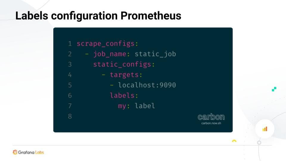

If you don’t want to use Kubernetes or the autodiscovery feature, you’ll need to configure labels statically, as demonstrated here:

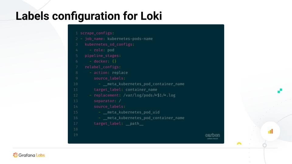

Instrumentation and labels: Loki

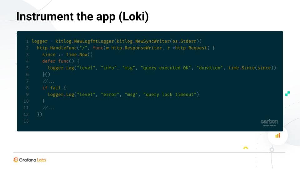

“For Loki, you do not need any special logging client library,” Ocenas said. “You can probably use whatever you are already using.”
Here is a gokit logging snippet, which is used in multiple Grafana applications:
Embedded image
Keep in mind this doesn’t get your logs to Loki right away.
For that, you would use something like a fluentd, fluentbit, or a Docker logging driver. You could also use promtail agent, which is what Ocenas used in his example. “That way, it’ll be something that runs next to your application and it works in a way that it scrapes your log files and then sends the logs to Loki,” he explained.
Embedded image
“One nice thing about the promtail agent,” he said, “is that it uses the same autodiscovery feature and mechanism as Prometheus.”
It also will give you the same labels, though – once again – they will be prefixed by a double underscore, so you will have to relabel them to make sure they match the Prometheus ones.
One important thing to note is that with the autodiscovery feature, you need to create a special label for Promtail to know what to scrape: __path__ (See the bottom line in the image above.)
As with the Prometheus example, Ocenas recommended using a predefined configuration template to make sure the final labels are the same in Prometheus and Loki.

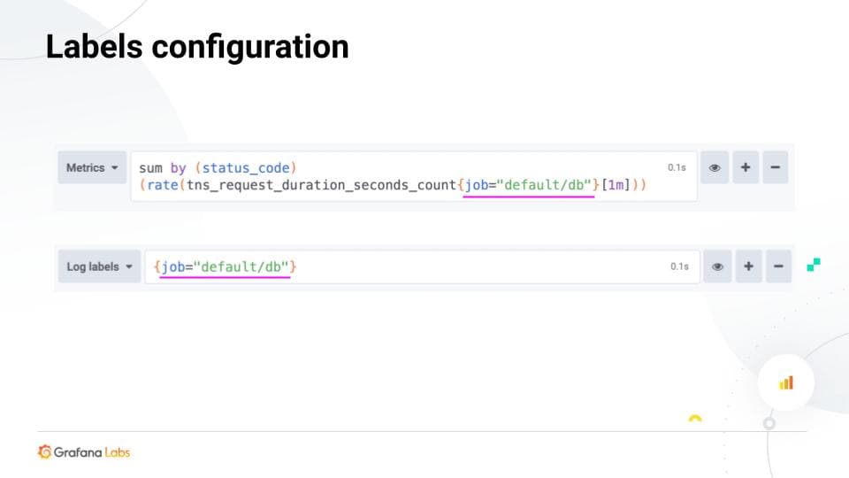

Queries
Having the same labels allows you to run similar queries and get data that is correlated across the apps.
At the top of the example pictured below is a Prometheus query. You can take the labels from there and create a Loki query that will give you data that correlates to the metric.
Embedded image
This is easy to integrate since Prometheus and Loki have a similar query language and labeling system. But any data source can implement an API that will allow it to translate the query from other data sources into its own query language, Ocenas said.

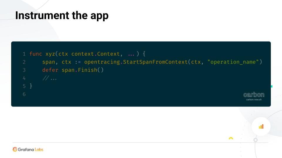

Instrumentation
Below is an example of a snippet that creates a Jaeger tracer, then uses an OpenTracing API to set the tracer as a global tracer for the application.
Embedded image
Then, you’d create a span for an operation somewhere else, as seen in the example below. You could do it manually, Ocenas said, “but ideally you would want your web framework to handle that for you – especially creating the trace on the request and then propagating the trace across service boundaries.”
Again, this example uses an OpenTracing API that wraps the Jaeger tracer.
Embedded image

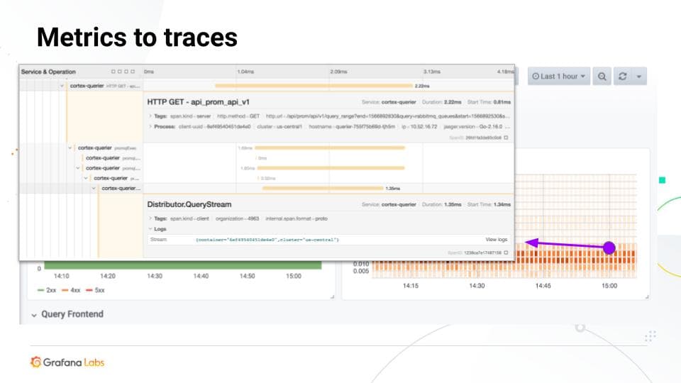

What the demo showed is that it would be much better to go from a latency graph directly to a slow trace. This is especially true as you don’t have an easy way to filter for the traces that took the most time to figure out what’s wrong.
“So for this, we need support from the backends, from the data source themselves,” Ocenas said. “The Prometheus team is actually working on this.” Their plan is to do with exemplars or an example traceId associated with a given metric and a histogram bucket.
“You’d have your 99th percentile bucket, and you would just already have some traceId there that we could use in Grafana and link you directly from the graph to the correct trace – make it easier to get there,” he explained.
This will be implemented in Grafana soon.

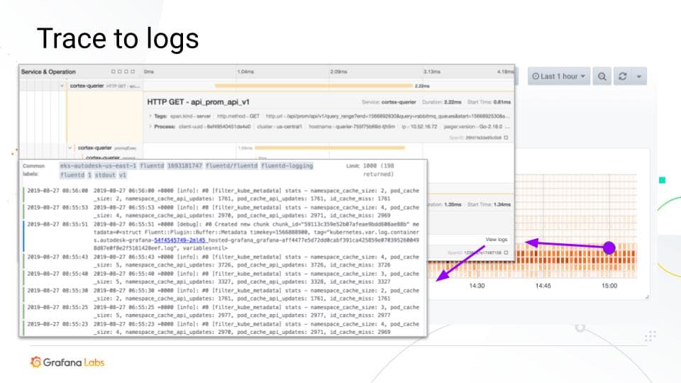

Another thing he said would be great would be to go from traces to somewhere else – like the logs that were generated by a particular trace.
To make this possible, a team is working on integrating a trace viewer directly into Grafana.
Embedded image
