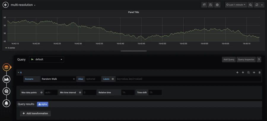

McKinley then debuted some new features (ones that the UX team hadn’t even seen yet!). He started by creating a new dashboard in Grafana and added a query to collect the last one minute of data.
But after the graph shows up, there’s the issue of how to deal with the roll-ups.

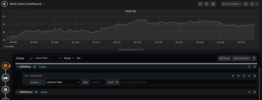

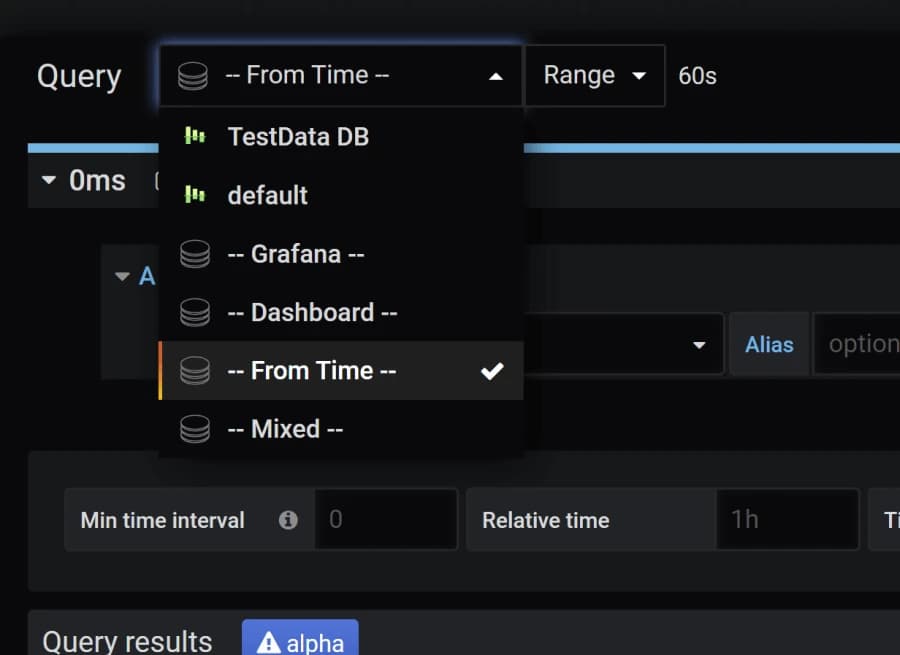

So McKinley added a new type of data source that can be accessed in the drop-down menu called “From Time.” Using that, the query switches to running within the designated amount of time. But now you can also zoom out and run another query.
“What’s interesting about Flux and where we’re going with Chronograph is that… if you know what you’re looking at, you don’t really want people creating queries,” he said. “You want to see what you’re doing, and those queries are different at different resolutions.”

Grafana does have a little-known feature that allows for mixed data sources. “From that, each time you add a query, you also specify which database you’re going to,” he said. “So that’s a way of having everything in the same panel for the same query and hitting multiple data boards.”
