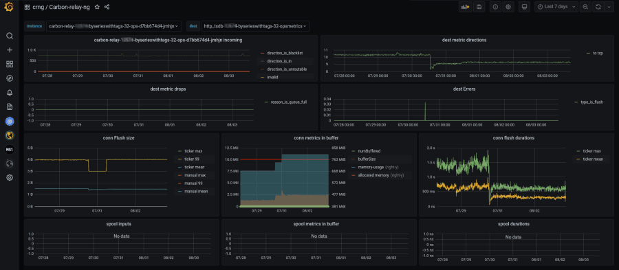

One final note: I would recommend importing the Carbon-relay-ng dashboard into your Grafana instance to see how carbon-relay-ng itself is performing.
