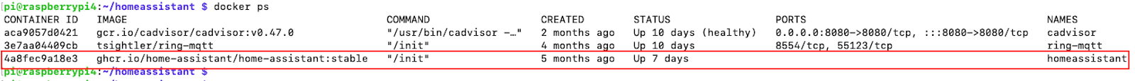

You can quickly verify the installation by looking for containers that are currently running.
A screenshot of currently running containers with a red outline highlighting the Home Assistant one highlighted.

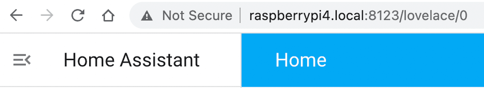

If they are running successfully, you can open up the Home Assistant home page by navigating to your Raspberry Pi’s IP address/URL followed by the Home Assistant’s port number (8123).
A screenshot of a Raspberry Pi's IP address/URL followed by the Home Assistant's port number.

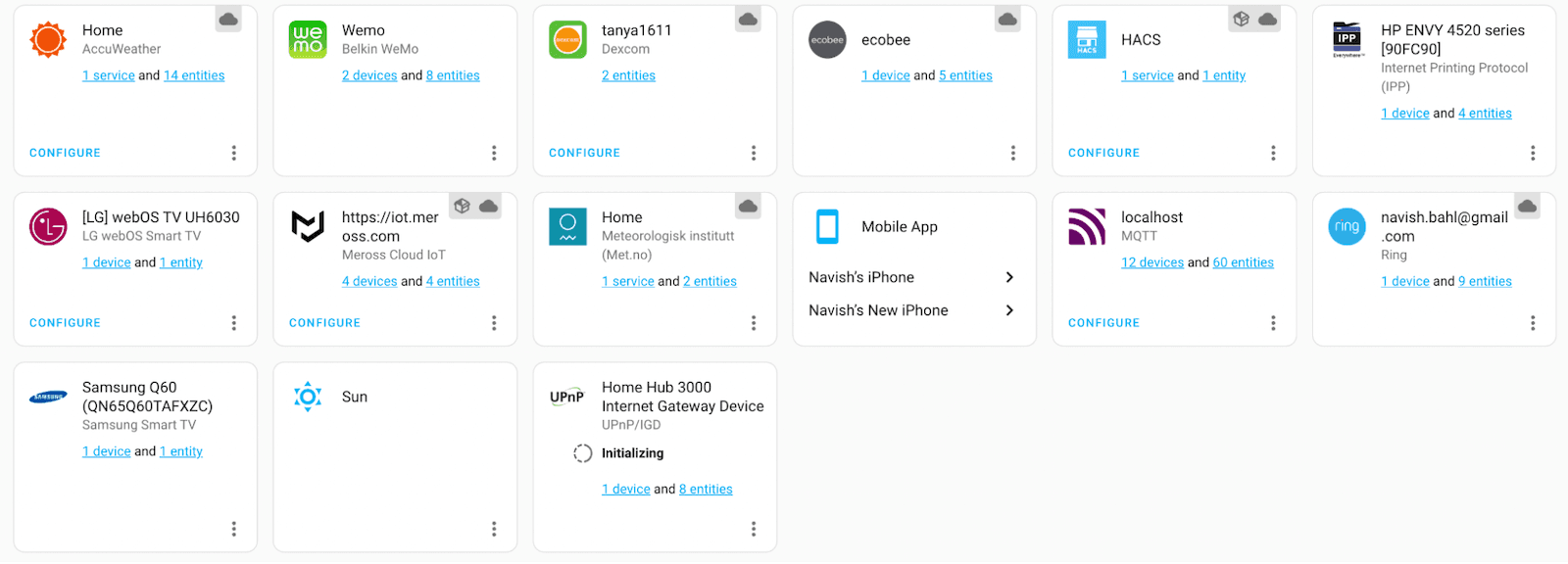

As soon as Home Assistant is up and running, it will automatically start discovering and identifying some of your smart devices (and not-so-smart devices 🙂) on the network. Mine automatically found my home router and my Samsung TV.
A screenshot showing two smart devices discovered on a home network.

Once you’re done, you should see most of your IoT devices show up in the Integrations (check the 12 devices and 60 entities listed in the MQTT tiles below) and the Overview HomeAssistant dashboard. Mine looked like this:
A screenshot of IoT devices in the Integrations and the Overview HomeAssistant dashboard.

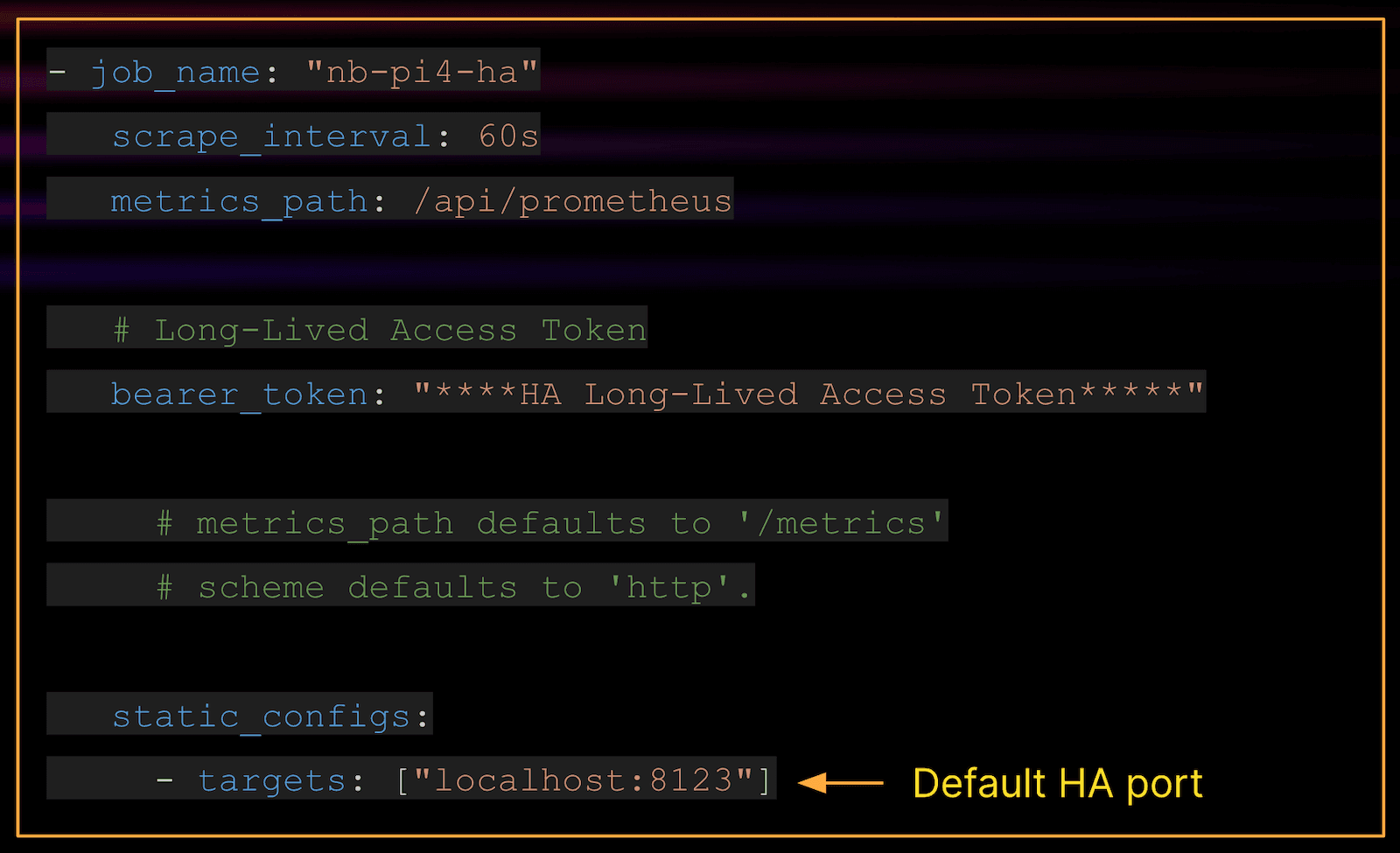

After that, configure your Prometheus server to scrape the Home Assistant metrics like this:
A screenshot showing how to configure a Prometheus server to scrape the Home Assistant metrics.

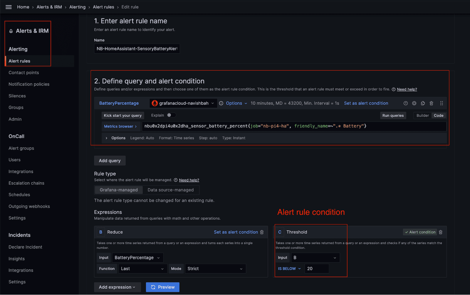

Grafana Alerting allows you to learn about problems in your systems moments after they occur. For example, I want to be alerted when one of my Ring home security sensors has a very low battery percentage (< 20%) so I can replace the batteries before they die. Creating a Grafana alert is very simple. Just follow these steps:

Create an alert rule, then navigate to the Alert rules section and click on the blue New alert rule button.
A screenshot of the Alert rules page in the Alerts & IRM settings.

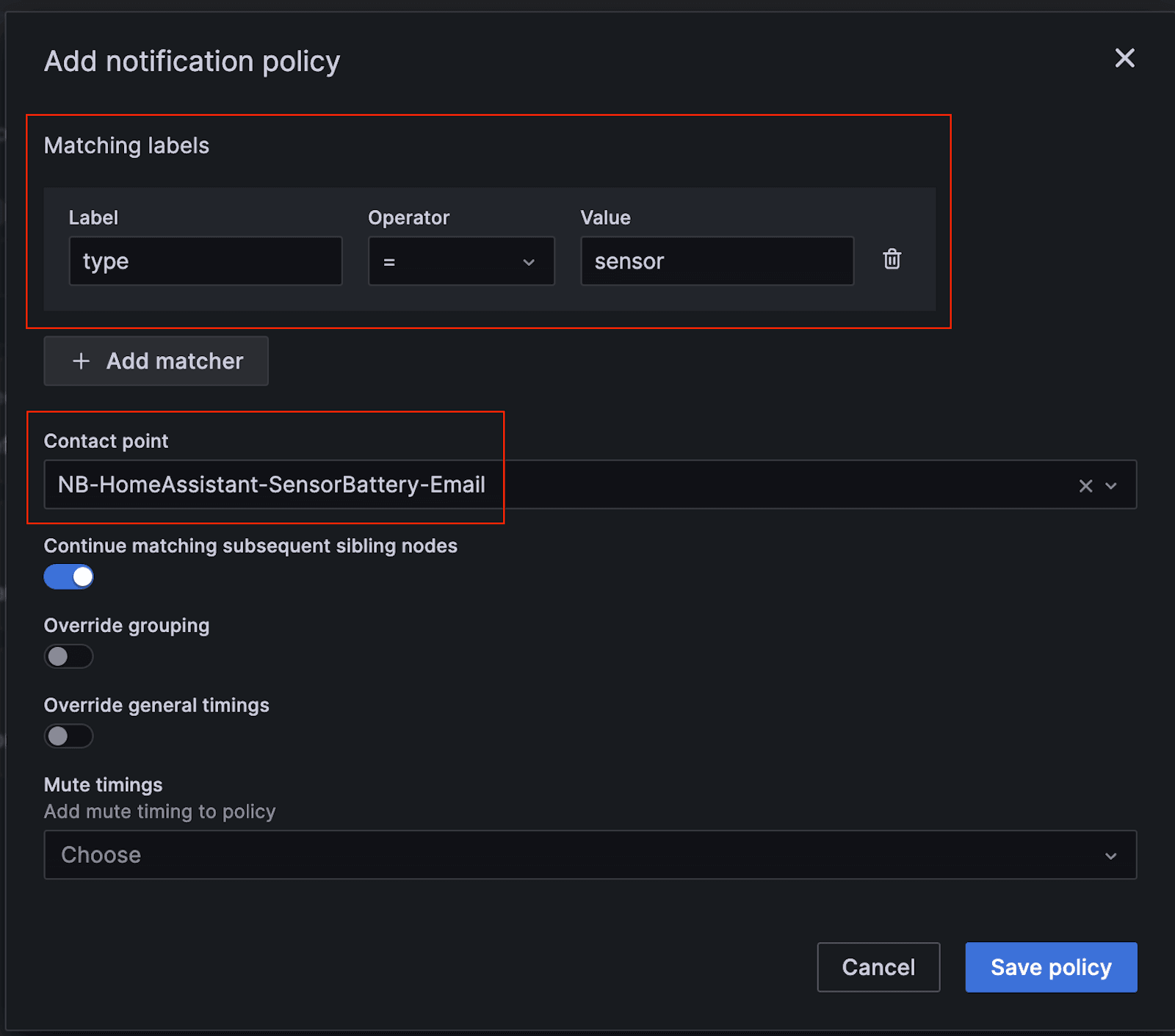

Finally, tie the alert rule with the corresponding action by setting up the notification policy.
A screenshot of the setting page for adding notification policies.
