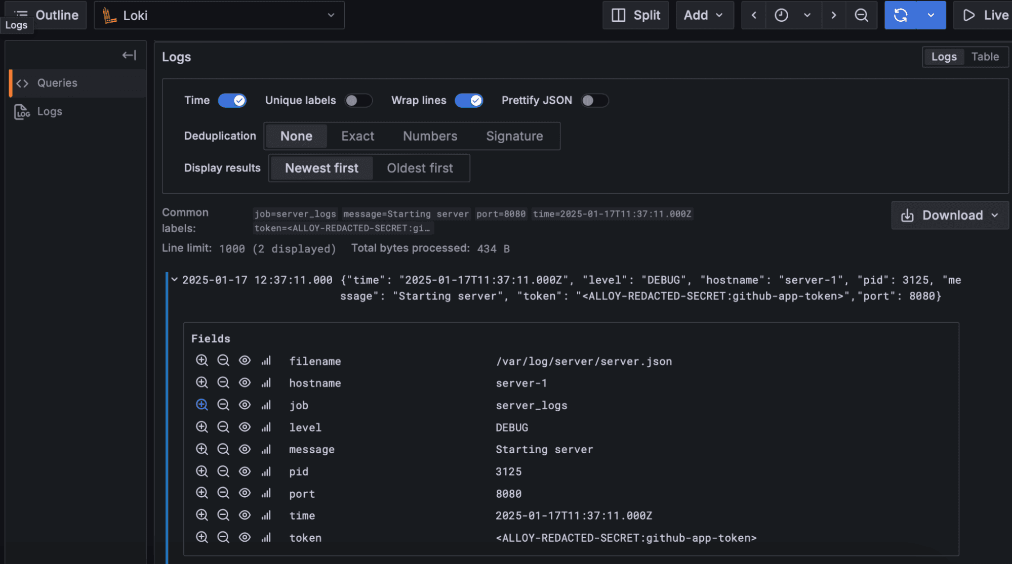

A secret redacted on ingestion

The redacted logs can then be forwarded into Loki, which you can query to look for the redaction string. This way, you’ll be able to detect secrets that would have leaked before the component was enabled, and potentially address the issue at the source (for instance, by disabling the debug mode of a given tool).

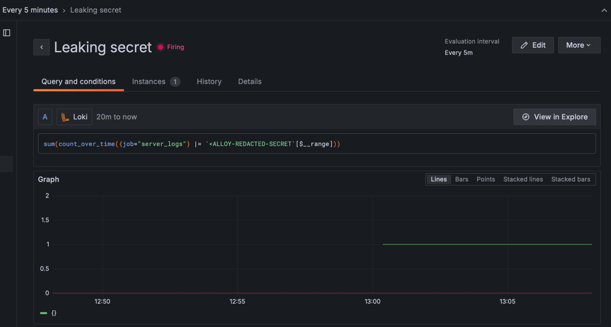

And there you have it! With this Alloy configuration in place, Grafana, Slack, and GitHub secrets that match the defined regexes will be redacted from log lines and replaced with a known string that can then be queried in Grafana. It’s even possible to create an alert to look for this redaction string in order to be informed when a leaking secret has been detected and redacted. This can be useful to detect secrets that were previously leaking without being redacted, so that they can be rotated.
An alert in Grafana detecting redacted secrets
