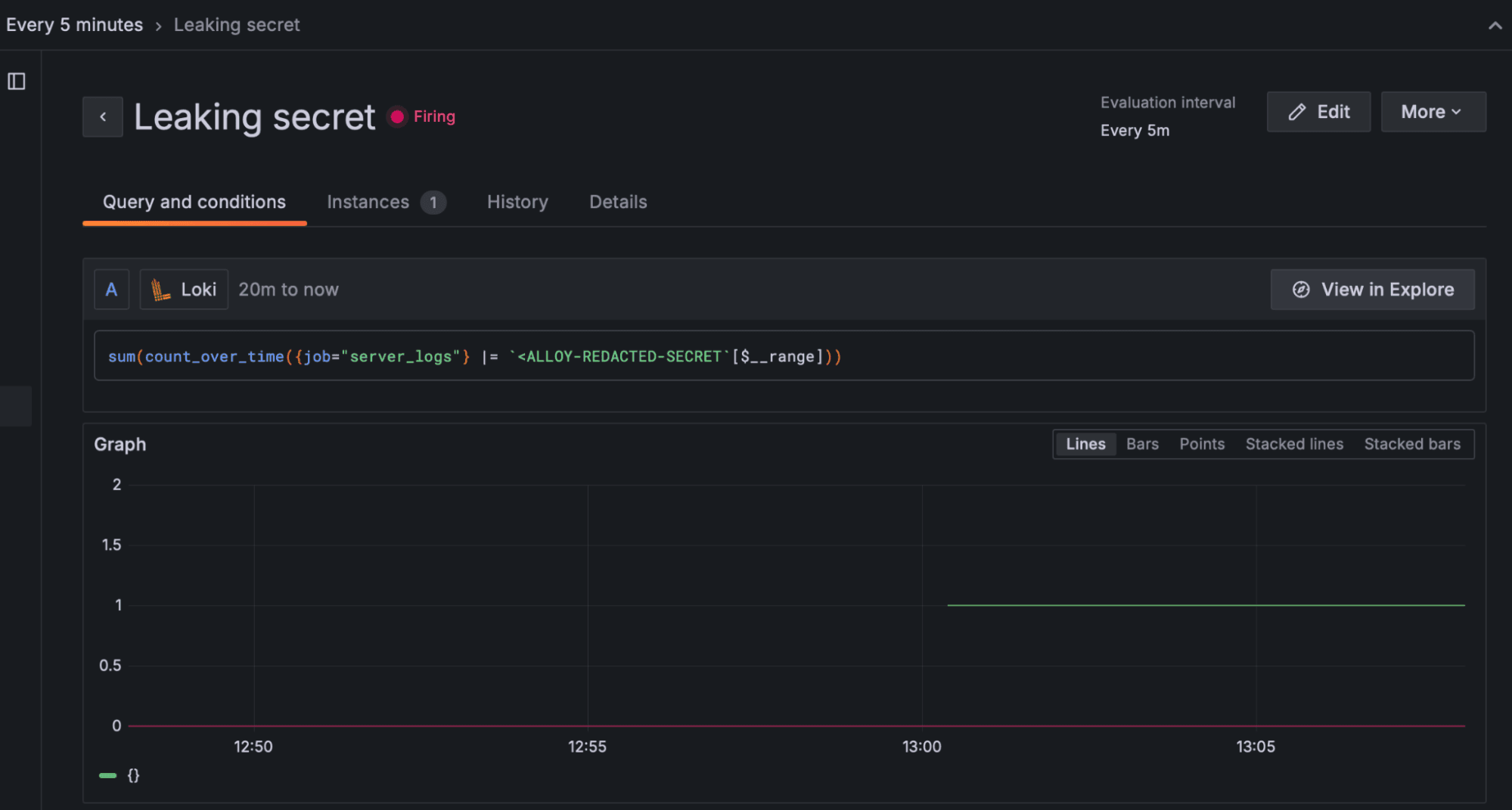

And there you have it! With this Alloy configuration in place, Grafana, Slack, and GitHub secrets that match the defined regexes will be redacted from log lines and replaced with a known string that can then be queried in Grafana. It’s even possible to create an alert to look for this redaction string in order to be informed when a leaking secret has been detected and redacted. This can be useful to detect secrets that were previously leaking without being redacted, so that they can be rotated.
