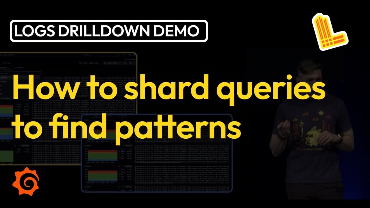

Shard your queries
Fetching data is an essential part of the Drilldown experience, and automatic stream sharding can really help get those results faster. Essentially, it splits a query into multiple individual queries that are run in sequence, which is particularly important when you're dealing with high volumes of data and you want to avoid rate limiting on a single string.
Once you enable automatic stream sharding, Drilldown asks Loki for the values of __stream_shard__ and, if returned, it groups them to execute the current query in smaller sequential segments . To get a quick look at how this works in practice, check out the clip below:

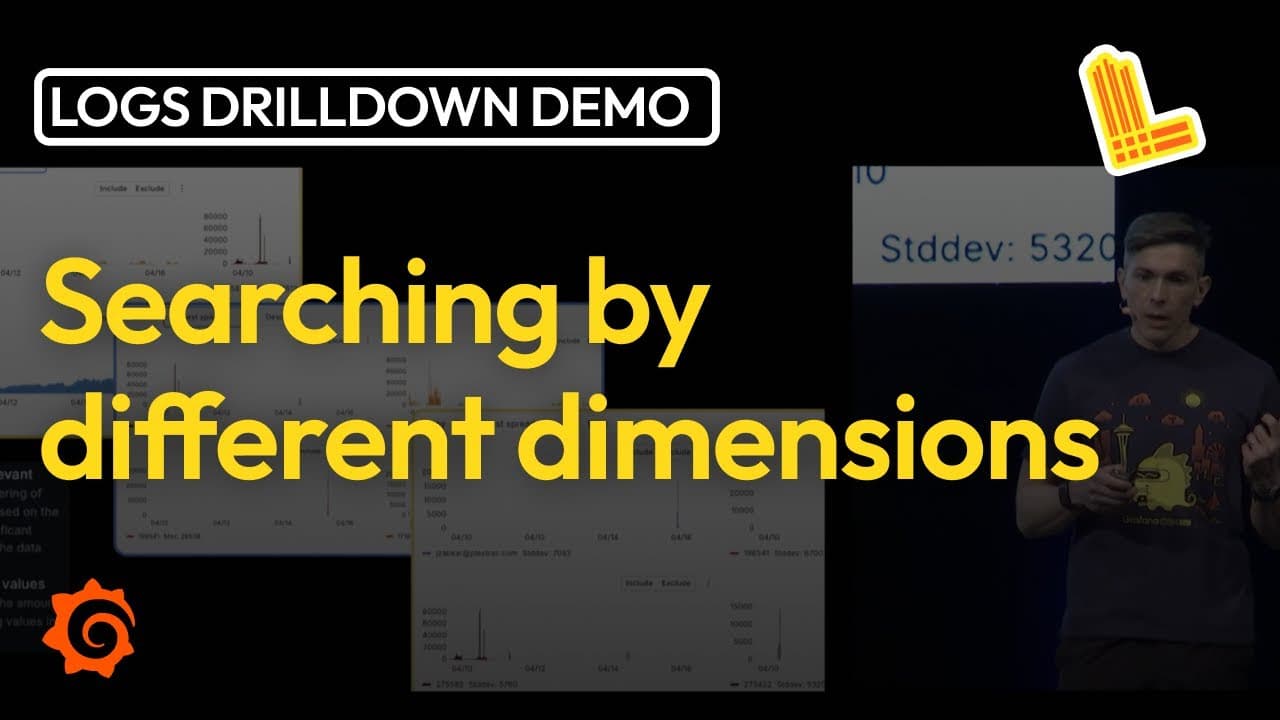

Customize your view
We want you to get insights from the Drilldown apps insights quickly, and that means giving you the most relevant information for your specific use case as soon as you open the app.
Originally, we focused on organizing the landing page by services. This was helpful for some users, but we needed to accommodate a wider range of users. So now you can start from any dimension that you'd like.
For example, you could set it up so your logs are filtered by a service label, or maybe by a service label and an error label—or really any combination of labels you can come up with that fits your needs. On top of that, you can use multiple values within a single label, which enables you to look at the logs of two different services at the same time.
In the next segment from our talk, you'll see how to do this in practice. Plus, we'll walk you through how you can add additional dimensions to your logs to give you more filters to drill down on.

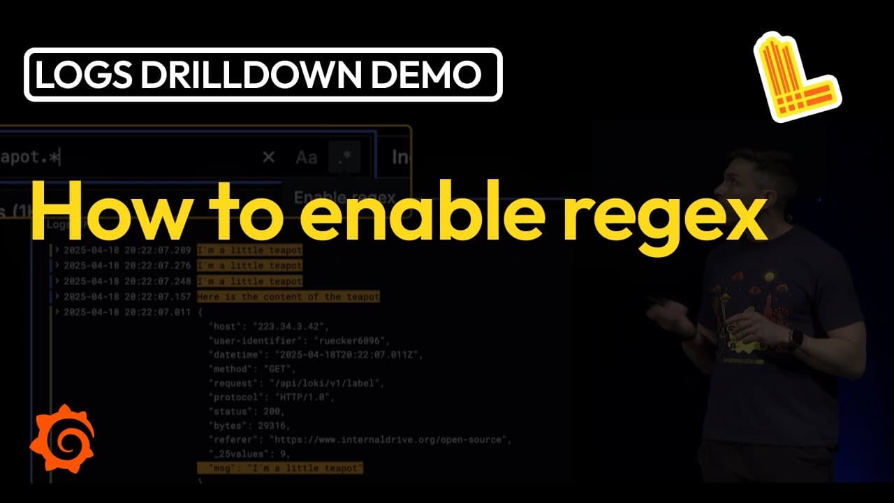

Enable regex support
Regular expressions, or regexes, are essential when searching across logs, and Logs Drilldown fully supports them! Drilldown includes panels called line filters, which is our way of searching for strings within your logs. Within those panels you can toggle on regex support, which you can use for all our filters, including labels and fields.
By enabling regex search mode, you're now able to build more complex queries that do more than simply match a certain string.
Check out this clip to see how you can do regex queries in Logs Drilldown. The video also includes a quick look at the time-based sorting feature we just discussed.

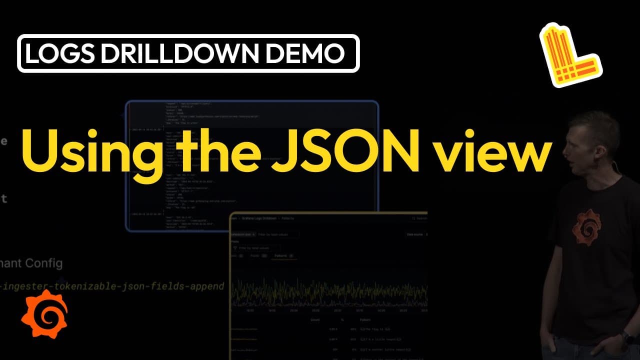

And now we've added a third, experimental view for JSON logs. No one enjoys looking for a field in a squished line of JSON, but with this new view you can see JSON the way it's meant to be seen. You can inspect any of the fields, add fields to your query to filter logs, and expand nested objects. And thanks to a small change in the Loki JSON parser that allows us to maintain the original jsonpath to each field, we’re now able to modify the query so that you see that same nested object across all your log lines!

Drilldown is great for quickly finding interesting patterns in your logs, but when we originally launched Drilldown, we couldn't do patterns for JSON. That's because JSON logs tend to be long and have a lot of structure to them, which created real issues with our tokenization for finding patterns.
To get around this, we've stopped trying to tokenize the whole JSON log line, and instead focused on unique fields that you can configure, which enables you to find patterns in those fields.
In the clip below, you'll see how to use Drilldown with JSON log lines.

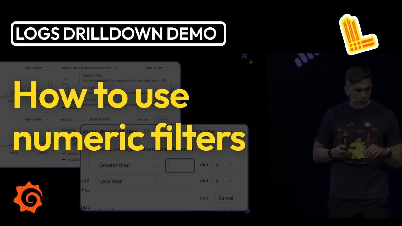

And finally, if your fields are numeric, such as duration or size, you can filter for different intervals when you're looking beyond a certain value. For example, when looking for a slow operation, you probably aren't looking for a discrete duration value but instead looking for all logs with a duration value above a certain threshold. This is exactly what comparison filtering enables!
In this final clip, you'll get a quick look at how you can use those numeric filters.
