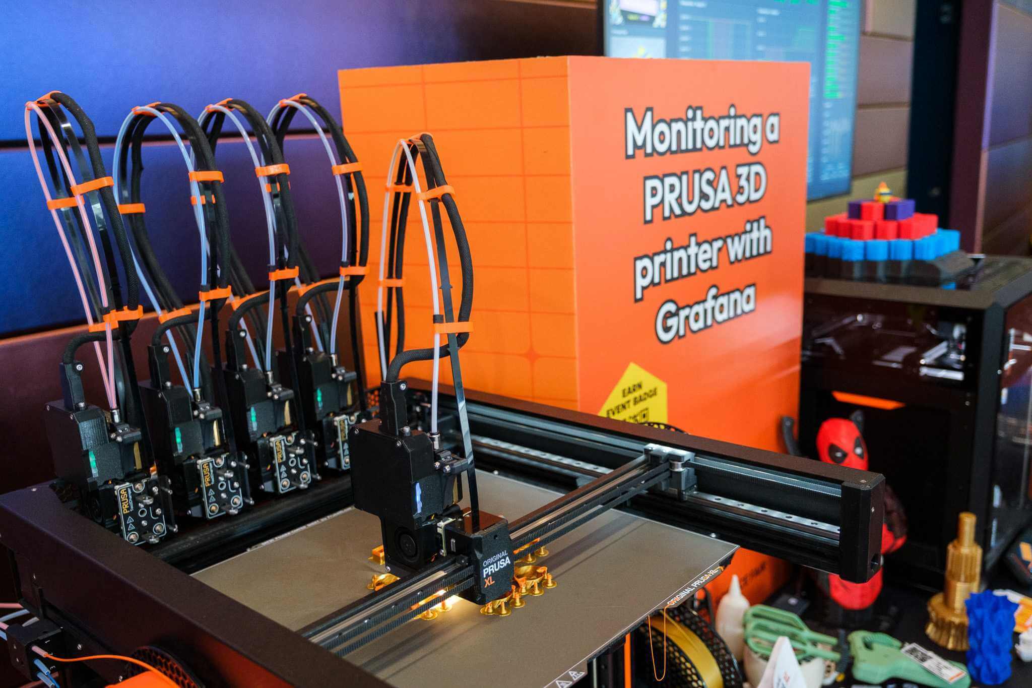

I enjoy it so much, in fact, that I even brought my setup to Seattle this week to be part of the GrafanaCON 2025 Science Fair.
Prusa printer setup at GrafanaCON

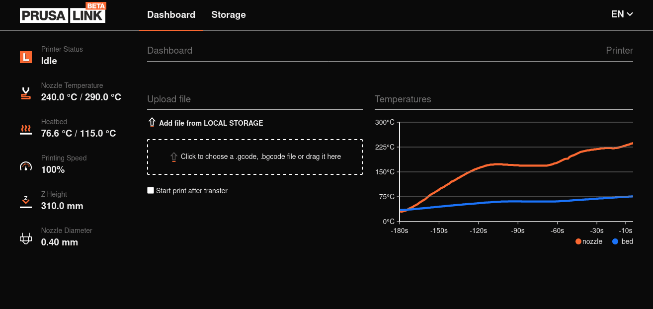

Prusa Link monitoring page
Okay, okay, we need to slow down and think rationally, right? With metrics and Grafana, you can do whatever you want. You can even create your own Prusa Link and control your 3D printer straight from Grafana. But in this case, you need to use a local Grafana instance or expose your printers to the world via your router, as the Prusa Link REST API is completely offline and it runs only in your network. And this API is where the story of prusa_exporter begins.

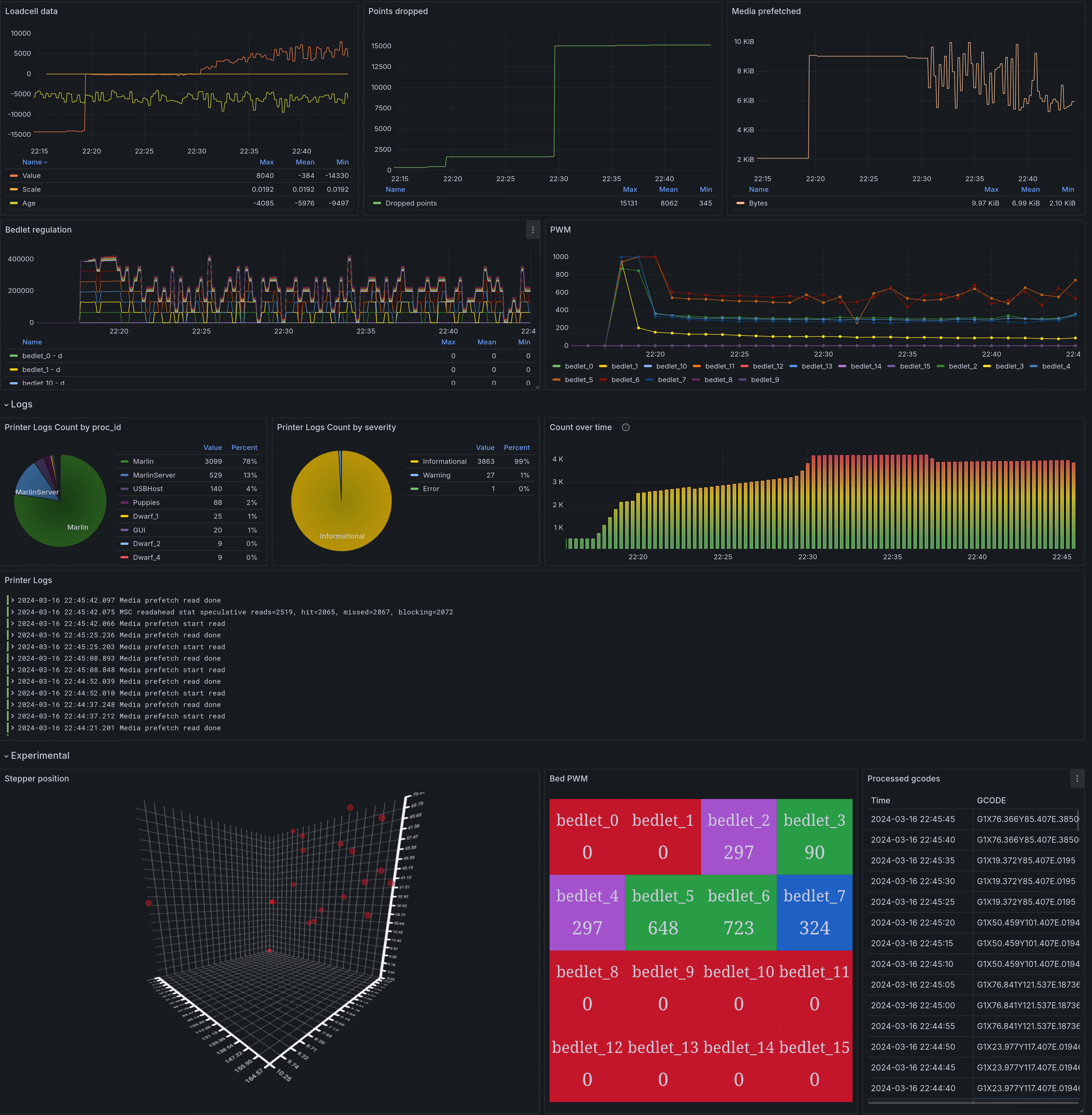

So basically, what we need to do is to offload this burden somewhere else. Just imagine you are sending 500 values of one metric to your server, and you need to process that. We have found that Prometheus is absolutely able to handle loads from several printers that are emitting such data. However, it’s much better not to send those metrics at all because if you are not a developer, they are not relevant.
For example, compare the difference between when load cell metrics are disabled:
And when they’re enabled:

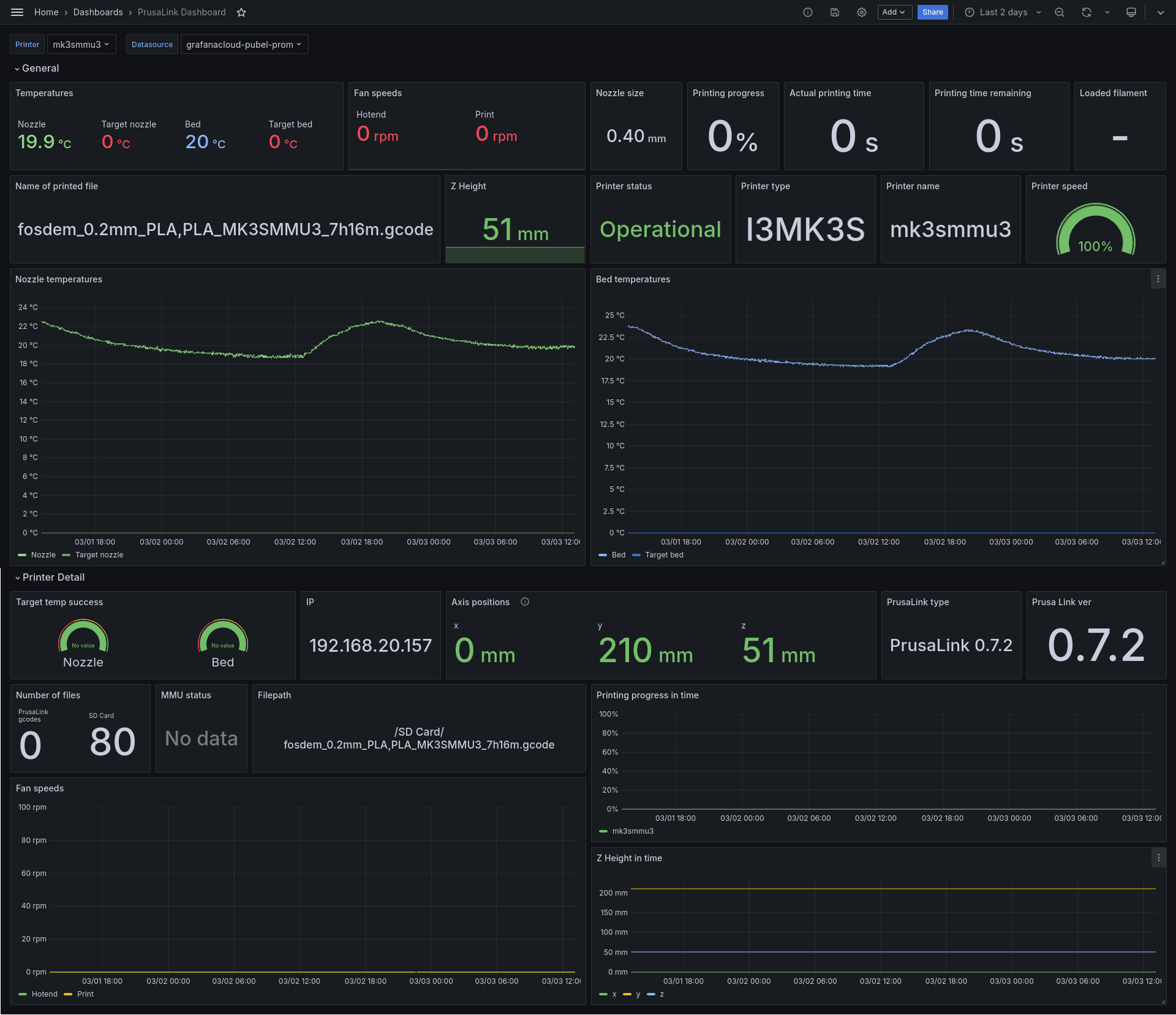

That’s why there are two types of approaches to solve this issue. If you want to go cheap and easy, you can just scrape the Prusa Link API, and you are good to go. You’ll get information about the actual job, how it’s progressing, the printed file image, temperatures, and many others. But what about the juice, like the load cell sensor data mentioned earlier?
Prusa Link dashboard in Grafana

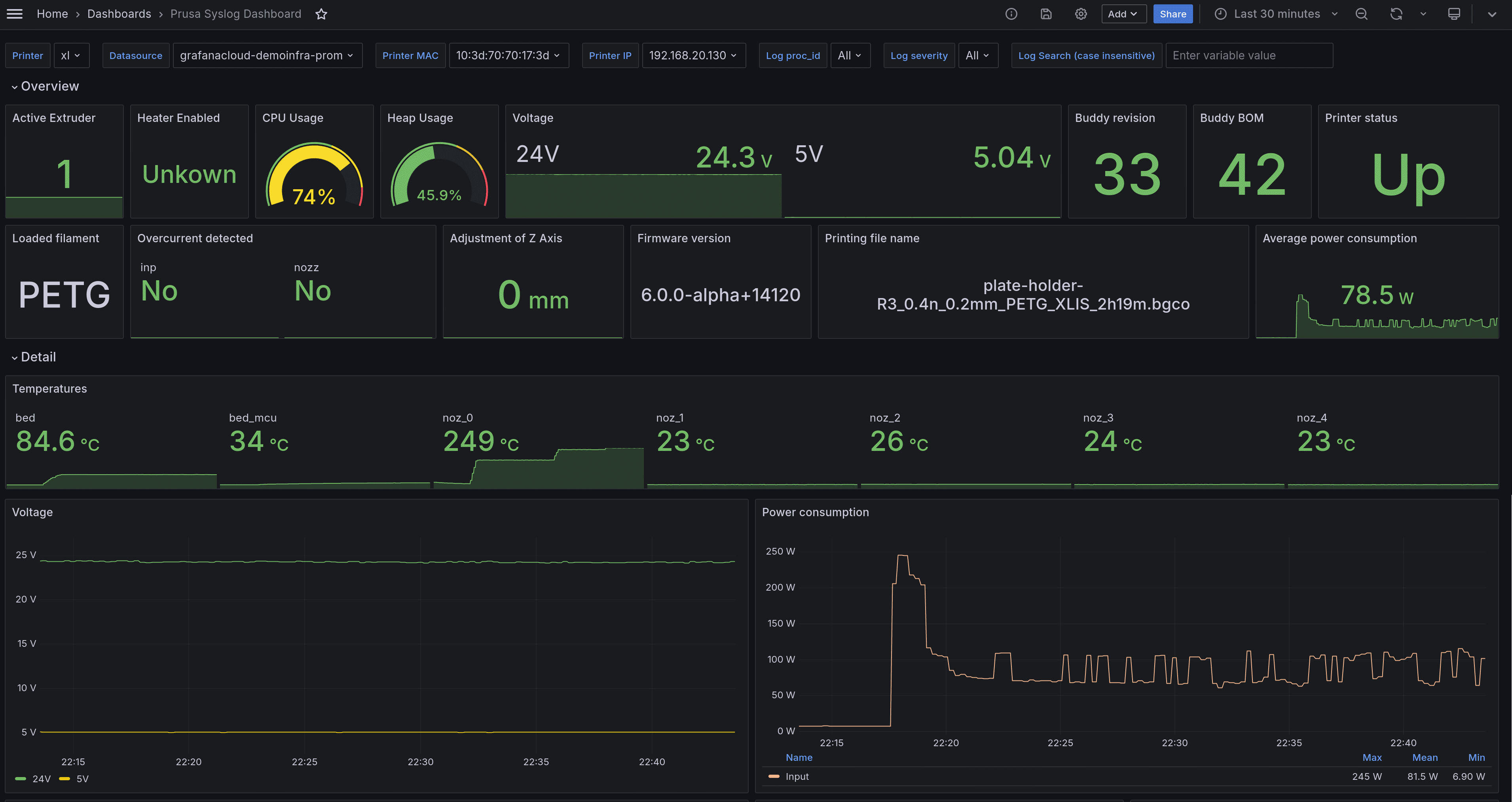

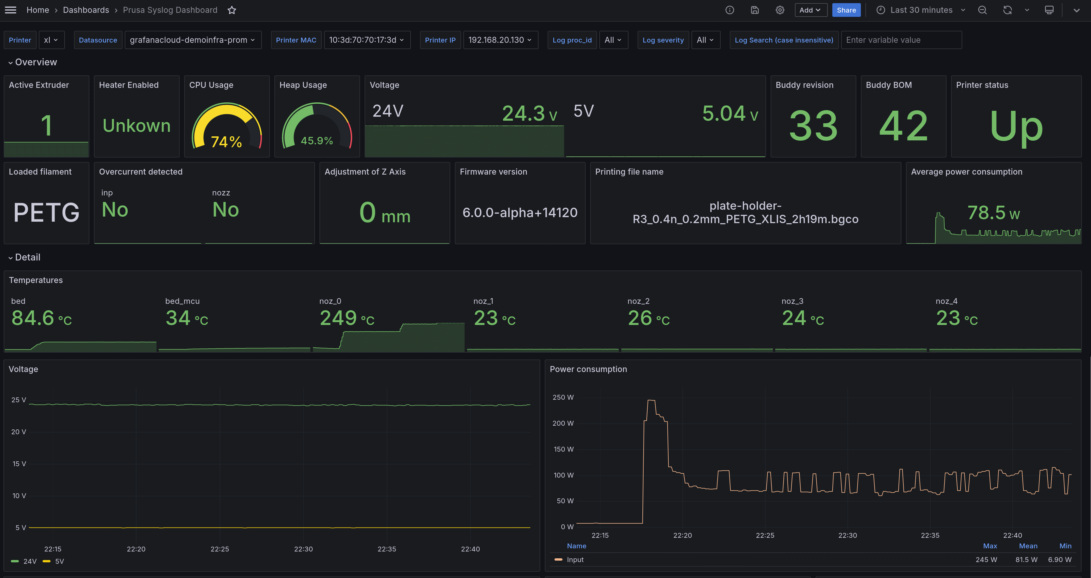

Prusa data displayed in a Grafana dashboard
Yes, it’s kind of cheating, but prusa_exporter is not meant for developers; it’s meant for hobbyists who like monitoring and observing. So I saved some of the processing power, and everything is nice and beautiful. Well, not so much at this moment, because we need one more component to translate line_protocol to Prometheus Remote Write. This is something that is going to be handled by the application itself, but for now, let’s use the influx2cortex proxy.
This proxy is able to accept line_protocol metrics and writes it into Cortex, which is a long-term storage solution for Prometheus. However, we are not going to use Cortex but Prometheus, and it’s very nice that those two have the same push protocol.

Prusa 3D printer data visualized in Grafana

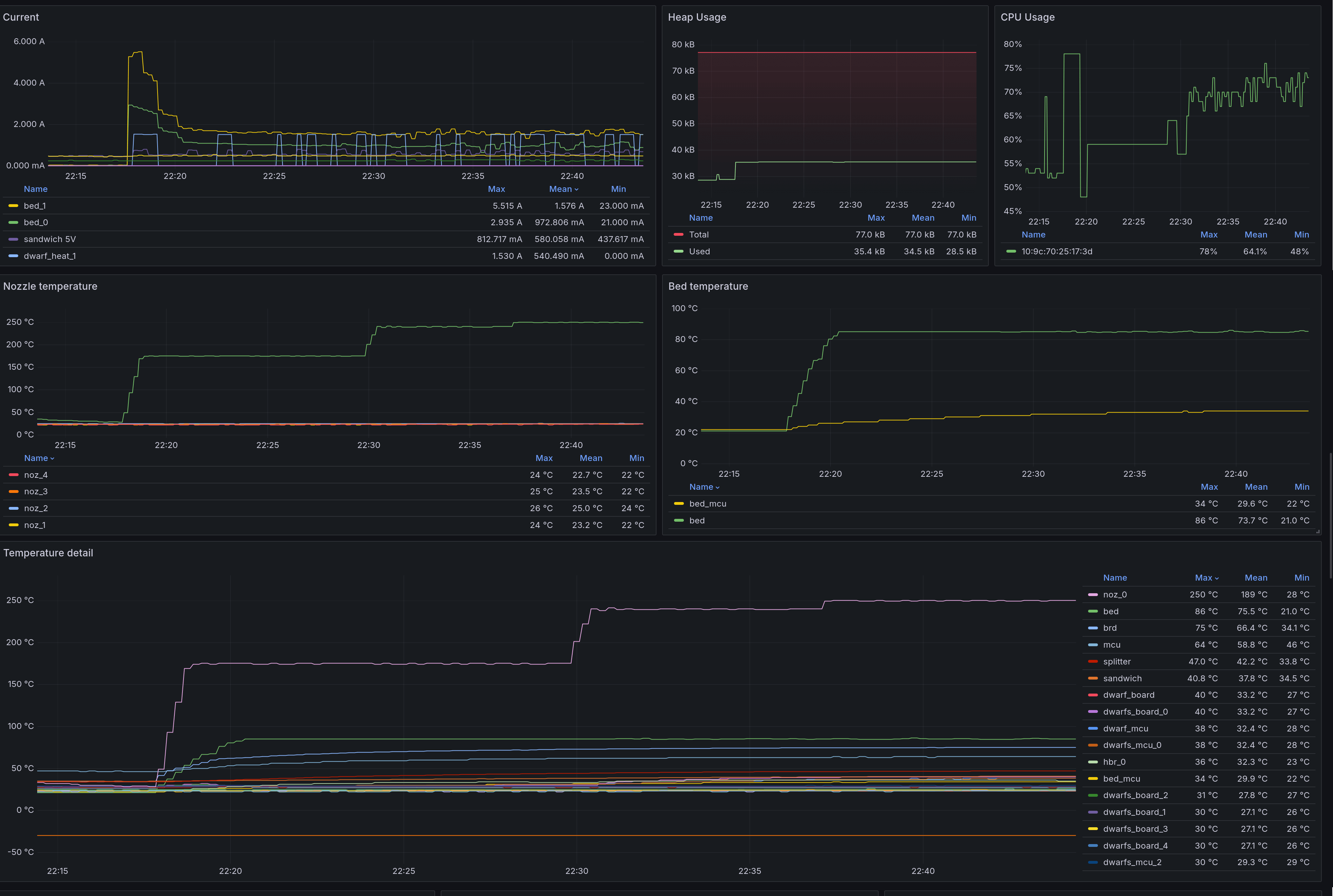

You can easily run the “ultimate” docker compose that is in the prusa_exporter repository, and it’s meant for running everything you need. Even though it’s a bit rough around the edges, it works pretty well, though it’s not optimized. For example you cannot run it on Raspberry Pi; you need something more powerful like some 4-core x86 CPU.
