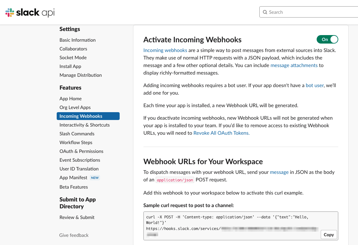

I needed a UI to send alerts and record the state of the kids’ rooms. I use Slack for corporate communication and I have a personal workspace that I already use for some other home automations. I thought this would work well as the primary UI for notifications and setting the state, since I have it open on my laptop most of the day.
I did some early research and found that it wasn’t too difficult to build an interactive Slack message using Block Kit. Later, I added some slash commands that call my endpoints to send events and retrieve statuses (more on that below).

When the boys click the buttons in the Slack message, this calls my webhook, which I’ll get into below.
The message is stored in a JSON object and can be sent from a number of different native SDKs. You have to be on a paid Slack plan to use some of them, but a basic curl command with a JSON object is free. I like the free services for my home automations, so that is the method I chose for sending the messages.

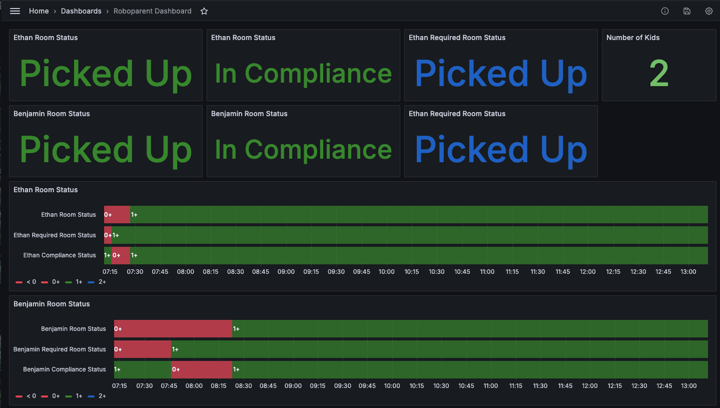

Visualizing the data in Grafana Cloud
My dashboard is quite simple, since my data is from one source and I don’t have to perform any calculations on the metrics.
%3Aquality(100)%2F&w=3840&q=75)
All the stat panels use value mappings to display colored text depending on the metric value.
I use a state diagram to visualize the room status, required room status, and room compliance status.

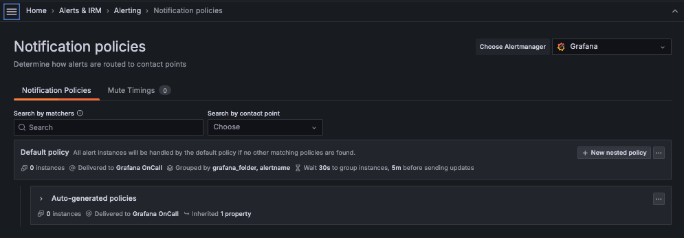

Generating alert notifications
I set up an alert rule for each of my kids. This alert rule runs a basic query on the ROBOPARENT_ROOM_COMPLIANCE metric using Benjamin as the label so that we return only Benjamin’s compliance metric. If the threshold is below 1 it means that his room is out of compliance, so I generate an alert. The following is an example of an alert rule for Benjamin:
I added a basic annotation that is included in the alert summary.
The default notification policy routes all alerts on my Grafana Cloud instance to Grafana OnCall.
