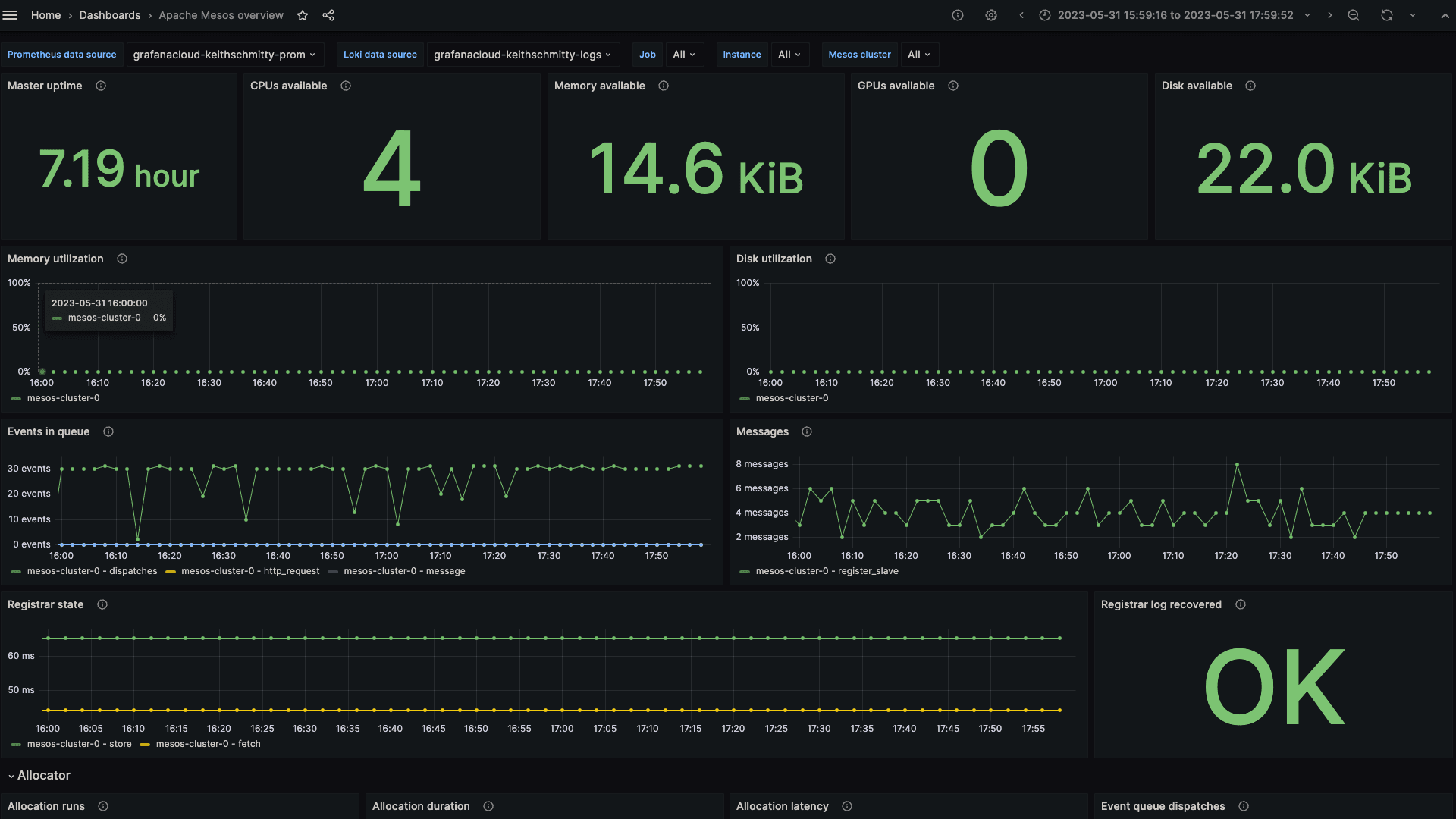

Apache Mesos overview dashboard
A screenshot of various Apache Mesos system cluster metrics in a Grafana Cloud dashboard.
The Apache Mesos overview dashboard provides you with an easily digestible high level view of one or all of your Mesos clusters. You can view the resources available to your clusters, relevant resource utilization for both master and agent, events and messages in queue, along with the registrar state. Additionally, several panels describe allocator runs, duration, latency and event queue status.
A subset of the key metrics used by the dashboard can be seen below, and the full list can be found within the Apache Mesos integration documentation:

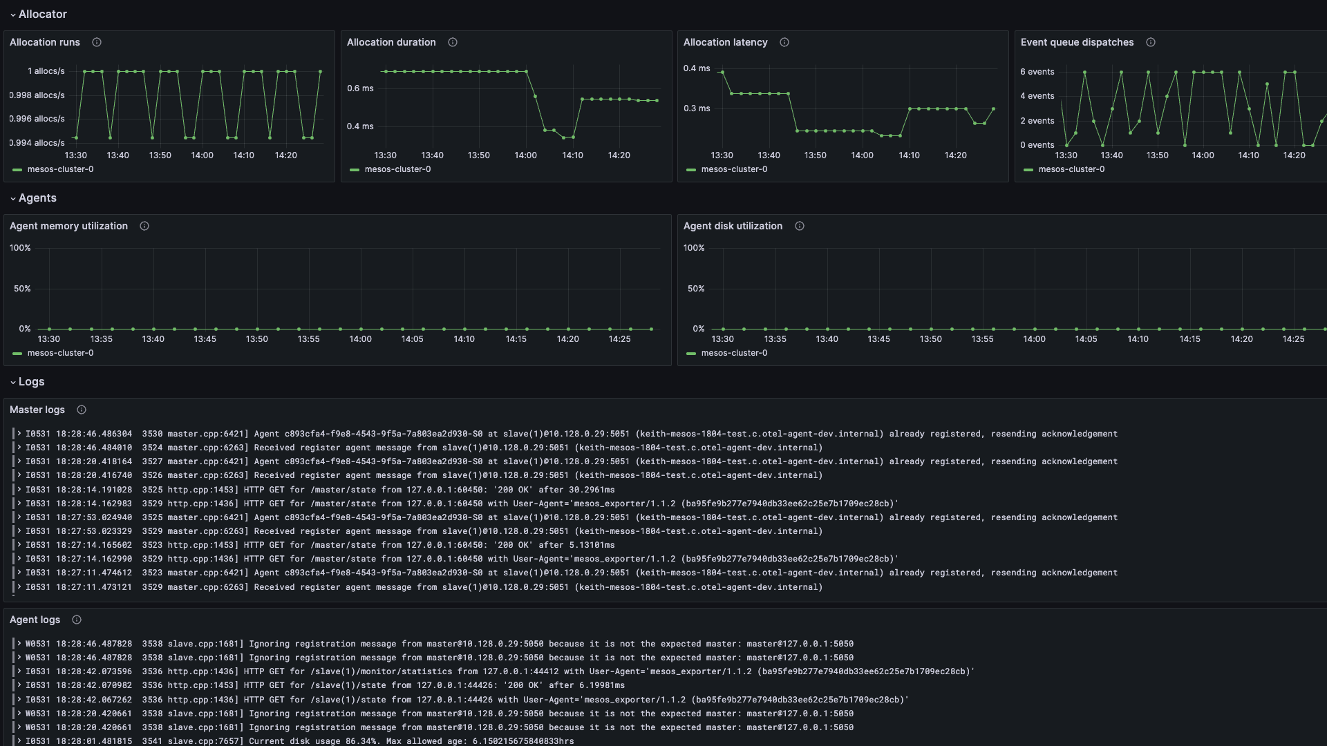

And finally, you can inspect both master and agent logs directly on the dashboard, as seen in the screenshot below:
Master and agent logs are displayed in panels in the same Grafana Cloud dashboard.
