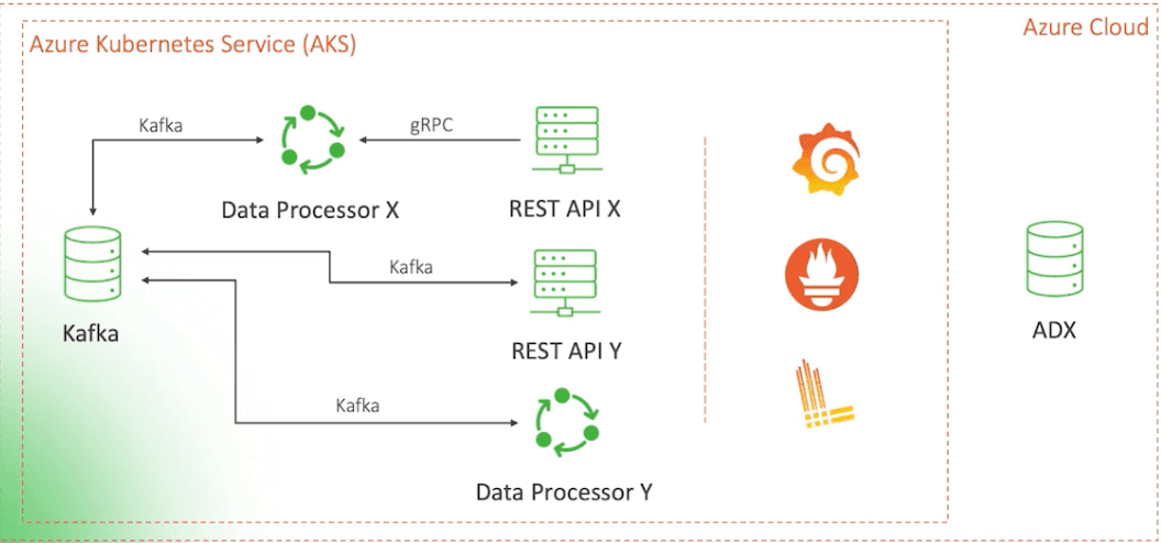

By building on Grafana Labs’ open source technology, Bestel and his team have created an observability stack that works seamlessly together and interfaces easily with other solutions. “We try to be as vendor-neutral as possible,” said Bestel. “We prefer solutions that integrate better with Grafana and are globally less expensive than what comes out of the box.”
Their architecture is built on Prometheus for metrics and Grafana Loki for logs, both of which are highly available with a 30-day retention period for data. Everything is then monitored via Grafana dashboards. “Grafana is the central piece that ties everything together with alerting and dashboards,” said Bestel.
Architecture diagram for Daimler Truck observability stack

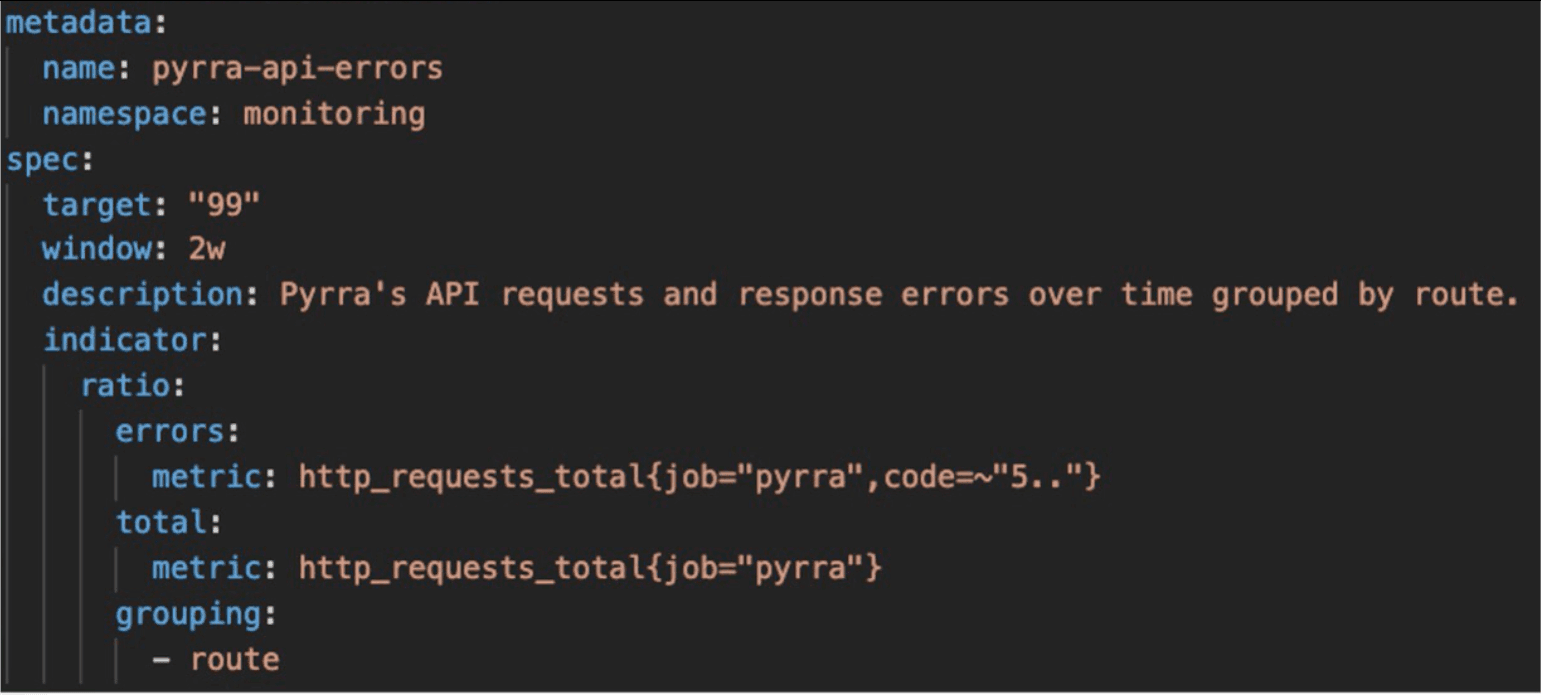

Bestel’s team utilizes Pyrra, an open source tool designed to track SLOs and that easily integrates with Grafana. To do this, they first manually defined each SLO as a custom resource in Kubernetes.
Kubernetes code snippet that defines an SLO for Daimler Truck
Once the custom resources were implemented, Pyrra reconciled them and automatically created Prometheus recording rules that represent the SLOs as well as generic rules for monitoring SLOs within Grafana. Prometheus executes the recording rules, and everything is fed into a set of Grafana dashboards that visualizes the data.

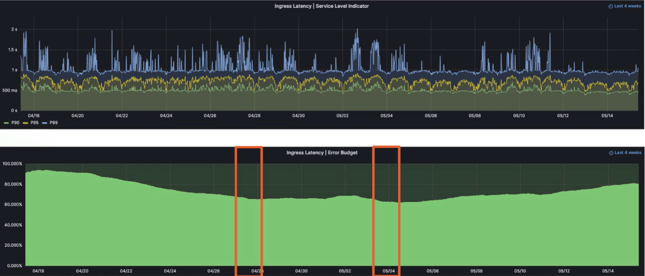

The tb.lx team safeguards their SLOs with careful monitoring, tweaking, and testing. Bestel’s team monitors availability, latency, and real timeliness of the data in their system via histograms, smart alerts, and error budget graphs in Grafana.
Grafana dashboards showing SLO for latency at Daimler Truck.
They tweak their SLOs by using standard thresholds where applicable, then make adjustments based on two questions: How does my product break, and how can I know that it broke? They also run end-to-end tests frequently, and maintain three separate Grafana instances in three different environments — development, staging, production — to do so.
