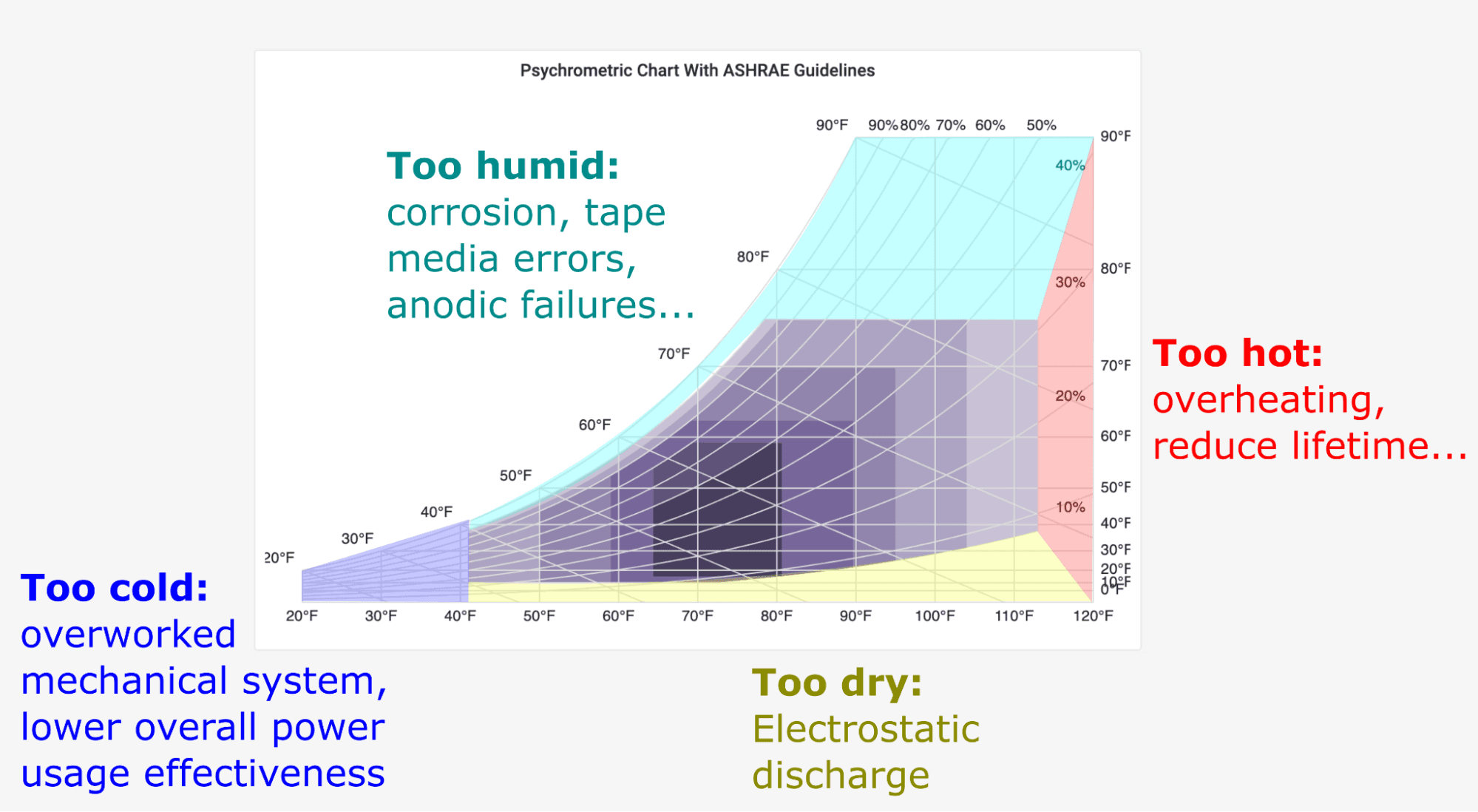

We use a collection of several programs, databases, power meters, and sensors to perform real-time analytics on our systems. This analysis is critical because any deviation outside certain air condition parameters can degrade our HPC system. For example, if the air is:
  • Too humid, it could lead to corrosion, tape media errors, anodic failures, and more
  • Too cold, it could lead to an overworked mechanical system and less effective power usage
  • Too dry, it could lead to electrostatic discharge
  • Too hot, it could lead to overheating and reduce the overall system lifetime

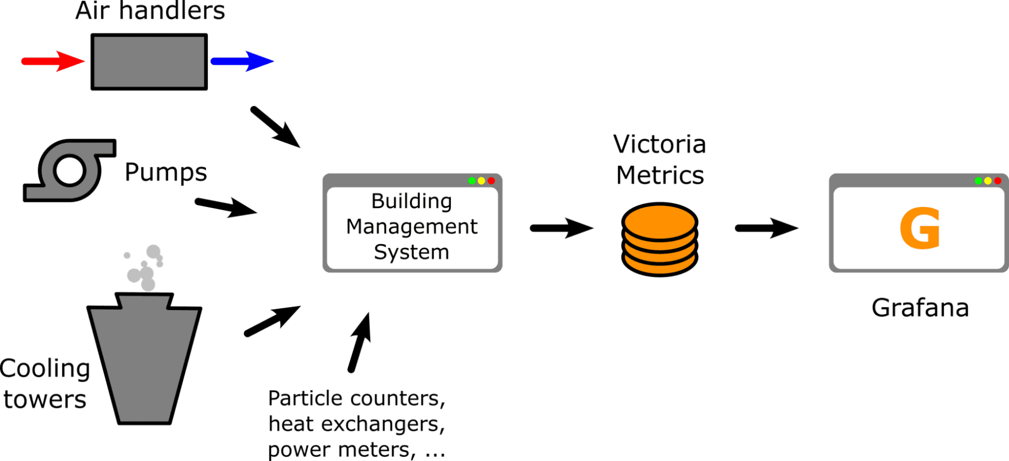

As a member of the building infrastructure group, I am particularly interested in the environmental data gathered in our building management software from temperature, humidity, and flow rate sensors on our mechanical equipment. Our data is published into a Prometheus-style database called VictoriaMetrics, which organizes the data by timestamp and makes it much easier to create complex queries in Grafana for visualization.
A flowchart describes the collection, organization, and display process at NERSC.

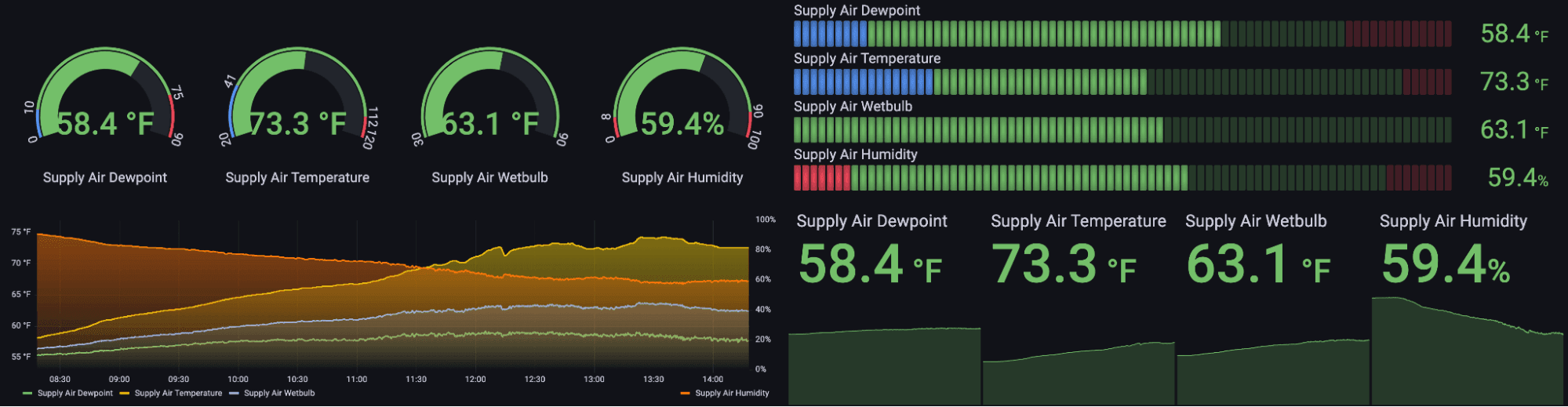

I helped put together several dashboards to visualize data from our mechanical cooling plant. The dashboard below demonstrates some of the data series captured by our air handlers. This information is critical because this air handler stack serves air into our air-cooled HPC auxiliary systems in the data center.
A Grafana dashboard displays NERSC's air handler data.
If temperatures go too high, for example, HPC equipment could run at lower efficiencies at best or get damaged at worst. Without these types of visualizations, it would be much more difficult to monitor air conditions in response to control program changes since our building management system has limited visualizations and stores much less data.

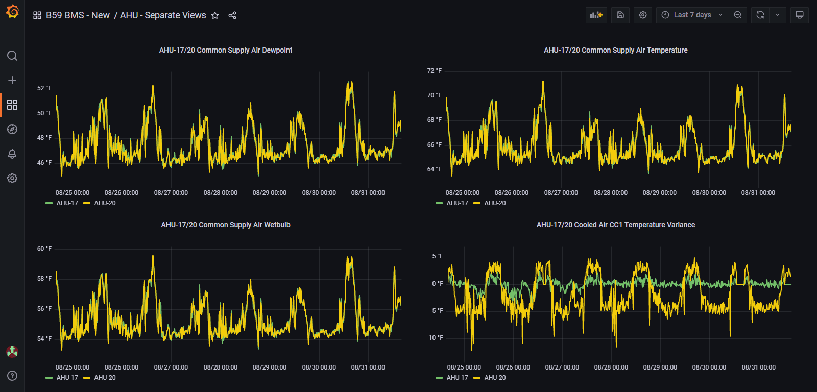

A Grafana dashboard displays dewpoint, temperature, and humidity data.
The chart above shows just some of Grafana’s many built-in ways to visualize all the relevant psychrometric data. While these visualizations are pleasing to look at, this Grafana dashboard can be overwhelming when trying to discern a single state.

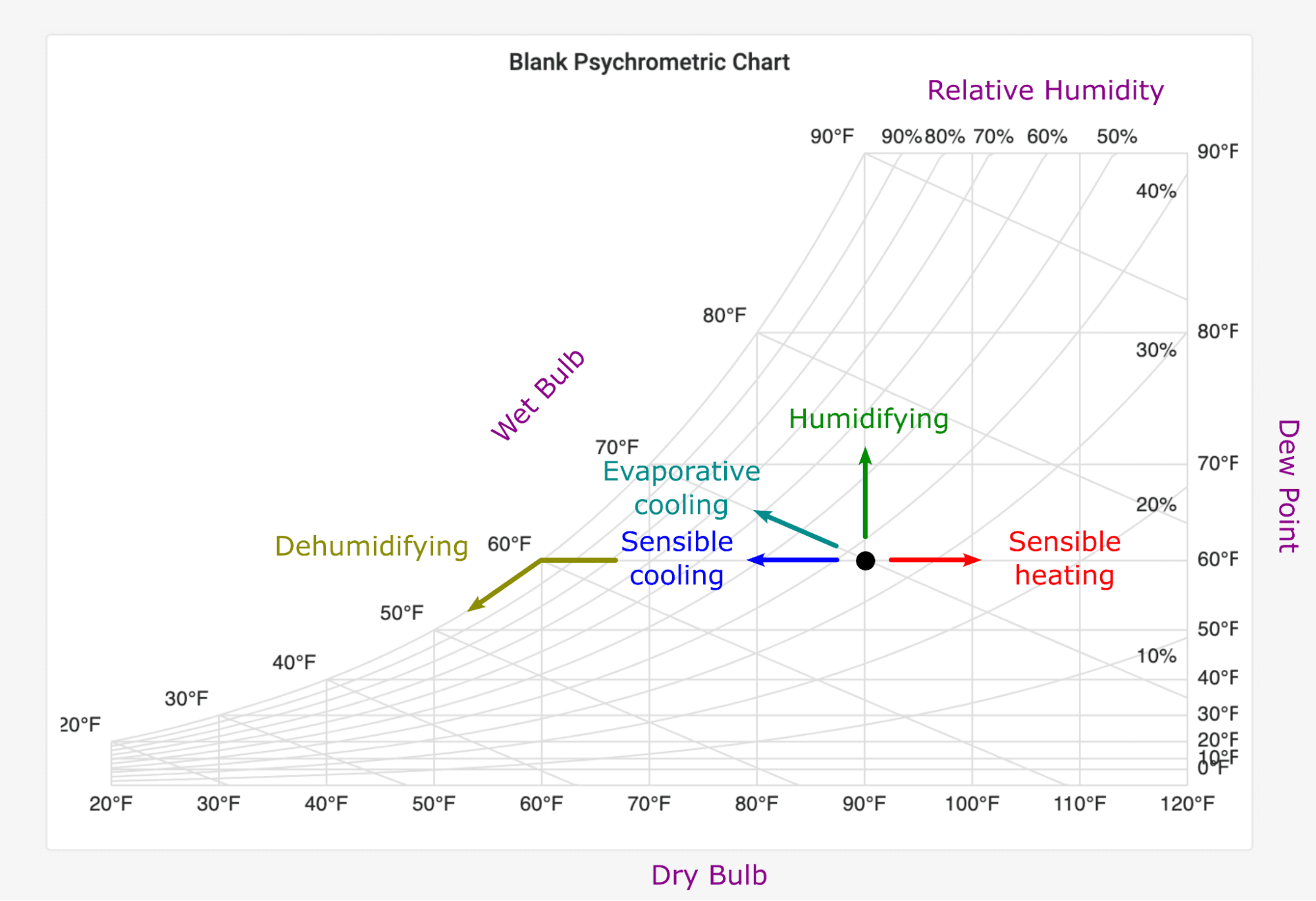

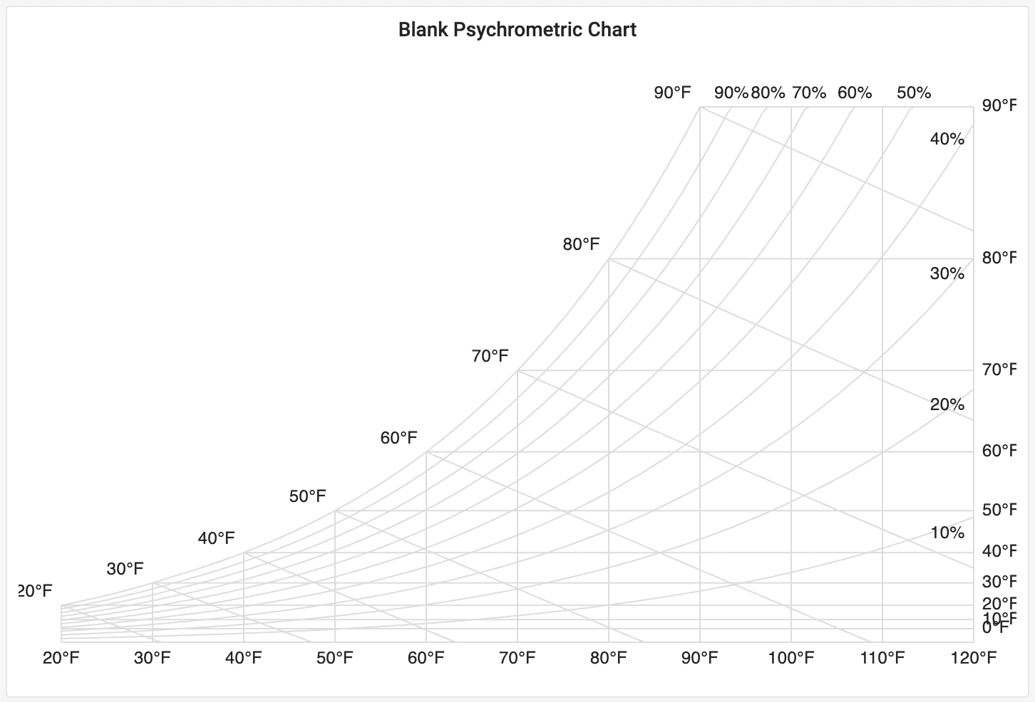

A Blank psychrometric chart, as generated by Psychart.

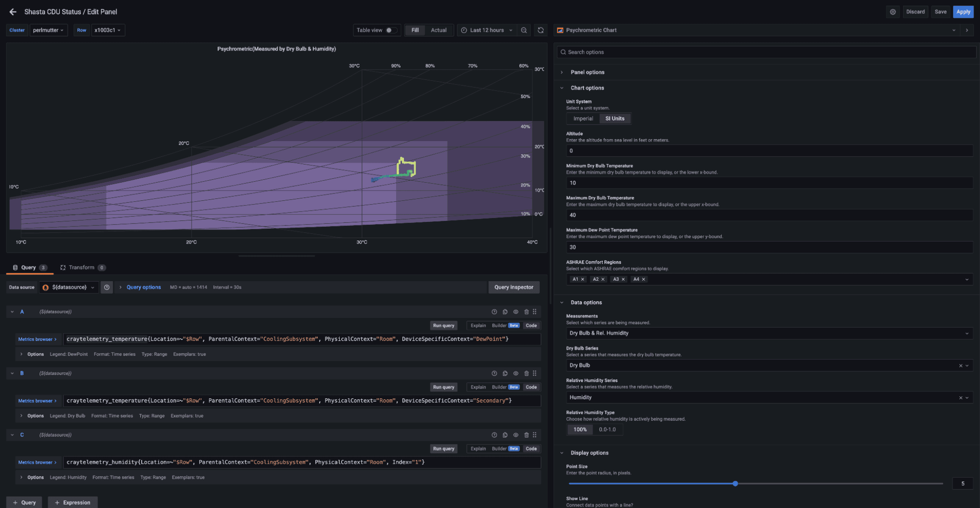

I built a project dubbed “Psychart,” which was intended to integrate a psychrometric chart in Grafana. I used the Grafana starter panel as a boilerplate for the project with a library called Psychrolib. With Psychrolib, I could calculate the entire state of air by just inputting any two state variables. I left the choice of which two variables to the discretion of the user.
A screenshot of the Psychart configuration options in Grafana.
Rendering the psychrometric chart was an interesting challenge. Prior to this project, a colleague tried to create one of these charts in Grafana using the SVG panel. But she found it difficult to render a variable number of states and perform calculations on each one to translate the state to an (x, y) coordinate. Another colleague created a functional offline program that could successfully render multiple points onto the graph, but it wasn’t connected to our network and didn’t offer the same versatility as Grafana panels.

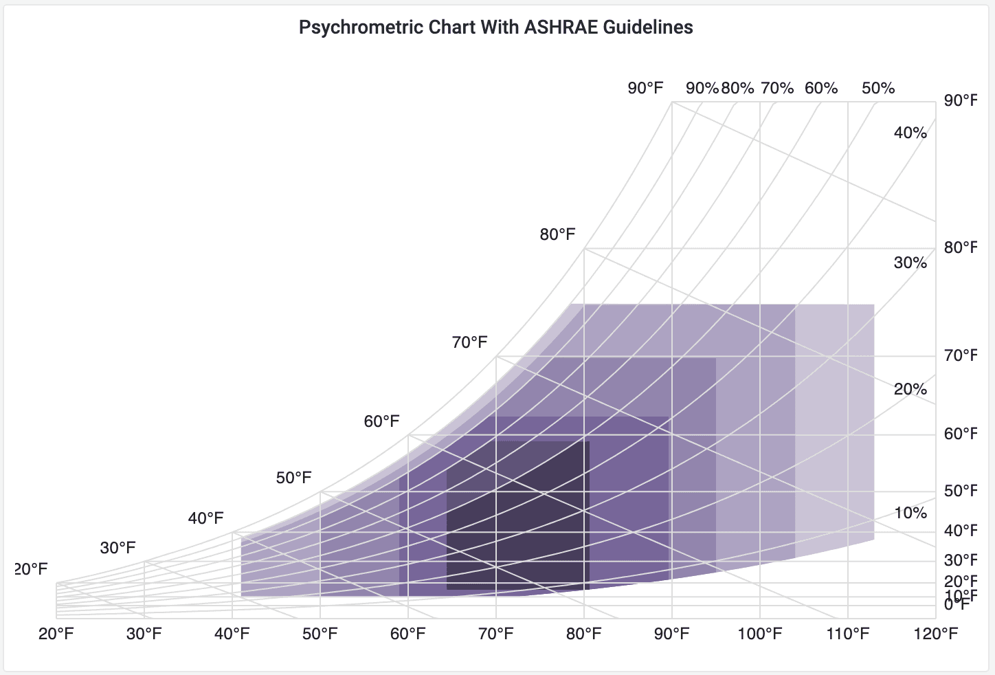

Knowing that Grafana had support for rendering SVG graphics, that was the route I chose for drawing the panel. I wrote a function that translated a general psychrometric state into an (x, y) point that was used to render the chart and all the incoming data. I embedded the ASHRAE guidelines for air-cooled data centers to allow the user to optionally overlay recommended targets for supply air. There are multiple sets of guidelines for different types of data centers that are shown in the image below.
A screenshot of a Psychrometric chart with ASHRAE guidelines.
The image below breaks down why this visualization is so important for operators and engineers.
A psychrometric chart displays the impacts of going outside ASHRAE guidelines.
The psychrometric chart also makes it easier to explain different air conditioning operations.
A psychrometric chart shows the impacts of various air conditioning operations.

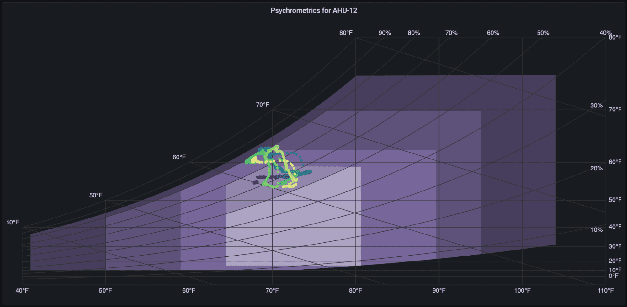

As you can see from the dashboard below, Psychart worked great for monitoring our air handler supply air.
A visual display of air handler psychrometrics.

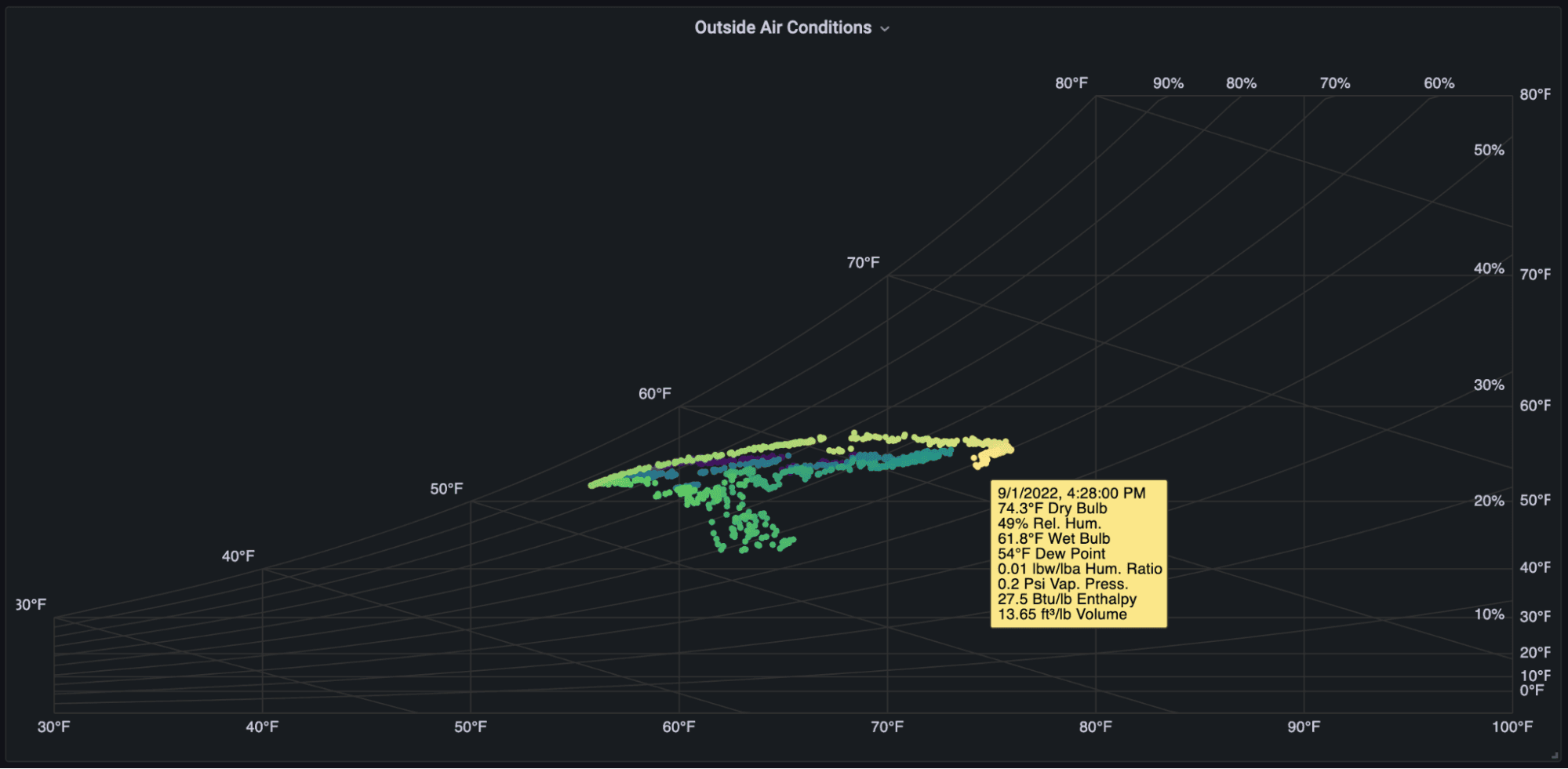

And Psychart can be applied to other use cases, such as monitoring chemical processes or atmospheric conditions. At NERSC we are also observing outdoor air conditions with Psychart, which gives us insight into whether it’s safe to operate entirely on outside air or if the air needs to be conditioned first.
Psychart displays outside air conditions captured by air handlers at NERSC.
