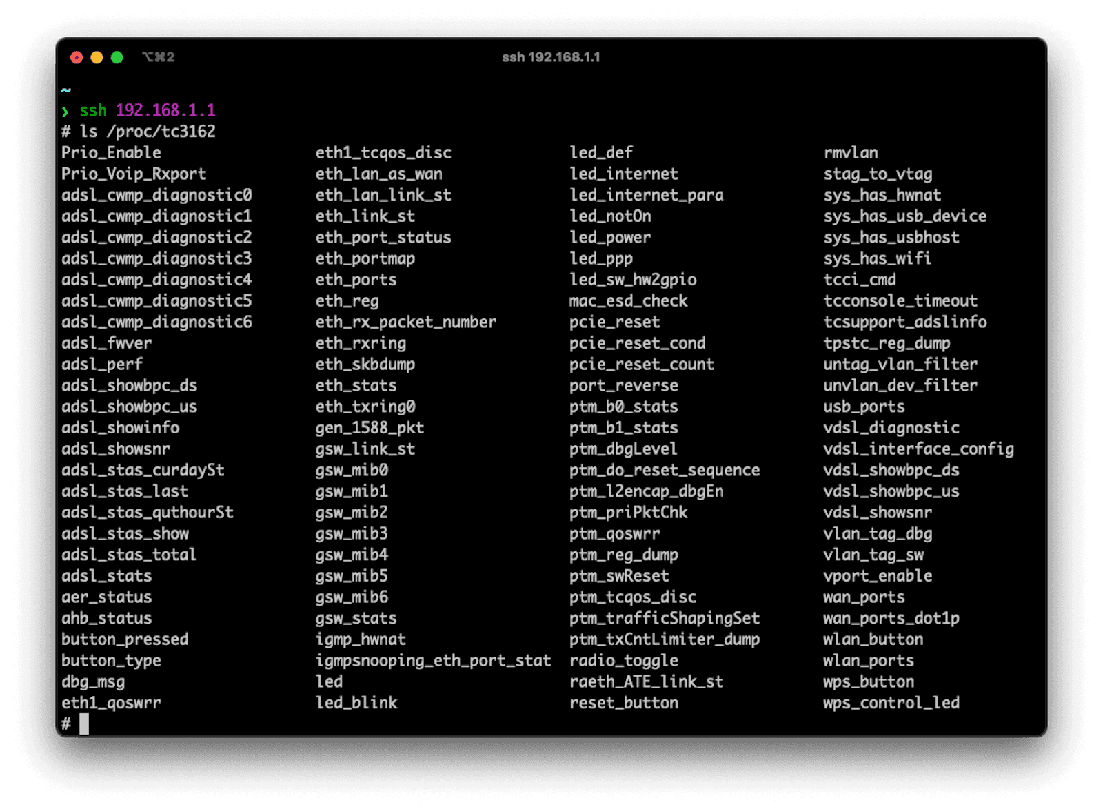

Just wow! Spectrum was actually a simple daemon and a wrapper for $ /proc/tc3162/* commands. What is tc3162? TC3162 is TrendChip’s ADSL2/2+ SoC processor, a highly integrated solution for the ADSL broadband access gateway. At this point, I can’t wait to execute ls under /proc/tc3162 to find out what kind of gold I can extract. Here are some configurations and values that chip exposes onto the kernel:
A screenshot showing exposed configurations and values
This is the pseudo-filesystem of the TC3162 firmware that we can read and then extract the metrics. Notice that these files are not executables. However, since I’m unfamiliar with internals, I think the TC3162 chip executes some commands and writes results as outputs under this directory.
Are you thinking what I was thinking? Let’s scrape them!

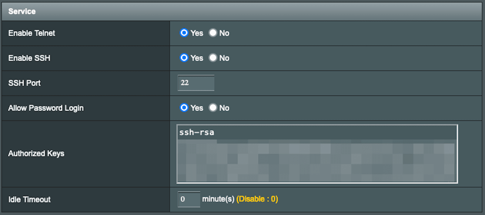

Enabling SSH on the modem
To do this, you must have an xDSL modem that is set up correctly and running. Additionally, you should generate a new SSH key-pair using ssh-keygen for passwordless login:
$ ssh-keygen -t rsa -f ~/.ssh/id_rsa_modem -q -N ‘’
Copy your public key and put it into Authorized Keys in the modem settings:
$ cat ~/.ssh/id_rsa_modem.pub
A screenshot showing where to paste a public key into Authorized Keys in a modem's settings.
Also, don’t forget to set Idle Timeout to 0 since go-dsl does not support a reconnecting feature yet.

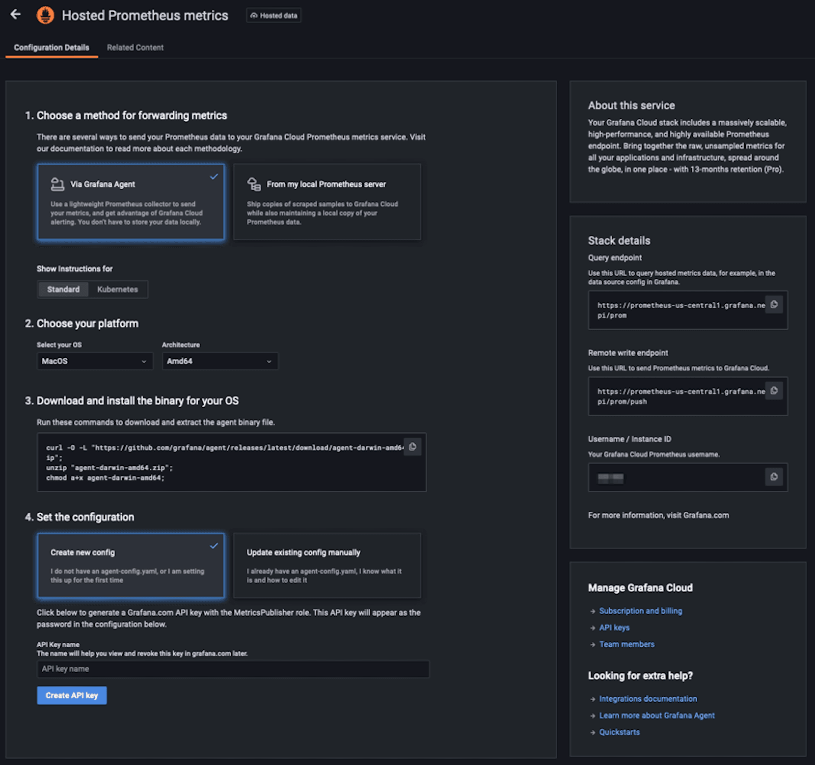

Preparing your Grafana Cloud account
If you don’t already have a Grafana Cloud account, you’ll need to sign up for one then set it up by following the instructions.
Another important step is to create a Prometheus instance on Grafana Cloud. Find the Integrations and Connections tab on the left bar, and jump into Hosted Prometheus metrics service. Make sure you have selected Via Grafana Agent as a forwarding method.
A screenshot of the Hosted Prometheus metrics configuration window.
Generate your API key and store that somewhere secure. Also, copy the Remote write endpoint since you’ll use it later.
After you choose your platform, you can download the Grafana Agent binary from there. Also, don’t forget to give a star for grafana/agent on GitHub!

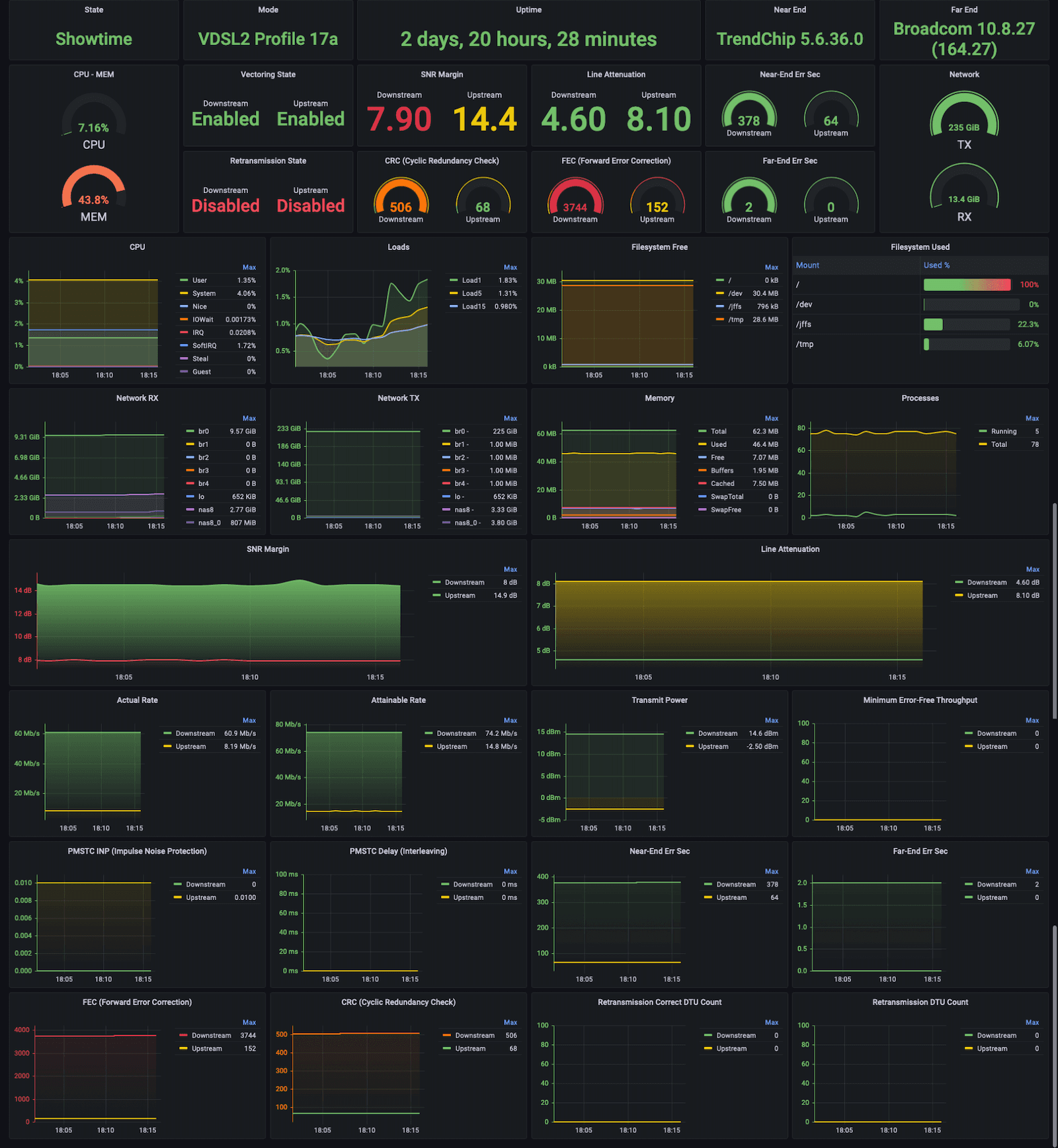

Creating an xDSL Exporter dashboard on Grafana Cloud
To create a new dashboard, go to: https://USERNAME.grafana.net/dashboards. Click New and select Import. Download the JSON file here and import it to the dashboard.
Time to lift off! Open your xDSL dashboard and you should see something like this:
A Grafana dashboard showing metrics from an xDSL modem.
If you’re somewhat familiar with xDSL terminology, I can already see the smile on your face! Some of the most important values are SNR Margin, Line Attenuation, and packet drops (CRC, FEC). Visualizing everything together is really useful.

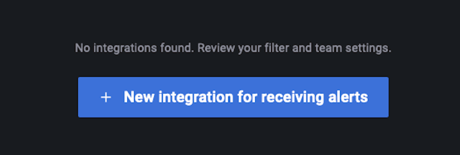

On the left bar of the dashboard, click the Grafana OnCall icon. Then jump to the Integration page to define new integration.
A screenshot of a button to create a new integration for receiving alerts in Grafana OnCall.

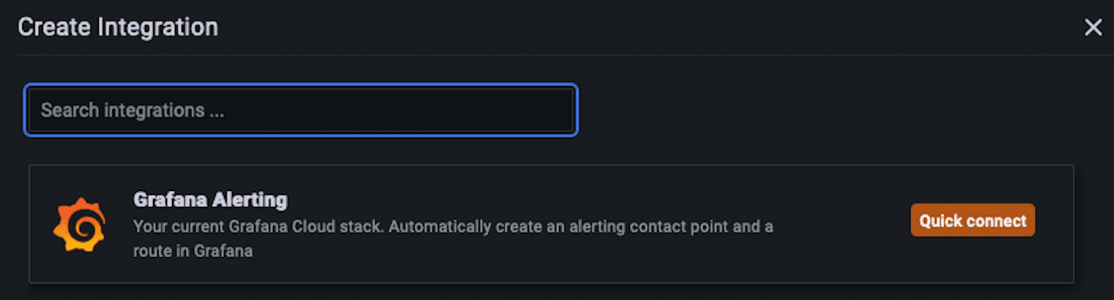

You should configure the Grafana Alerting integration in this step. Then, click the New integration for receiving alerts button to open the Create Integration page.
A screenshot of the Create Integration window in Grafana OnCall.
After a few seconds, a popup will appear on the right side. Note that webhook URL for later use. Read the description and click the Open Escalations Settings button.

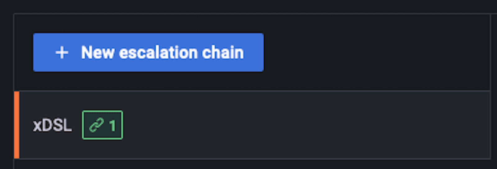

Use the tab to create an New escalation chain. I named mine “xDSL.”
A screenshot of a button for a new escalation chain in Grafana OnCall.

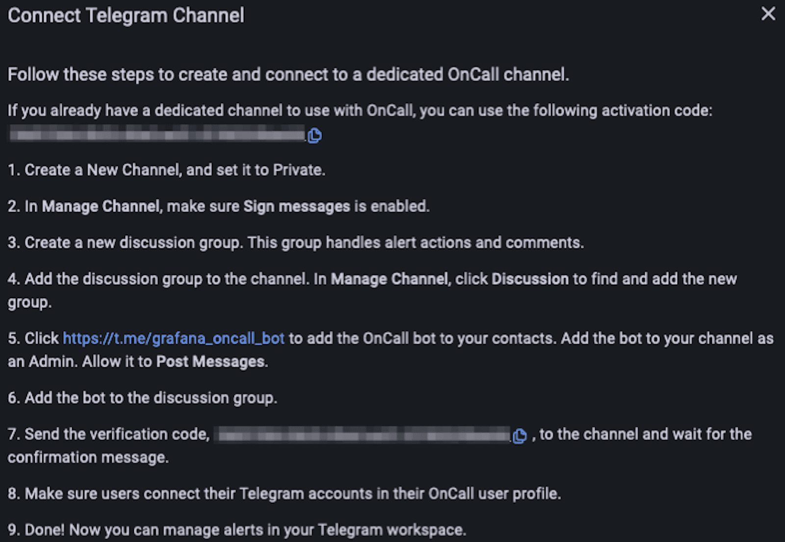

After you create a new escalation chain, jump into the ChatOps tab. I went with Telegram in this demo, but you can select different notification options. Press the Connect Telegram Channel button and this popup will appear:
A screenshot of the steps to connect a Telegram channel in Grafana OnCall.
This is cool, right? Grafana navigates us very well.

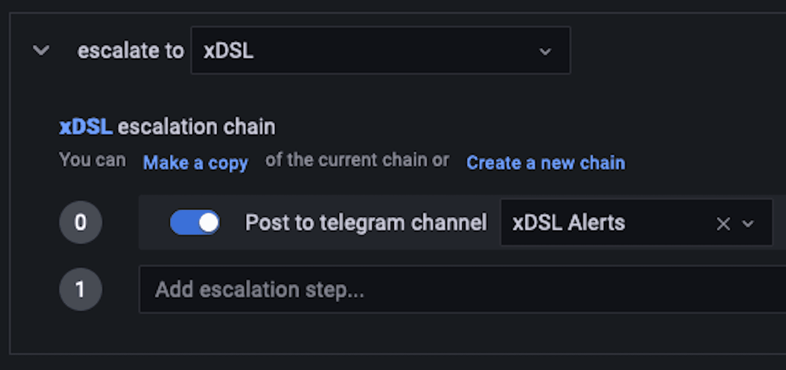

After you have completed all nine steps, jump back to the Integrations tab and add your Telegram to your escalation:
A screenshot showing Telegram being added to an escalation in Grafana OnCall.
When you’re ready, send a test notification. If you successfully received it on your channel, it’s time to define a new alert.

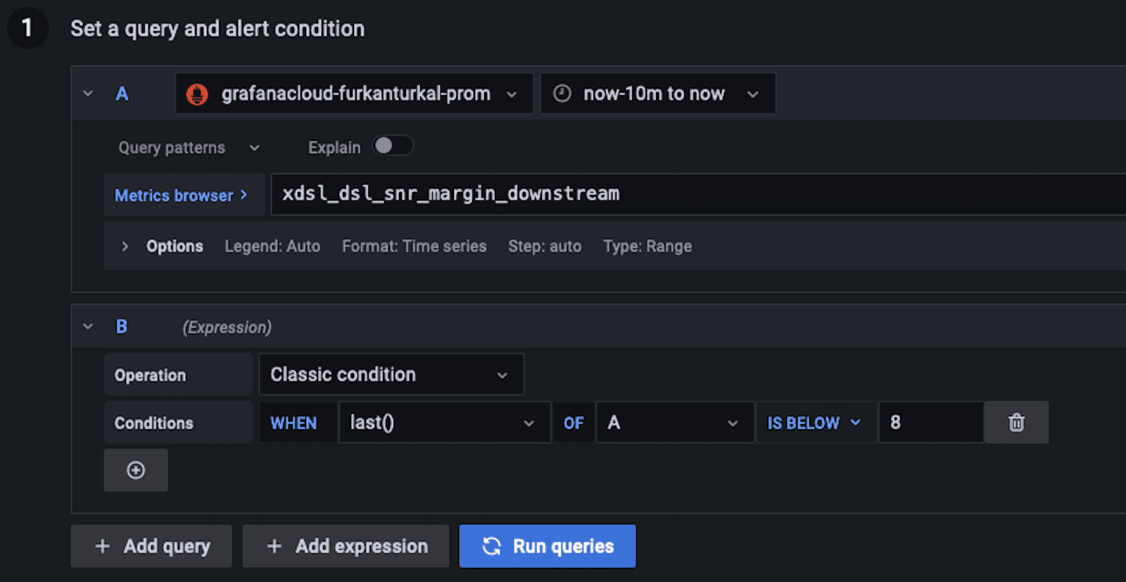

On your Grafana dashboard, click the Alerts icon on the left sidebar. To define a simple alert rule, press the New Alert Rule button. Remember that we use Grafana Managed Alerts, so select that. Then choose your correct Prometheus Data Source.
I will use the xdsl_dsl_snr_margin_downstream metric to check if SNR Margin drops lower than 8. Evaluating every 1m for 5m is fine for now.
A screenshot showing a window for setting a query and alert condition in Grafana.
Since this metric is in the dsl sub-namespace, I gave it a DSL Monitoring group. You can create another RTOP Monitoring for rtop sub-namespace metrics. Filling your Dashboard UID and Panel ID would increase the UX and allow for a fast jump to the dashboard from the incident notification. Finally, consider adding a clear Summary of the alert.

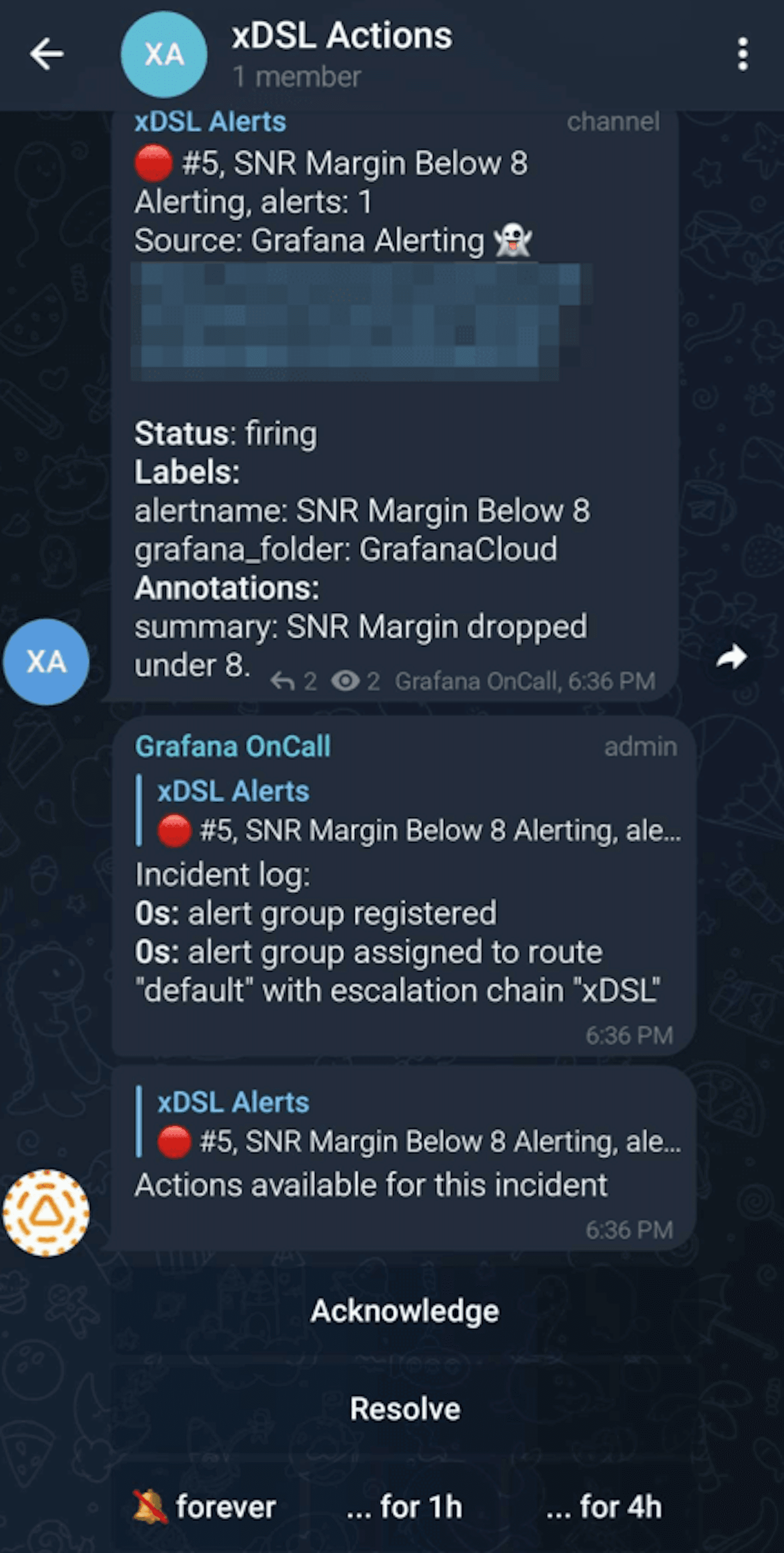

Save, exit, and wait for an alert . . .
A screenshot of a Grafana alert.
Success! Works like a charm!
On rainy and windy days, SNR Margin can drop to as low as 7 and network outages become inevitable — and it was one of those days.
When you get an alert, click the Acknowledge button to indicate that you have received and understood the alert by taking some action. Now call your ISP and say: “Hey, due to very unstable DSL line noise, I couldn’t work from home. Could you please adjust my line variables?”
Press the Resolve button when they take the necessary action and refresh your network line.
