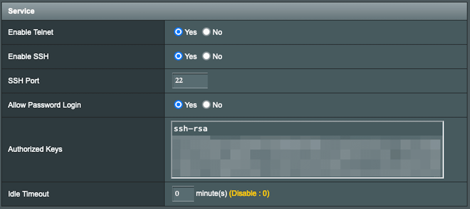

How will our exporter communicate with the modem? With SSH, of course! Therefore, we need to log into the modem’s interface and activate the SSH, and set our new key.
Enabling SSH on the modem
To do this, you must have an xDSL modem that is set up correctly and running. Additionally, you should generate a new SSH key-pair using ssh-keygen for passwordless login:
$ ssh-keygen -t rsa -f ~/.ssh/id_rsa_modem -q -N ‘’
Copy your public key and put it into Authorized Keys in the modem settings:
$ cat ~/.ssh/id_rsa_modem.pub
Also, don’t forget to set Idle Timeout to 0 since go-dsl does not support a reconnecting feature yet.
