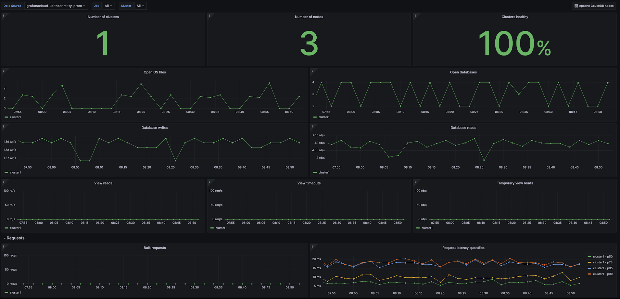

Apache CouchDB Overview dashboard
A Grafana Cloud dashboard displays metrics about clusters, nodes, reads, writes, requests, and latency.
The Apache CouchDB Overview dashboard provides you with a high-level view of one or all of your CouchDB clusters. You can view how many clusters and nodes are currently being monitored, along with their health status.
Aside from multiple panels for digging into request latencies, you can also see critical information regarding the number of open databases and files, as well as the throughput of reads and writes.

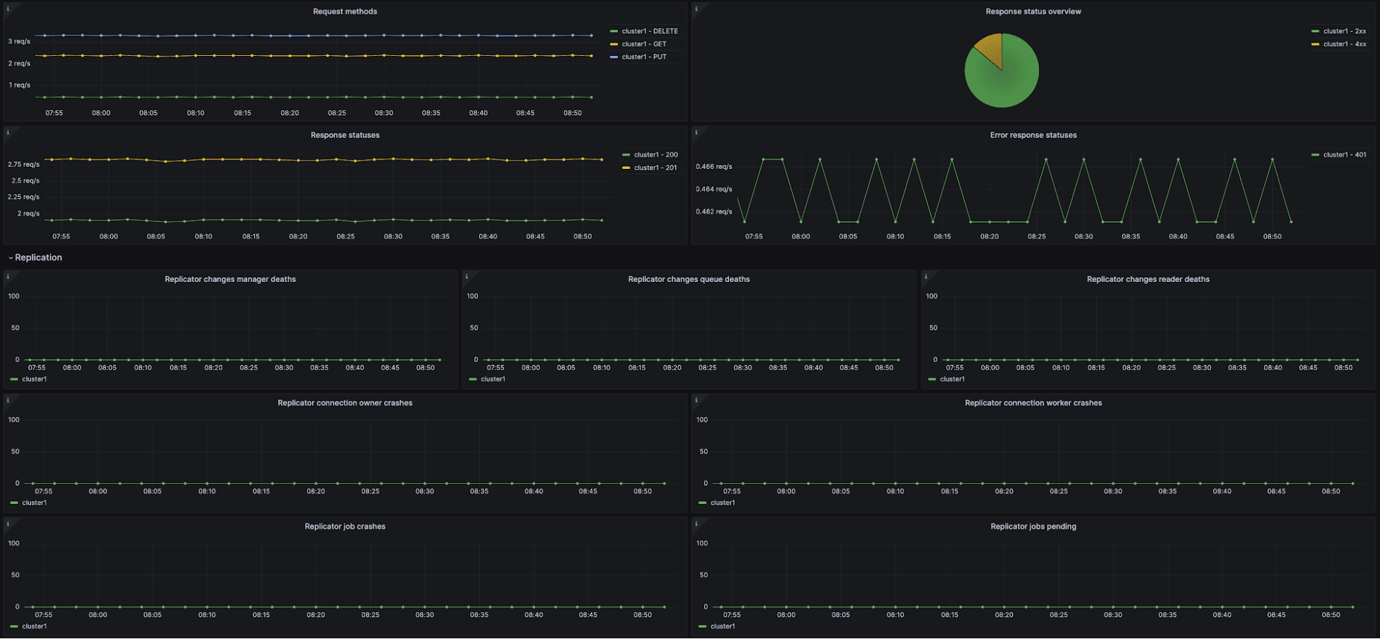

Additionally, a number of panels are included to specifically monitor the replication state of your cluster(s), with easily available data on replication queue status, replication connection crashes of both owners and workers, and the number of pending replication jobs.
The key metrics for this dashboard are the following:
  • couchdb_open_os_files_total
  • couchdb_database_writes_total
  • couchdb_database_reads_total
  • couchdb_request_time_seconds
  • couchdb_httpd_status_codes
  • couchdb_couch_replicator_connection_owner_crashes_total
  • couchdb_couch_replicator_jobs_pending
A Grafana Cloud dashboard displays information about request methods, response status, replicator changes, and more.

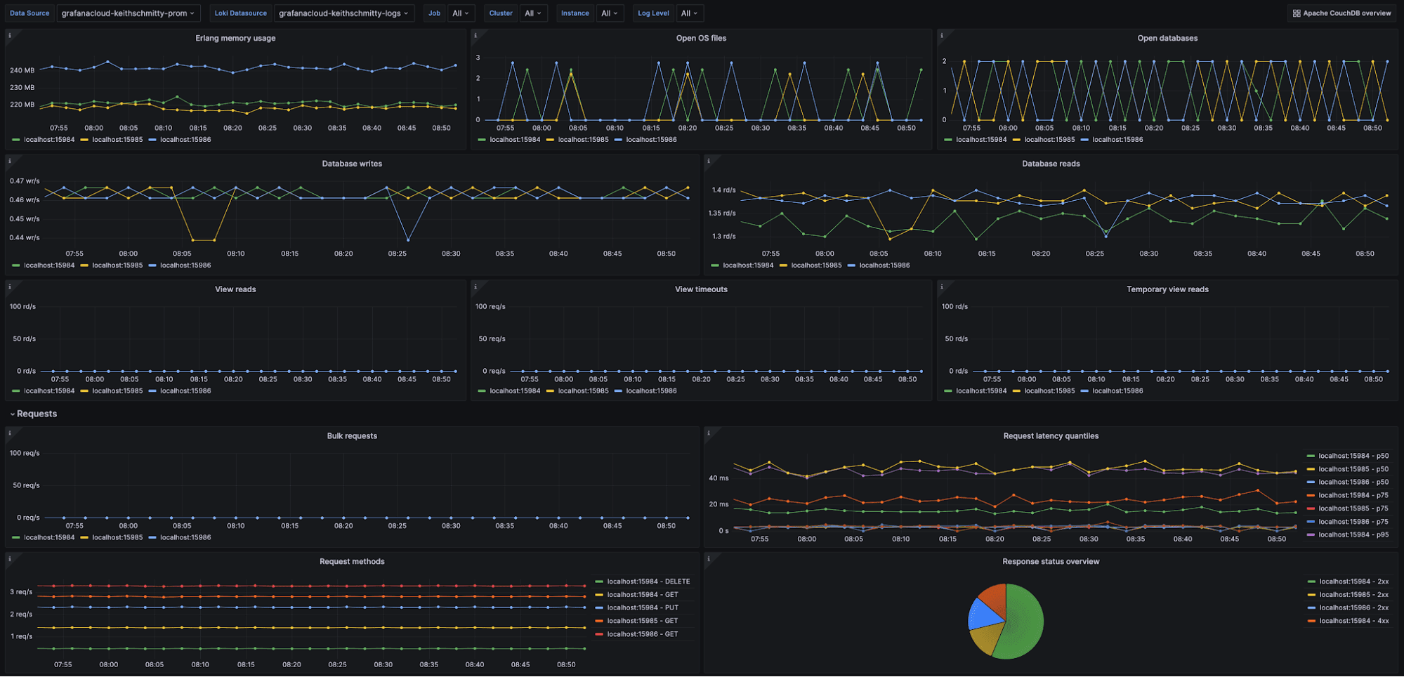

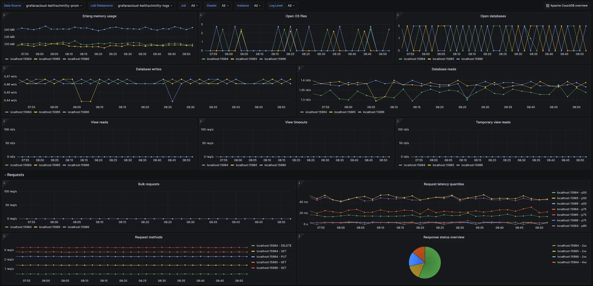

Apache CouchDB Nodes dashboard
A Grafana Cloud dashboard displays information about memory usage, files, open databases, reads, writes, and more.
The Apache CouchDB Nodes dashboard provides a drill-down view of the information present on the overview dashboard, on a per-node basis, along with node-specific metrics that are helpful in observing the health of any given node in your Apache CouchDB cluster.

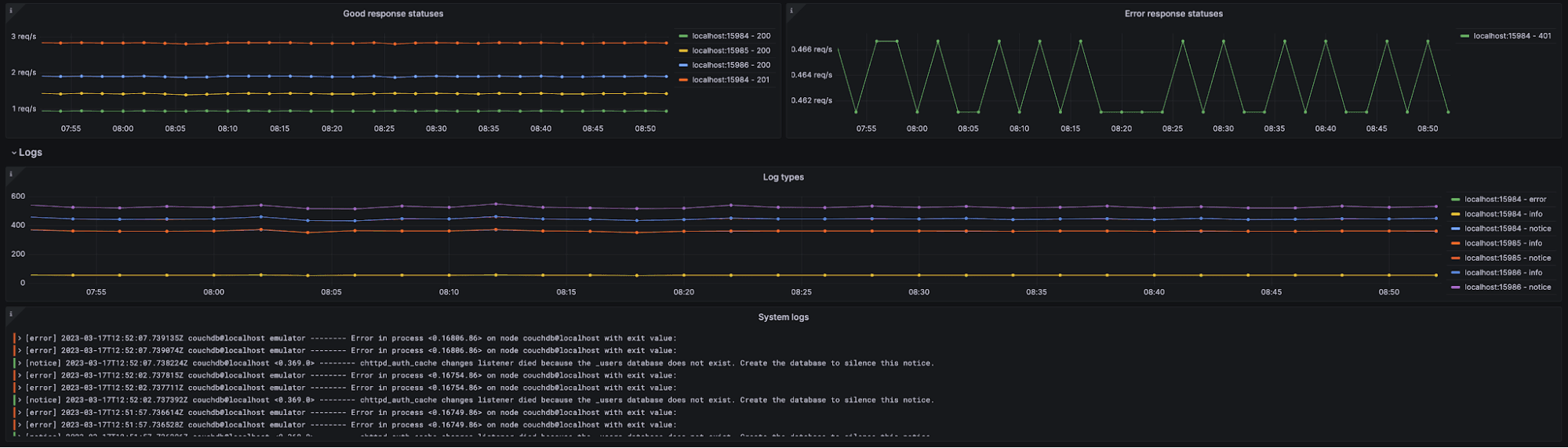

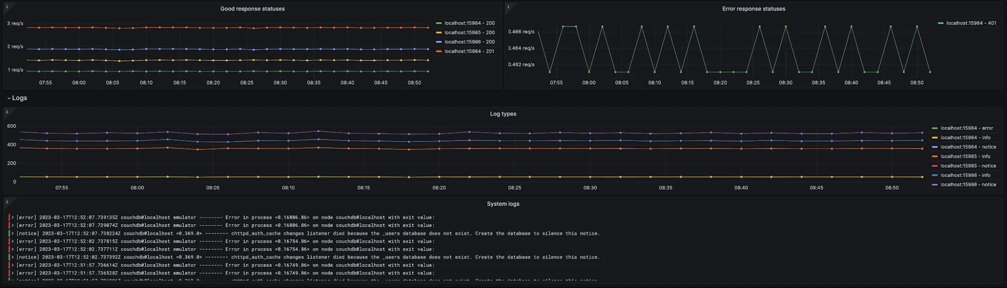

And finally, you can inspect your CouchDB node system logs directly from the dashboard, as seen below:
A Grafana Cloud dashboard displays information on response status and logs.
