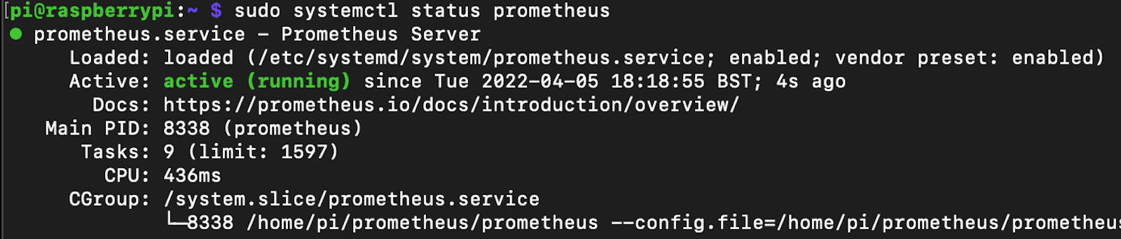

Check to see if Prometheus is running with:
sudo systemctl status prometheus
You should see an output similar to this:
Embedded image
You should also be able to see that Prometheus is running by heading to its web UI at on port 9090 or: your_pi_IP_address:9090.

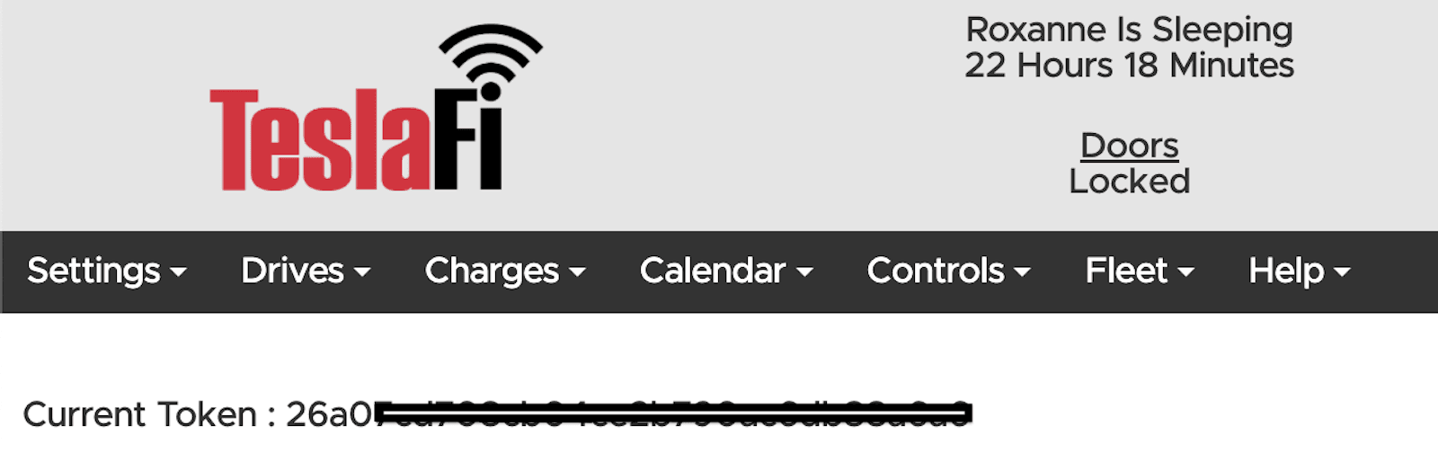

Next, you’ll need to head to Teslafi to grab your API token. While there are ways to access the Tesla APIs directly, using Teslafi was an easier approach.
You can access the Teslafi API location here after logging in. You will want to create a token if one has not already been created, and then copy down the Current Token number/letter string, not the whole link or anything further down on the page. (The one here is for reference only.)
Embedded image

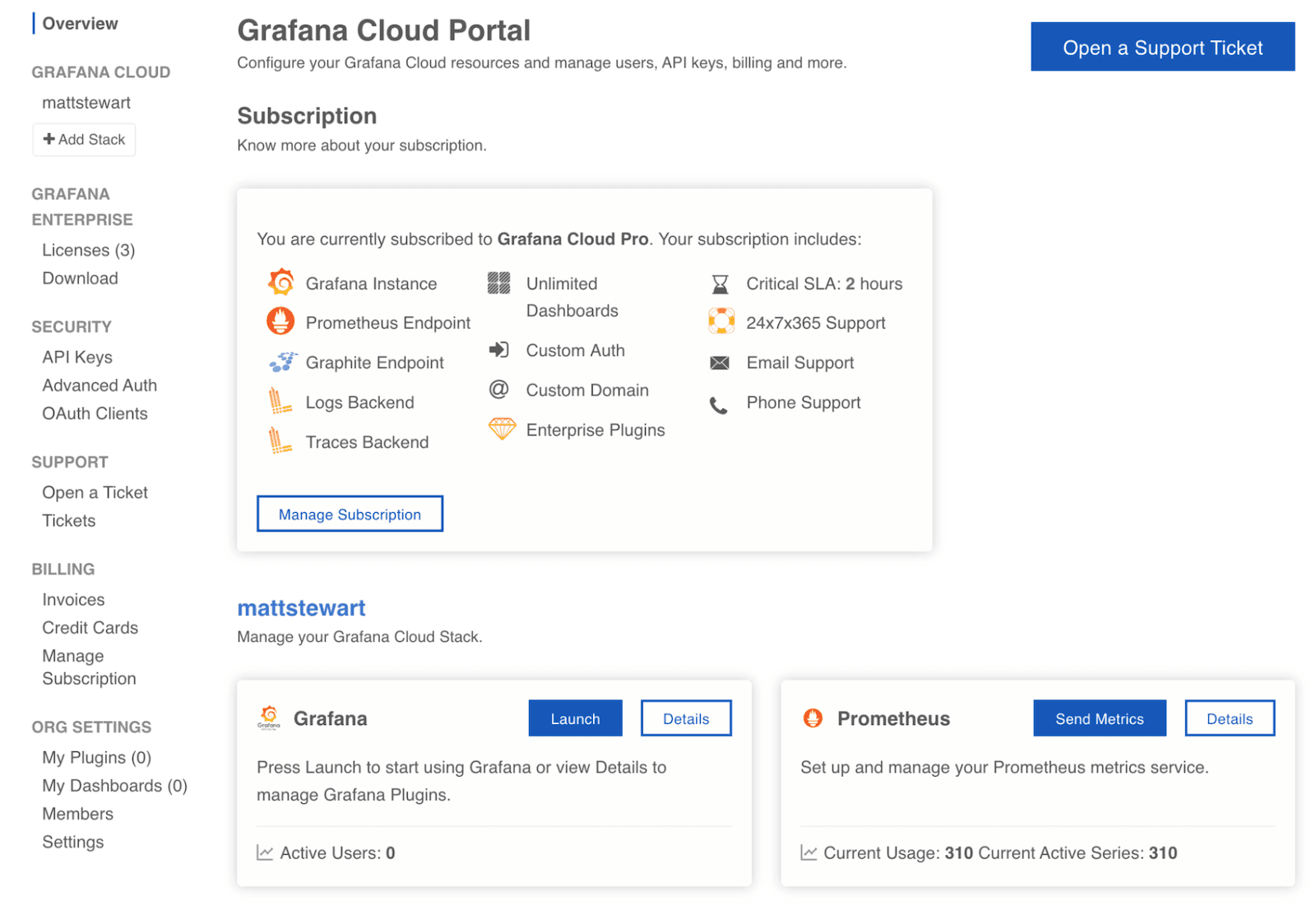

In order to get your url, username, and password for the remote write section, navigate to your Cloud admin area which can be found at https://grafana.com/orgs/your_org_name_here
Embedded image
Click on Prometheus -> Details
Copy the Remote Write Endpoint and insert it into the url section in your prometheus.yml config.
Copy the Username/Instance ID and insert it into the username section in your config.
Under Password/API Key in the Cloud Admin page, click on the blue ‘generate now’ link. Give your API Key a name and Admin access. Then copy the API key, and insert it into the Password section on the config.

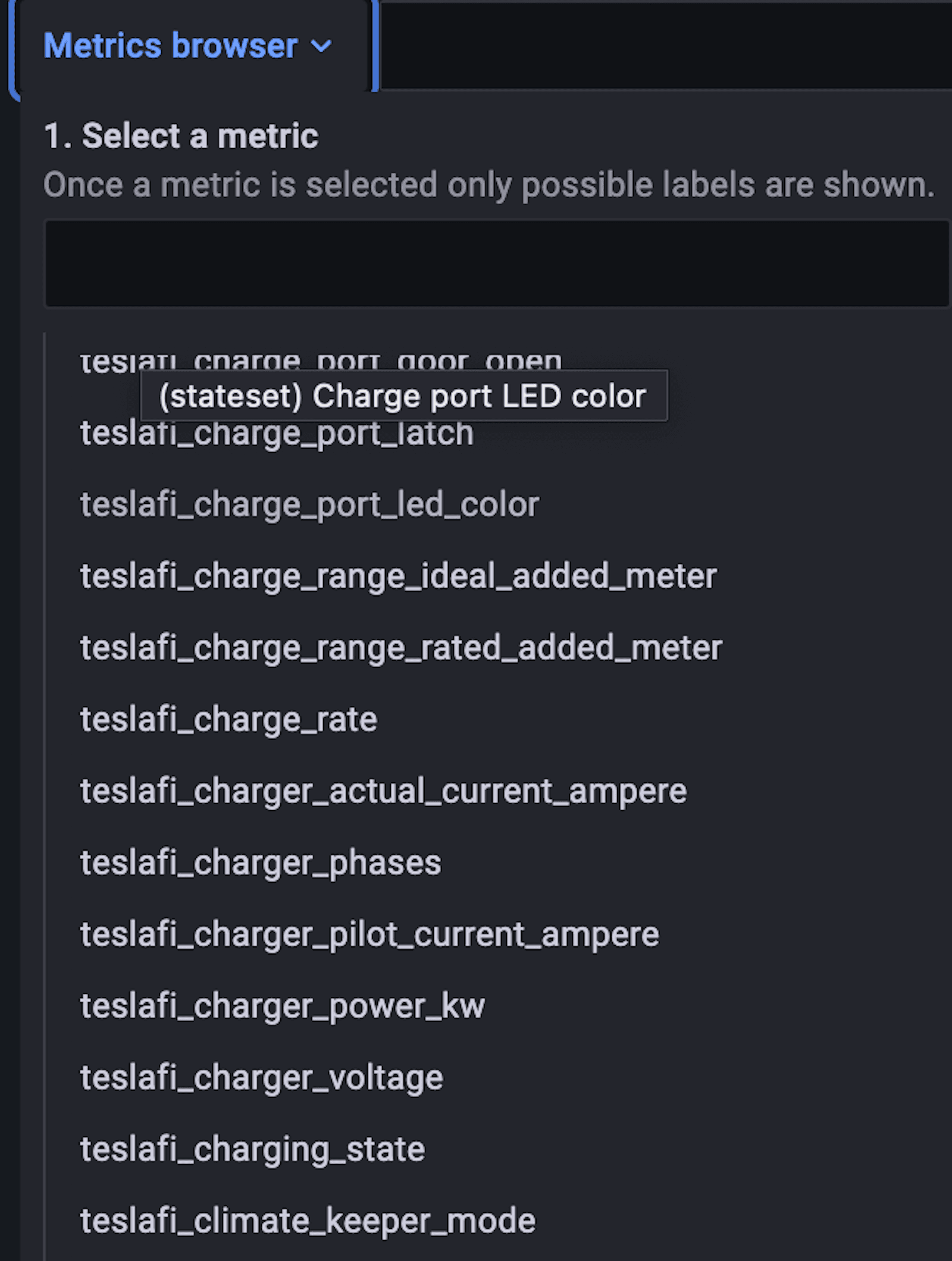

Navigate to Grafana, head to Explore, and select the grafanacloud-yourorgname-prom data source. Open the Metricsexplorer, and you should now see data with the teslafi labels available to use.
Embedded image
Congrats! The Teslafi data is now being scraped and is usable inside of your Grafana Cloud and Prometheus deployments.

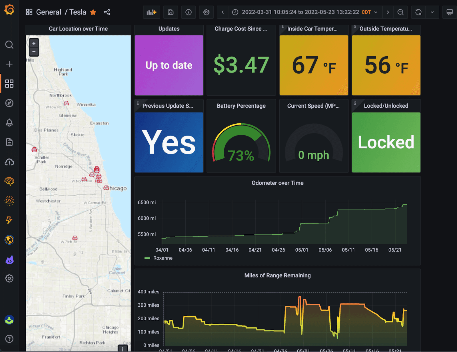

So what can you visualize with all of the data? I’m working on another blog that will focus on dashboarding some of this capability. Here’s a sneak peek!
Embedded image
