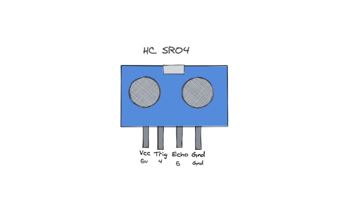

HC-SR04 sensor
The HC-SR04 ultrasonic sensor provides 2cm–4 meters of measurement function, with accuracy around 3mm. This sensor will be used to measure how far your sourdough starter is from the lid and calculate its rise and/or fall. The HC-SR04 has 4 pins that you will connect to the ESP32 board in the following way:
- Vcc pin to 5V on board
- Trig pin (sends the signal) to pin 4 on board
- Echo pin (receives signal) to pin 5 on board
- Gnd pin to Gnd on board

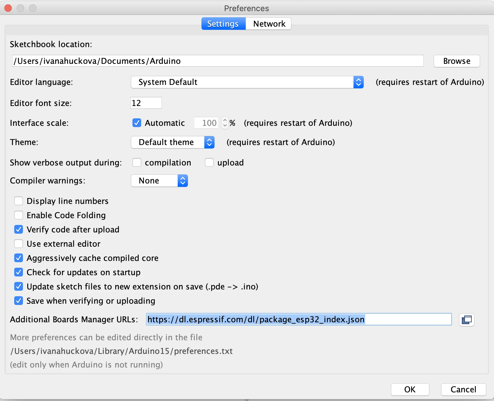

Open your Arduino IDE. If you are using an ESP32 board (and not an Arduino board), you need to add a board definition that adds support for your EP32 board. Go to Arduino > Preferences and add url https://dl.espressif.com/dl/package_esp32_index.json to the Additional Boards Manager URLs input. This open source board definition adds support for programming ESP32 boards.

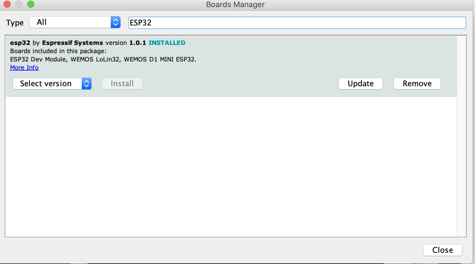

Then go to Tools -> Boards -> Boards Manager and add ESP32 board manager.

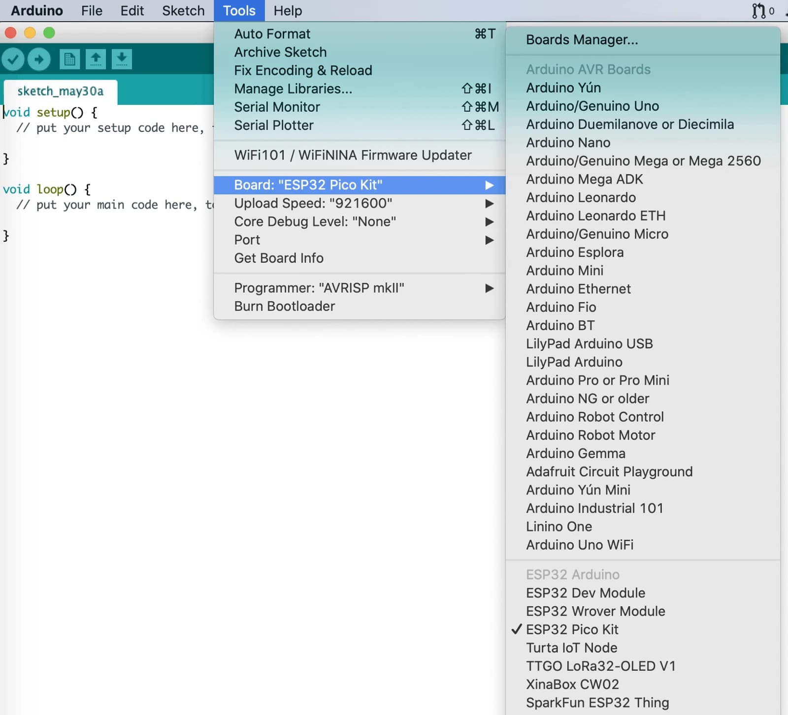

Next, in Tools -> Boards, choose ESP32 Pico Kit board. This tells the Arduino IDE which profile and base libraries to use when compiling the firmware image, and how to flash it to the board. Make sure that in the Tools -> Port submenu, you have selected the new COM port.

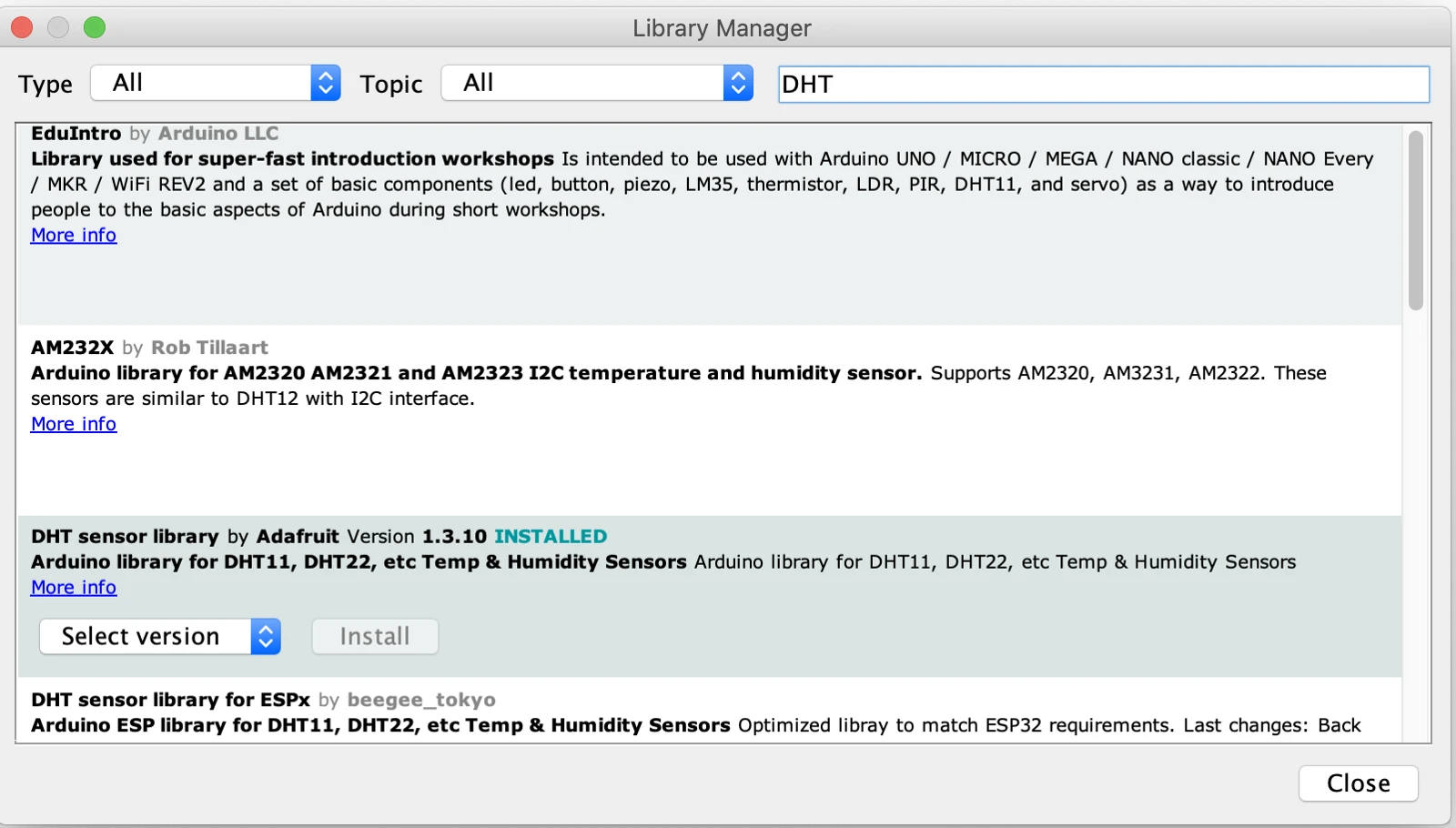

Go to Sketch -> Include Library -> Library Manager and install all of these. Make sure that you have all of them installed before moving to the next steps.

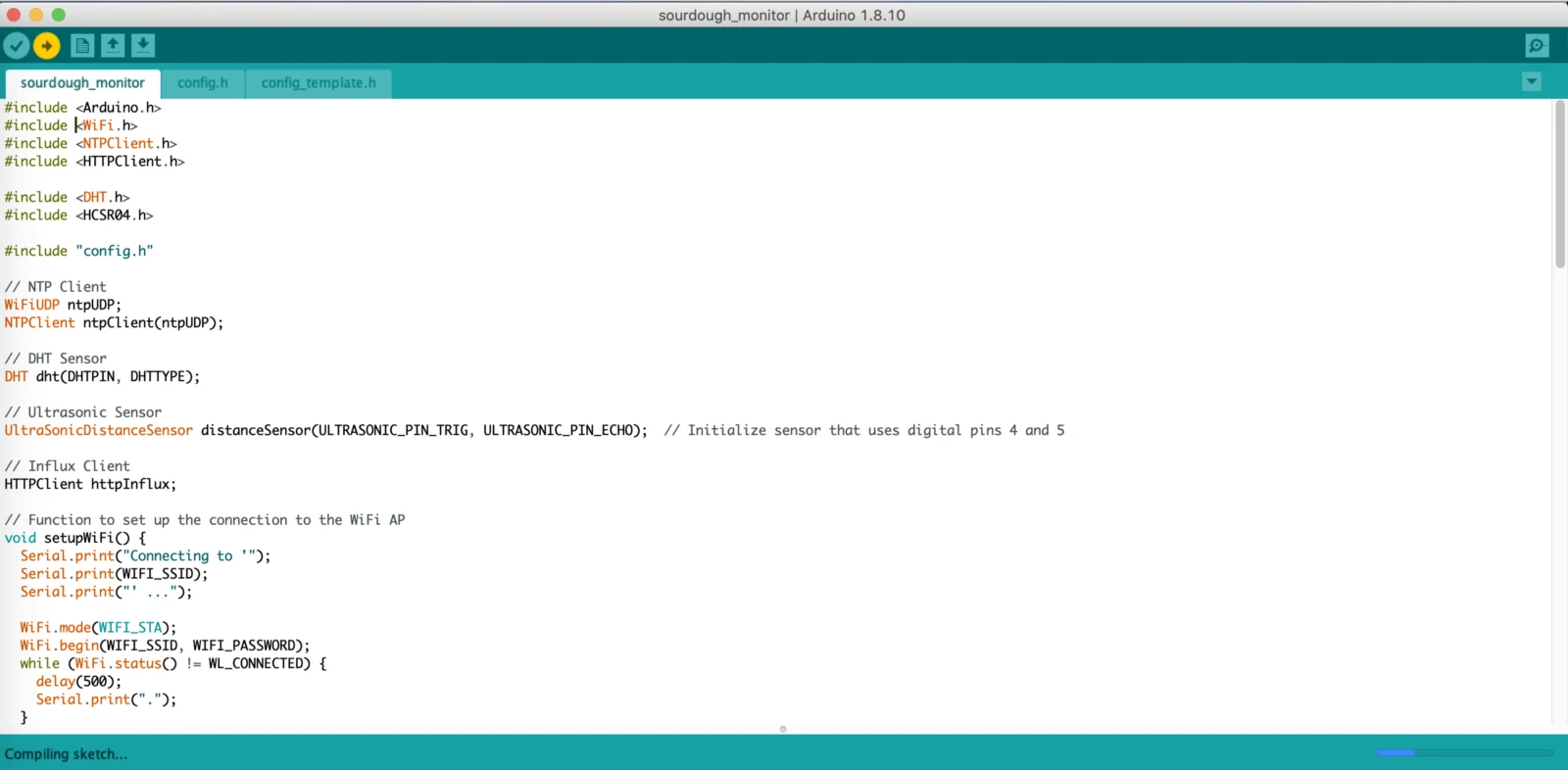

File sourdough_monitoring_grafana.ino Below you can find the program code with the comments explaining each section.

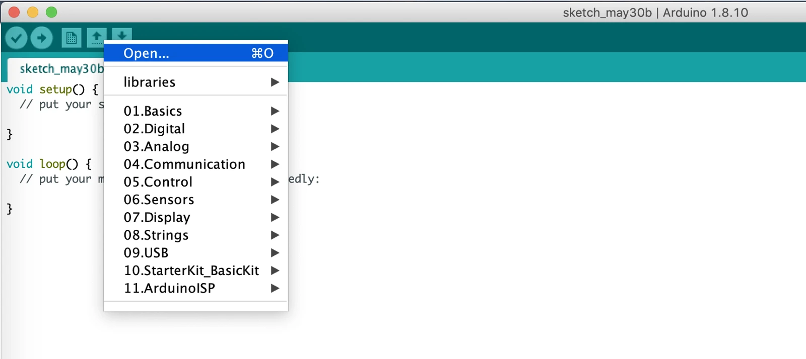

Click on the open button (arrow pointing up), choose Open, find your sourdough_monitor_grafana.ino file and open it.
