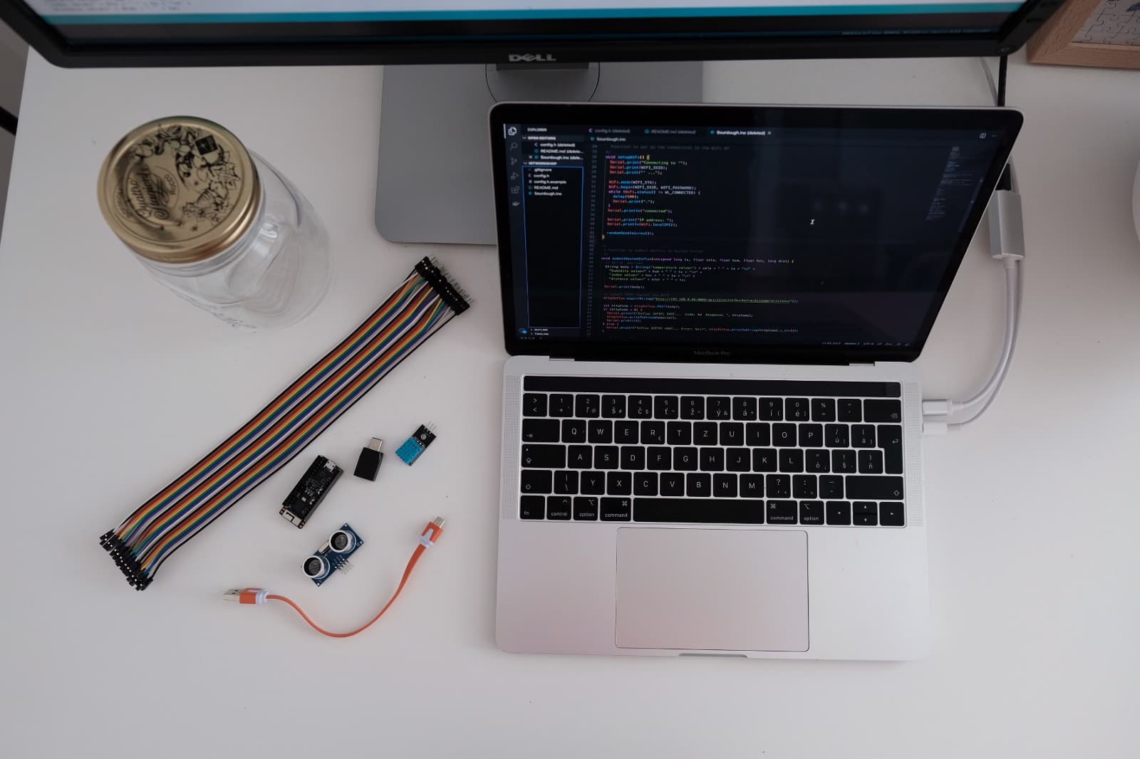

To build the sourdough monitoring system you will need:
  • 1 DHT11 sensor module to measure temperature and humidity
  • 1 HC-SR04 ultrasonic distance sensor to measure sourdough rise
  • 2 HC-SR04 holders
  • 1 ESP32-PICO-KIT V4 development board
  • 7 M-F Dupont Cables
  • 1 micro USB cable
  • 1 USB charger
Plus: - 1 medium-sized jar for your sourdough starter, with a lid you can cut - Something that will cut a hole in the middle of the lid - A  glue gun, superglue or double-sided scotch tape (ideally all of them)

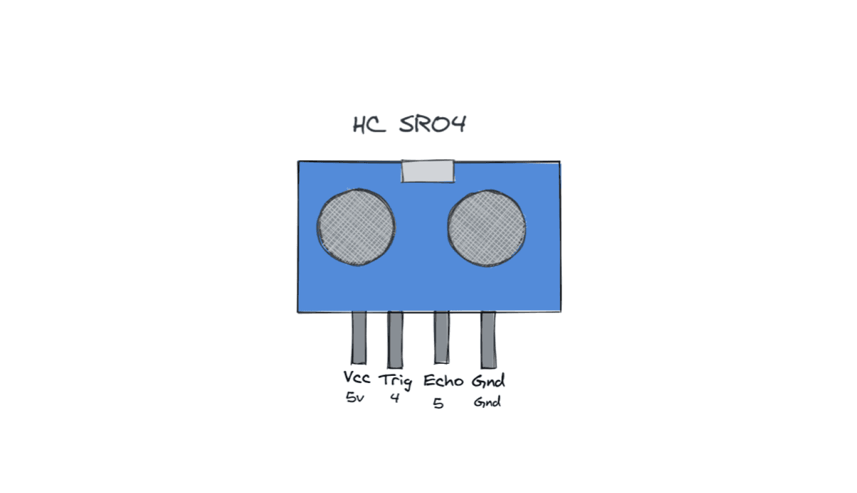

The HC-SR04 ultrasonic distance sensor This sensor provides 2cm to 4m of measurement function, with accuracy around 3mm. This will be used to measure how far your sourdough starter is from the lid and calculate its rise and/or fall.
The HC-SR04 has four pins that you’re going to connect to development board like this:
Embedded image
  • Vcc pin to 5V on board
  • Trig pin that sends the signal to pin 4 on board
  • Echo pin that receives signal to pin 5on board
  • Gnd pin to Gnd on board

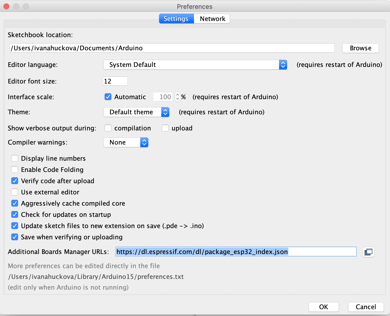

Step 1: Set up Arduino IDE to support your ESP32 board
Open your Arduino IDE. If you are using an ESP32 board as I have recommended (and not an Arduino board), you need to add a board definition that adds support for your EP32 board. Go to Arduino > Preferences and add url https://dl.espressif.com/dl/package_esp32_index.json to the Additional Boards Manager URLs input. This open-source board definition adds support for programming ESP32 boards.

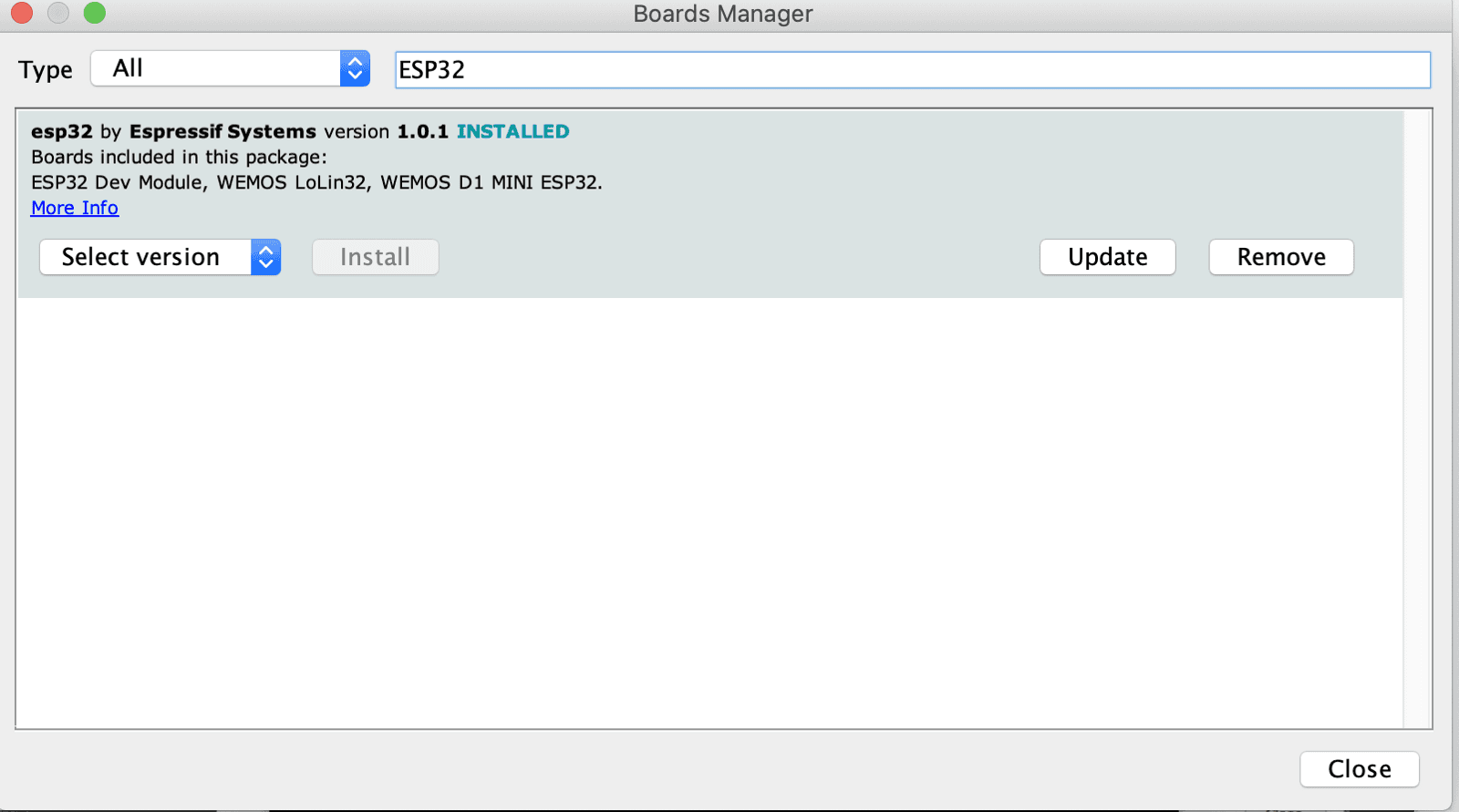

Then go to Tools > Boards > Boards Manager and add ESP32 board manager.
Embedded image

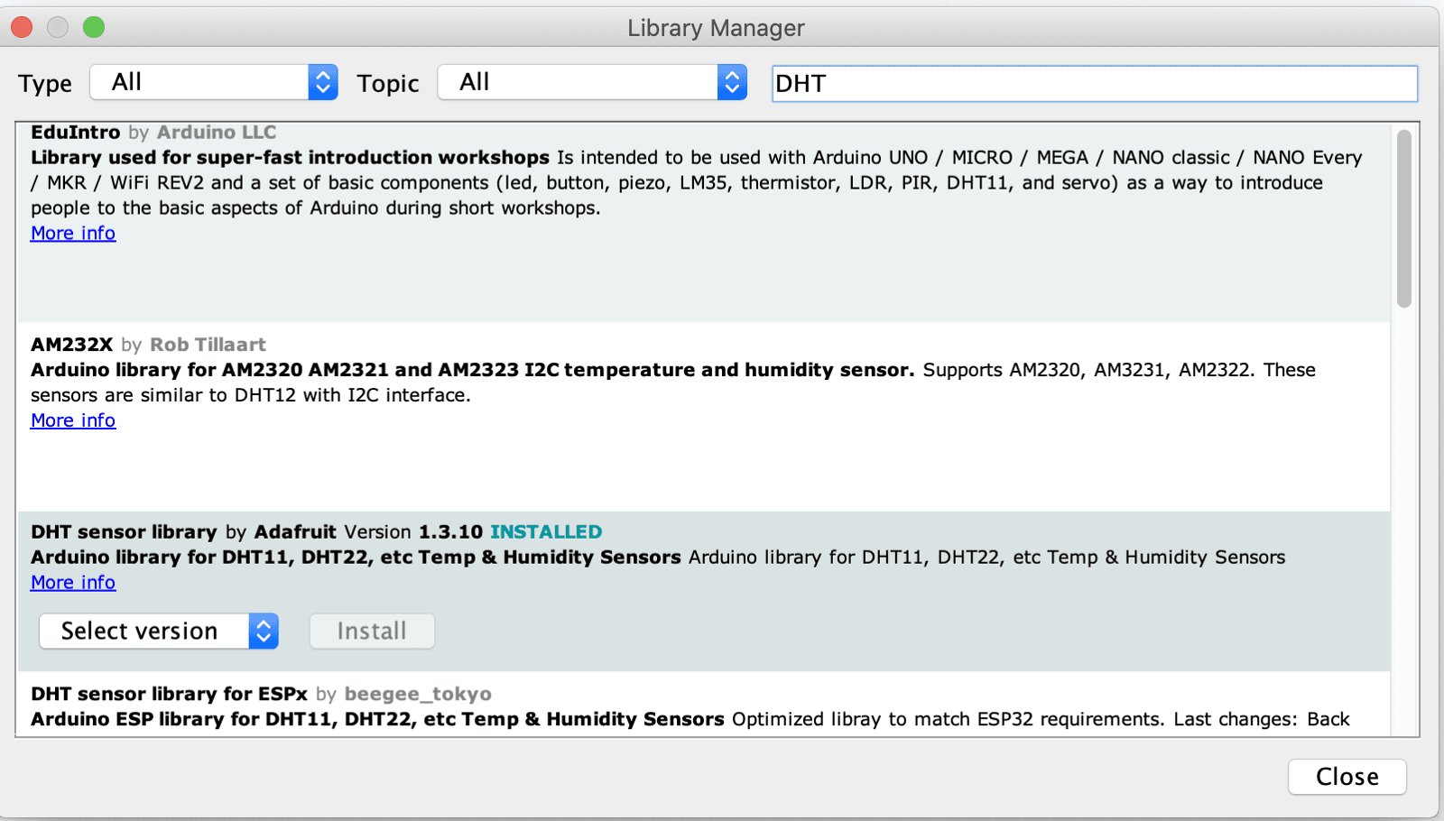

Step 2: Add libraries
For this project you’re going to use following libraries: - DHT sensor library by Adafruit - Adafruit Unified Sensor by Adafruit - NTP Client by Fabrice Weinberg - HCSR04 by Martin Sosic
Go to Sketch > Include Library > Library Manager and install all of these libraries. Make sure that you have all of them installed before moving to the next steps.
Embedded image

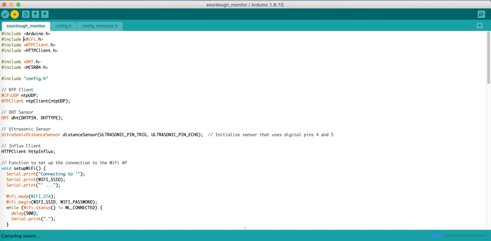

File sourdough_monitor.ino:
Below you can find the program code with the comments explaining each section.

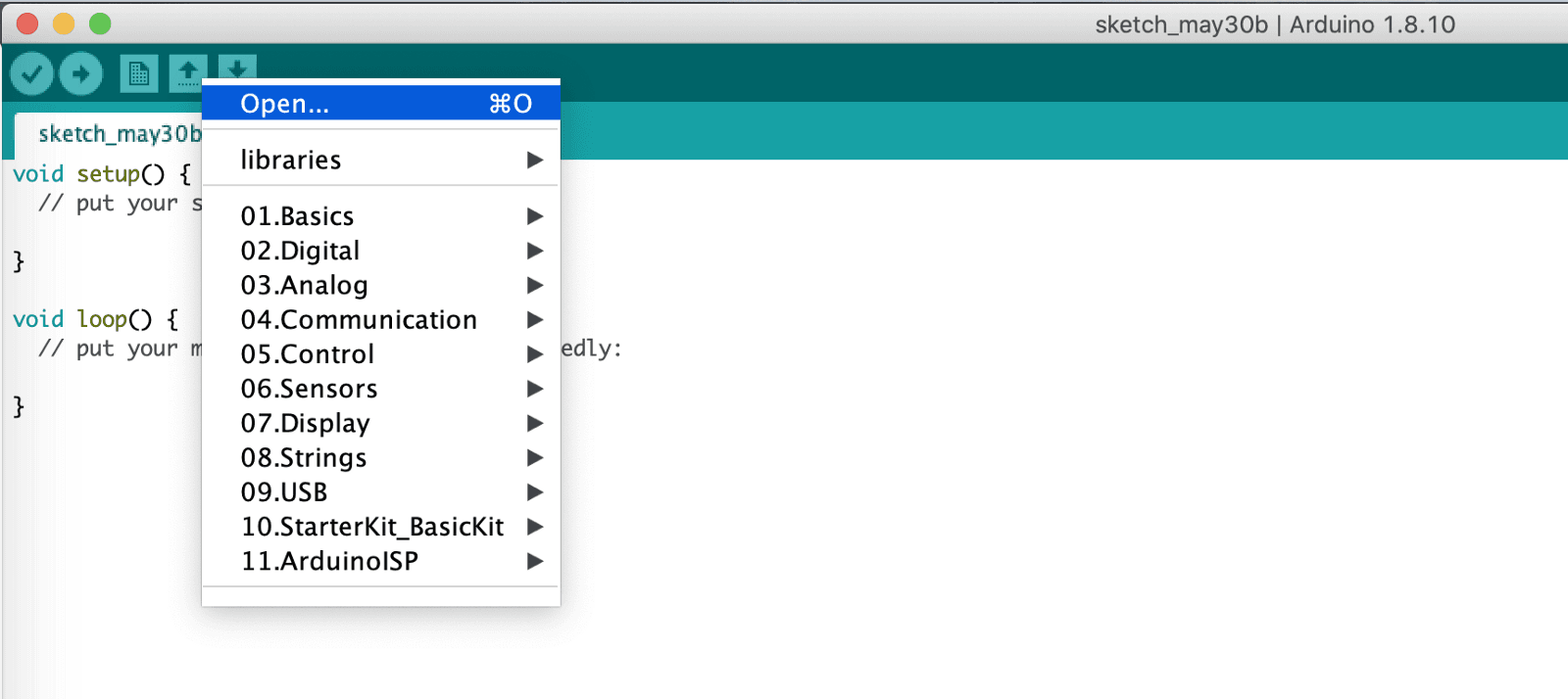

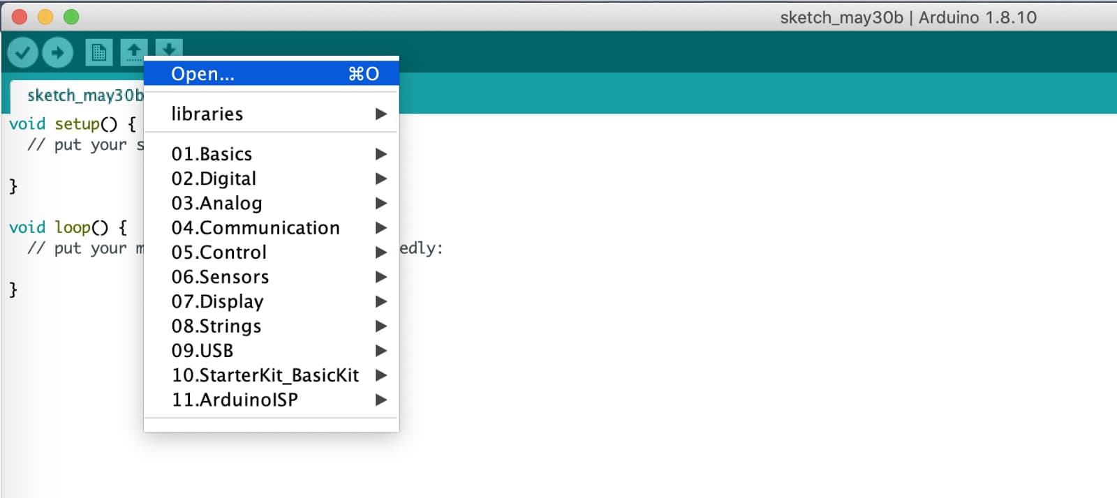

Click on the open button (arrow pointing up), choose Open, find your sourdough_monitor.ino file and open it.
Embedded image

And finally, use the Upload button (the arrow pointing to the right) in the UI to build and upload the program to the ESP32.
Embedded image

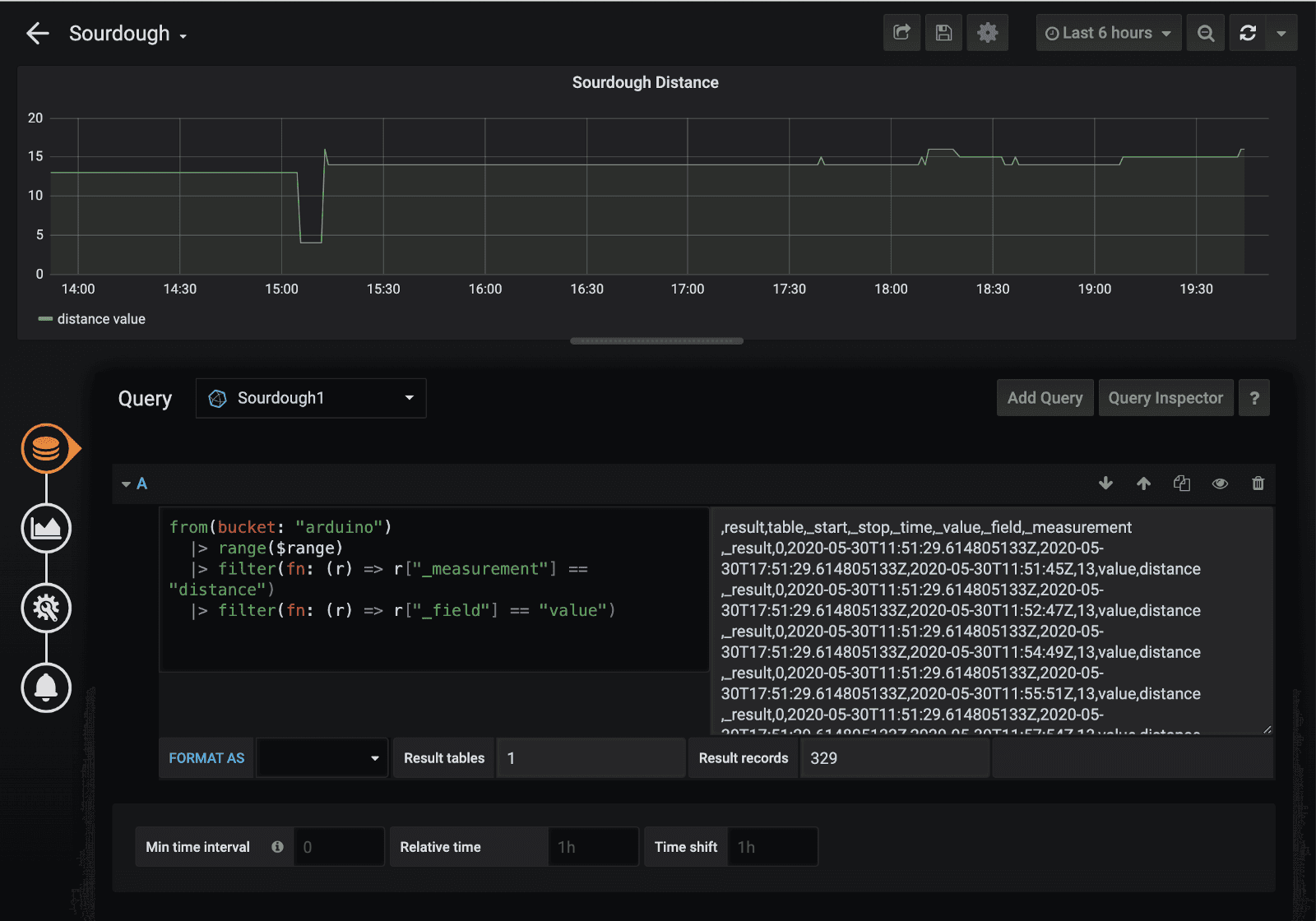

Data visualization in Grafana
When you have all your data flowing to InfluxDB, it’s time to visualize them in Grafana. Follow the installation guide to set it up.
Unfortunately, Influx data source doesn’t provide authentication with a token, so you’ll need to add the Flux [BETA] data source plugin. Fill out your organization I.D., bucket and token, and save the data source.
Next, create dashboards. Flux data source has a query editor compatible with its cloud interface, and you can just copy-paste queries from your InfluxDB query editor.
Embedded image

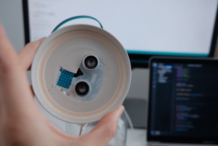

You can put the jar itself aside for the moment, because this is all about the lid. Carefully make one 2cm x 5cm hole in the middle of the lid for the HC-SR04, and a smaller one next to it for the DHT11.
Put the HC-SR04 sensor in a HC-SR04 holder then place the second holder on top of it. Glue the sensor holders with the sensors to the lid. With double-side tape, stick the DHT11 to the lid so it will be facing the inside of the jar.
Embedded image

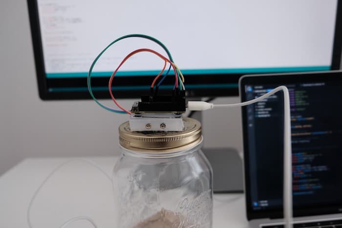

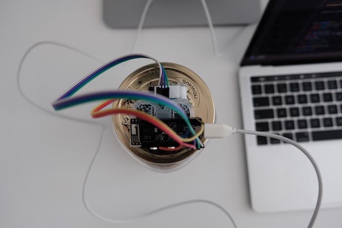

With a glue gun, carefully glue the ESP32 board to the top of the HC-SR04 holder. Make sure that you’re only gluing the extended parts on which the ESP32 board stands, and not the board itself.
Embedded image

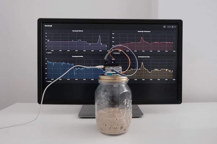

The photo below is how it should look. (I later added a cover from a cut plastic bottle to make sure that sourdough doesn’t dry out through the holes in the lid.)
Embedded image
Put the jar in your kitchen – or wherever you plan to keep your starter – and plug it to the USB charger.
Embedded image
Now you’re ready to add your starter ingredients and begin monitoring the progress.
