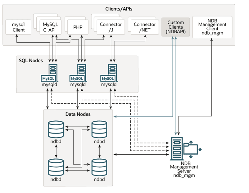

Before getting started, it’s helpful to note that the NDB platform consists of three major components, or processes.
First, there’s the ndb_mgm process, which is the cluster manager. This is the service that holds the configurations of the cluster, manages sharding and paging within memory, performs snapshots to disk, and manages the quorum of nodes within the cluster. It also partitions the data across the various nodes and groups within the cluster.
Next is the ndbd process, which connects the data nodes to the cluster and allows memory and disk resources to be available for the cluster to store data and indexes.
Lastly, there’s the MySQL process within the NDB platform, known as the API node. This is because this is the access point to the NDB database engine, which can consist of SQL and NoSQL queries at any given time. It is also where the NDB table and index information is stored locally in the InnoDB MySQL schema.

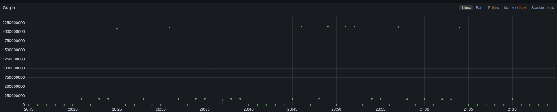

When testing new queries from new data sources, I usually use Explore. It gives me the flexibility to test multiple platforms at once and compare queries and data returned. For the first test, let’s check to see if Grafana is seeing the NDB data that we are polling for in Telegraf with inputs.exec:
SELECT last("values") FROM "autogen"."NDBnodeMemory" WHERE $timeFilter GROUP BY time($__interval) fill(null)
Here, we see data coming in every minute, as we have it set in Telegraf:

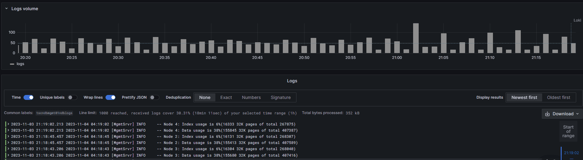

Let’s say we do the same for ndbd and get the same results. Now, we move on to our Loki data source and see if logs are coming in. Check log entries for servercs01ndblogs:
{job=”servercs01ndblogs} |=``
And we can see logs are coming in:
Then, add a filter to the query that we will use for our alarm:
{job=”servercs01ndblogs} |=`backup`
Again, we see the logs are coming in for backups within the timeframe we want:

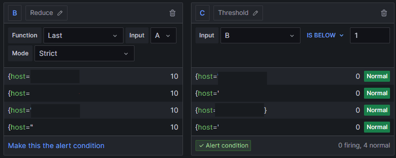

We can write our expressions for the alarm based on the count of processes; if the count is below 1, the alarm is triggered:
All clear for now. Now, set the alert behavior, per our requirements:

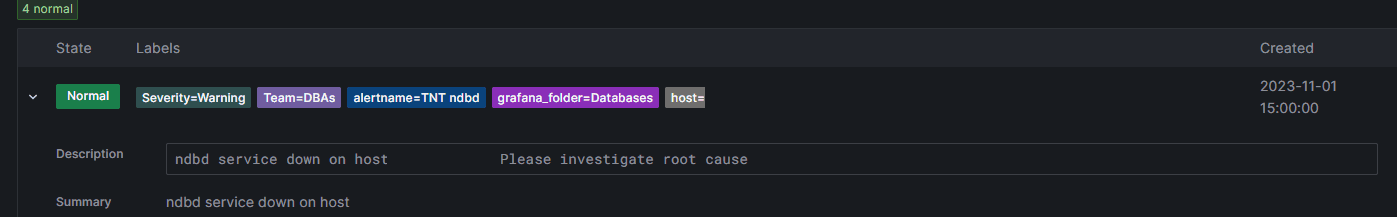

Add the labels and values from our query results into the message. The labels and values can be seen in the expressions:
Then, add the custom labels and keys for where the notification goes and what it displays. We can use the Severity label to add a threshold level (critical/warning). In this case, the service not running is critical no matter what, but still use a threshold:
{{ if lt $values.B.Value 1.0 }}Critical{{ else }}Warning{{ end }}
We add the Team, which in this case is DBAs:
When we save the alert, wait for the alarm to be polled. Whether or not the alarm is currently firing doesn’t matter. We want to check to see if the labels are working correctly:
Everything looks good. We can follow this same basic process to create alarms from other InfluxDB values that we’re polling for.
