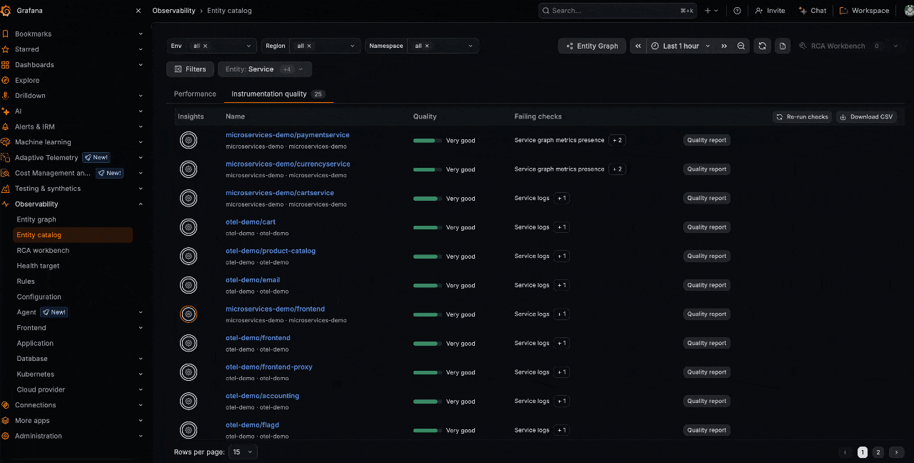

List view (Entity catalog → Instrumentation quality tab): a fleet-wide table that scores every service and shows its failing checks, so you can quickly spot and prioritize services that need attention.
Service view (Entity drawer/entity page → Quality report tab): a report for an individual service that lists exactly which checks are passing and failing, their impact, relevant docs, and a query to verify each gap.
Here’s a closer look.
List view: find and prioritize gaps across your fleet
This view gives you a filterable table of every service and its instrumentation health. Each row shows:
- Insights: a health/assertions indicator (the Knowledge Graph "circle") for the service.
- Name: the service name with its environment and namespace as a subtitle (since the same name can exist in different scopes). Click it to open the entity drawer.
- Quality: a progress bar plus the tier label (Poor, Good, Very good, Perfect).
- Failing checks: the first failing check, plus a +N badge indicating how many additional check types are failing.
- Quality report: a button that takes you directly into the drawer's quality tab for that service.
You can filter the list by failing check type (multi-select is supported), search by service name, and scope by environment, site, and namespace. The tab badge shows the total number of services matching your current filters. When you need the data outside of Grafana Cloud, the Download CSV button exports the current page of results. The header also includes a Re-run checks button, which triggers an on-demand refresh of quality reports for the whole stack instead of waiting for the daily cycle.
