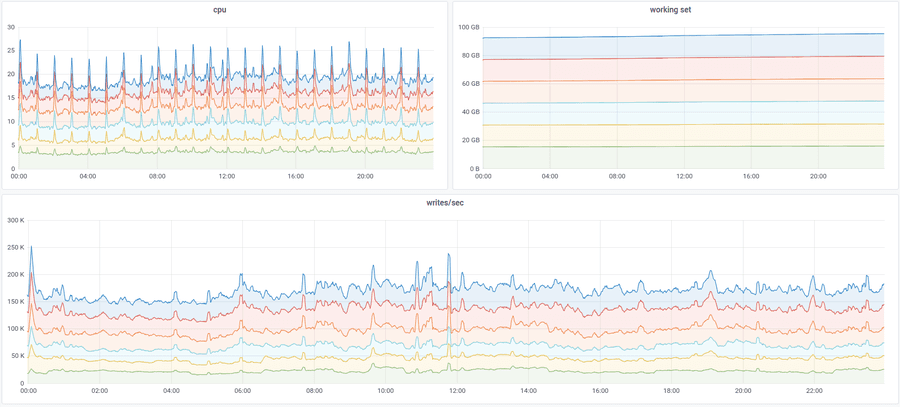

At Grafana Labs we have deployed the Scylla image to GKE with default settings and are still getting ~175k writes per second (after replication) for around ~20 cores and ~95 GB of memory. If you’re just getting started with Scylla in Kubernetes check out the Scylla operator.
Embedded image

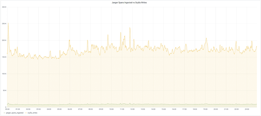

So Scylla is handling ~175k writes/second, but if we check our Jaeger metrics, we’re only ingesting ~8k spans/second. Where are all of these writes coming from? In Jaeger, the number of writes/second to Scylla is a direct multiplier on the number of spans/second. Let’s investigate the source of all of these writes.
Embedded image

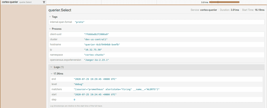

  • N rows for every tag associated with the span
    • N is the average number of tags per span in your environment. Keep in mind that all tags, process tags, and every tag for every log are indexed by default. For instance, the following span would result in 12 writes to the tag index:

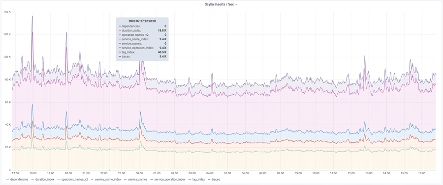

Everyone’s distribution will be a little different (depending on your average tags per span), but at Grafana Labs, the majority of our writes are, unsurprisingly, the tags index at 40k/second. The above analysis proved to be correct: We are writing ~8k/second to the service name, service operation, and trace index, and ~16k/second to the duration index.
Embedded image

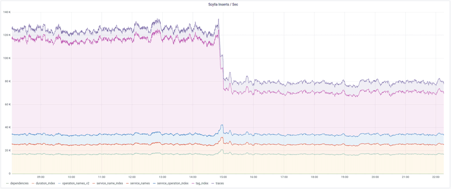

This is our configuration, but you should really tailor this to your needs:
index:
  tag-blacklist: client-uuid,span.kind,component,internal.span.format,ip,jaeger.version,sampler.type,sampler.param,http.method
  logs: false
Adding the above configuration reduced our total writes to the backend by about 33%. Our tag index writes/second went from ~85k to ~40k.
