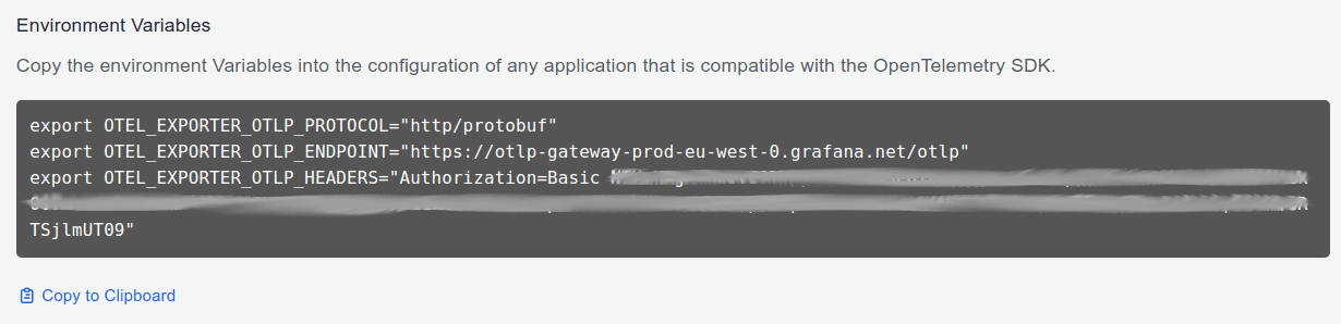

  1. In the Password / API Token section, click on Generate now to create a new API token:
    • Give the API token a name, for example cart-service
    • Click on Create token
    • Click on Close without copying the token
    • Click on Copy to Clipboard to copy the environment variables to the clipboard
Example of API token generated for OpenTelemetry SDK

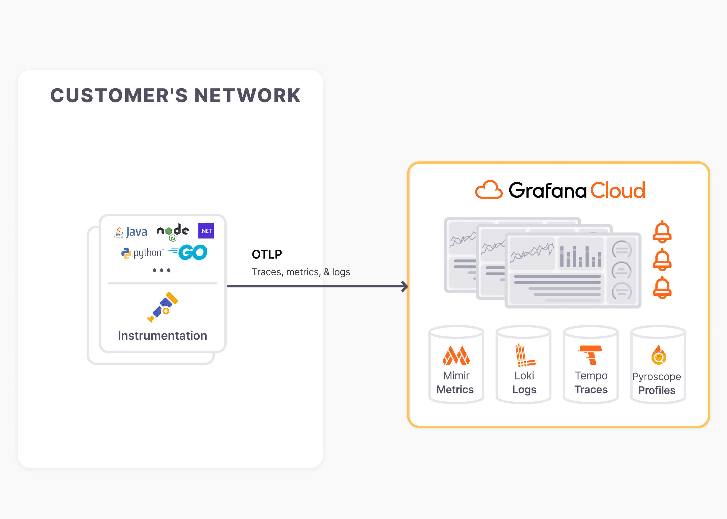

Grafana Cloud Application Observability is an out-of-the box solution to monitor applications and minimize MTTR (mean time to resolution). Application Observability is our take at combining the best observability technologies into a seamless package:
  • OpenTelemetry for getting the best data out of your application — without vendor lock-in
  • Prometheus and Grafana Cloud as proven technologies for storing and visualizing telemetry data with rich integrations (e.g. frontend and infrastructure monitoring)
Diagram of how any application can be instrumented with OpenTelemetry and then visualized with Grafana Cloud
Discover more about Application Observability in our documentation:
