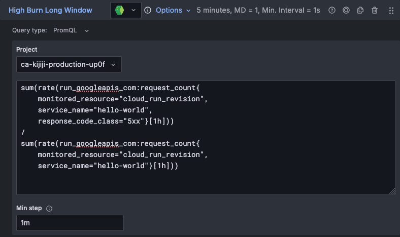

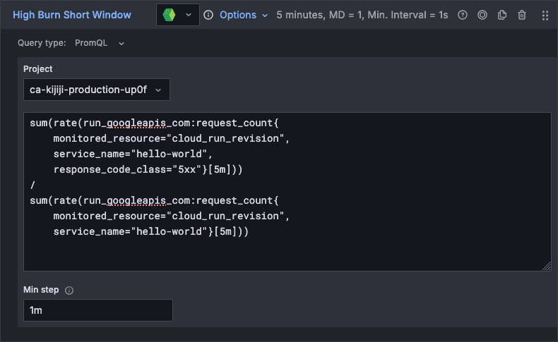

First, are the high-burn queries:
A screenshot of a high burn, long window alert.A screenshot of a high burn, short window alert.

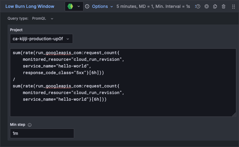

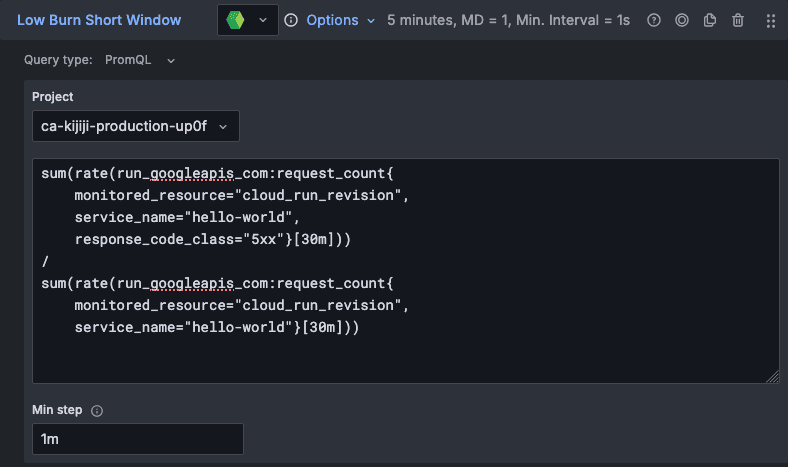

Next are the low-burn queries:
A screenshot of a low burn, long window alert.A screenshot of a low burn, short window alert.

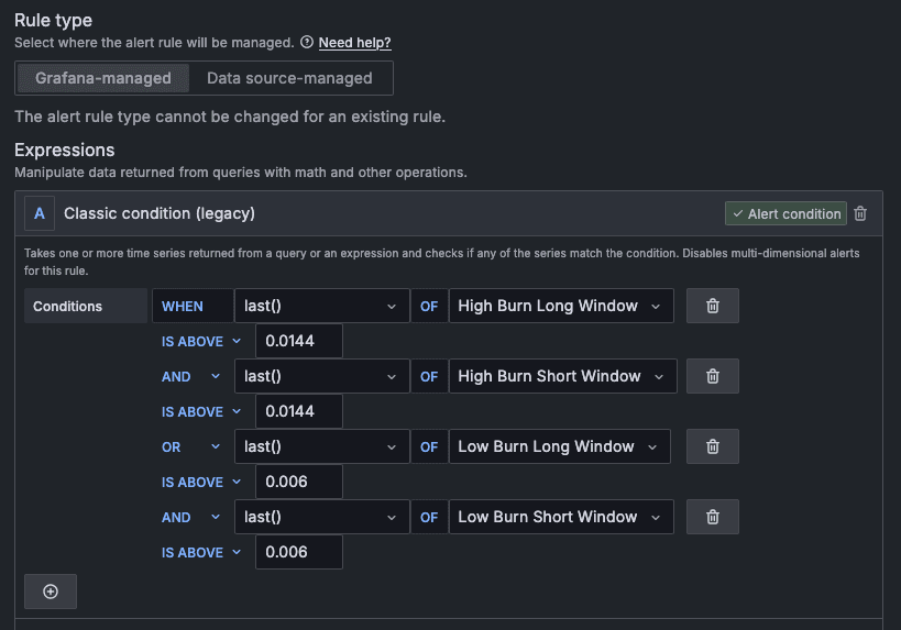

Finally, there’s the alert expression that brings all four queries together:
A screenshot of the alert expression.
Note the four queries calculate the error percentage of the service over different spans of time, while the Classic condition node reduces the four range queries and compares their results against the configured thresholds. Remember: the high and low burn rate thresholds are calculated by multiplying the burn rate by the error budget (like in the PromQL examples above).
The two high-burn queries are evaluated against their thresholds and when both have exceeded their threshold (the boolean AND), the high-burn, multi-window alert fires. The same thing happens for the low-burn queries: they’re evaluated against their thresholds and when both (the boolean AND) have exceeded theirs, the low-burn, multi-window alert fires. The high and low multi-window alerts are combined together with the boolean OR to create the multi-window, multi-burn-rate alert.
