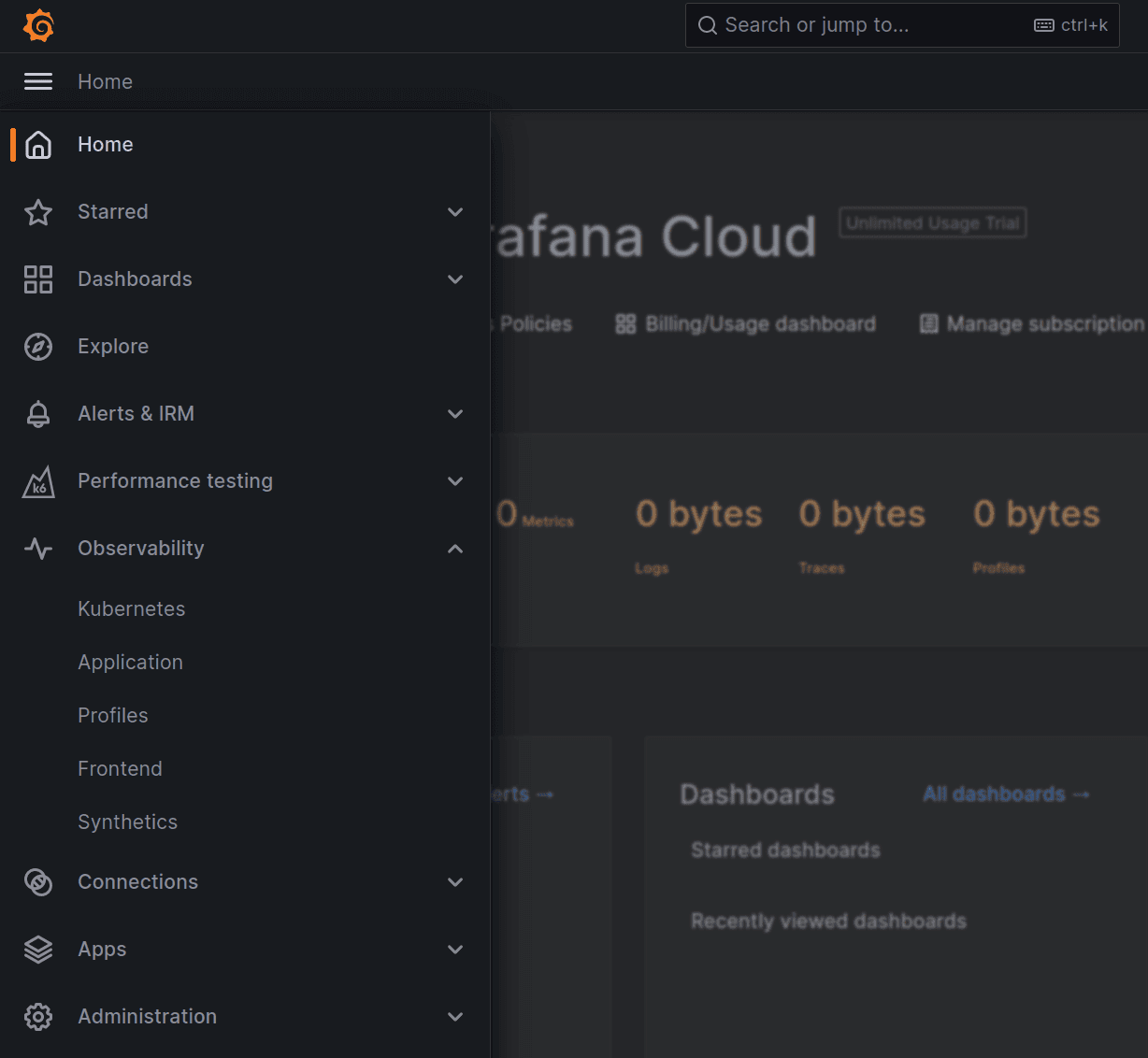

Let’s dive into getting synthetic monitoring installed into our Grafana instance. There are a couple of different ways to run synthetic monitoring, but all methods require a Grafana Cloud account to store the data and function correctly.
In your Grafana Cloud account, open the left-hand navigation bar by clicking on the top left hamburger button, then click on Synthetics under Observability section. Here you can see the homepage, which shows direct access to different dashboards, and options for creatig new checks, view existing checks, or configure alerts. You can also see a summary of your synthetic monitoring usage in the lower part of the page.

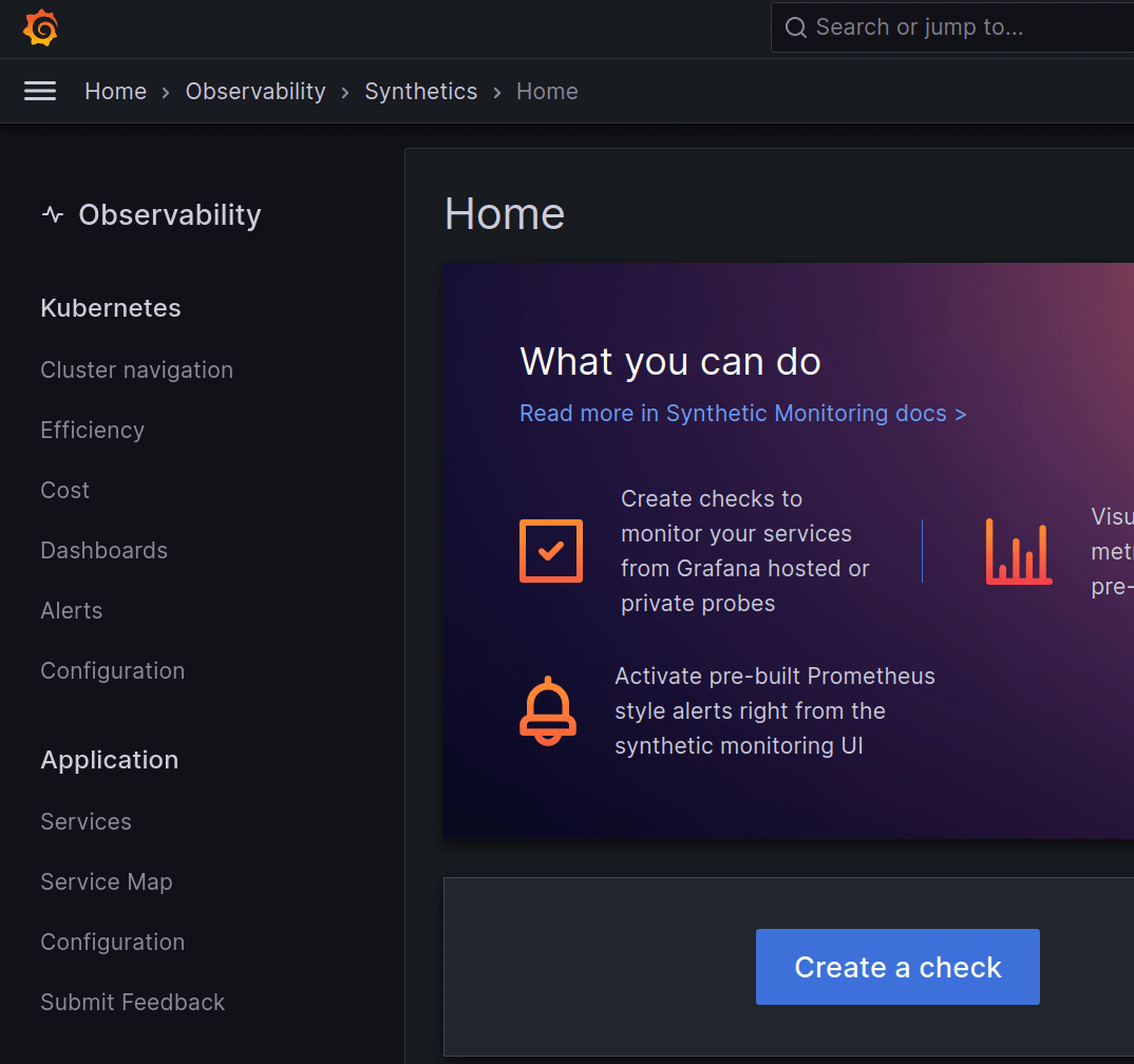

Once synthetic monitoring has been installed into your Grafana instance, it’s time to add a check!
From the synthetics homepage, select the option to Create a check.

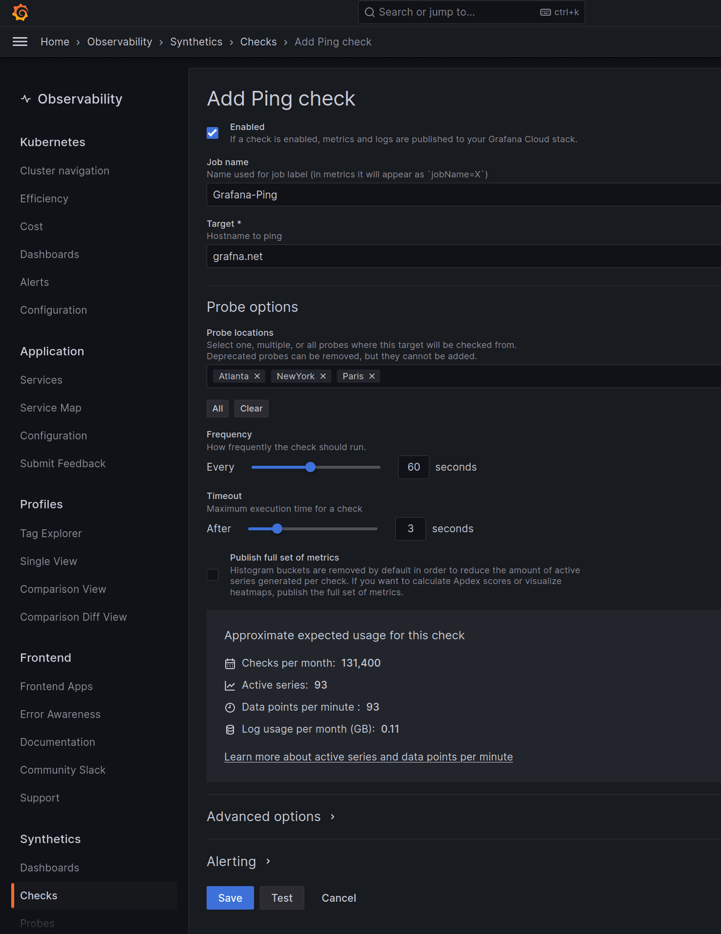

We’re going to add a new ping (also known as an ICMP echo) check, to ensure that our grafana.net server is always available from various locations around the world. Select PING as the check type.
Enter Grafana-Ping into the Job Name field, and then set grafna.net as the Target (this is a deliberate typo, bear with us!).
Now we need to select the location of the probes to use in this check. A probe is one of a number of blackbox agents that are located around the globe, available in a wide range of locations, tasked with carrying out the configured checks on the targets specified. Each probe sends metrics and logs to the synthetic monitoring backend, including such information as target availability and health and response latencies, which are then rendered in the synthetic monitoring dashboard.
For now, select a few different locations for the probes that will send ICMP echo packets (pings) to the grafana.net host. Do this by selecting the Probe Locations menu in the Probe Options section. In the example below, you’ll see we’ve selected Atlanta, New York and Paris. Other locations such as San Francisco, Sao Paulo, Frankfurt, London, Bangalore, SingaporeSydney or Tokyo are also available. See the full list of locations in the public probes docs page.
The Probe Options section allows you to configure how often a check should be carried out, as well as the timeout for it. The timeout will mark a ping check as failed if it does not receive an IGMP echo response within that timeout period.
If you expand the final section, Advanced Options, you’ll note that there are extra configuration options here that allow you to set extra labels on the metrics and logs (which you’ll be able to use in a PromQL or LogQL query as label selectors). You also have the ability to change the Internet Protocol version being used (IPv4, IPv6, or both) and to decide whether or not to set the “Don’t Fragment” bit (only for IPv4).
We’re going to stick with the default options for now and test with IPv4. Your ping check page should now look something like the following:
Embedded image
Finally, select the Save button.

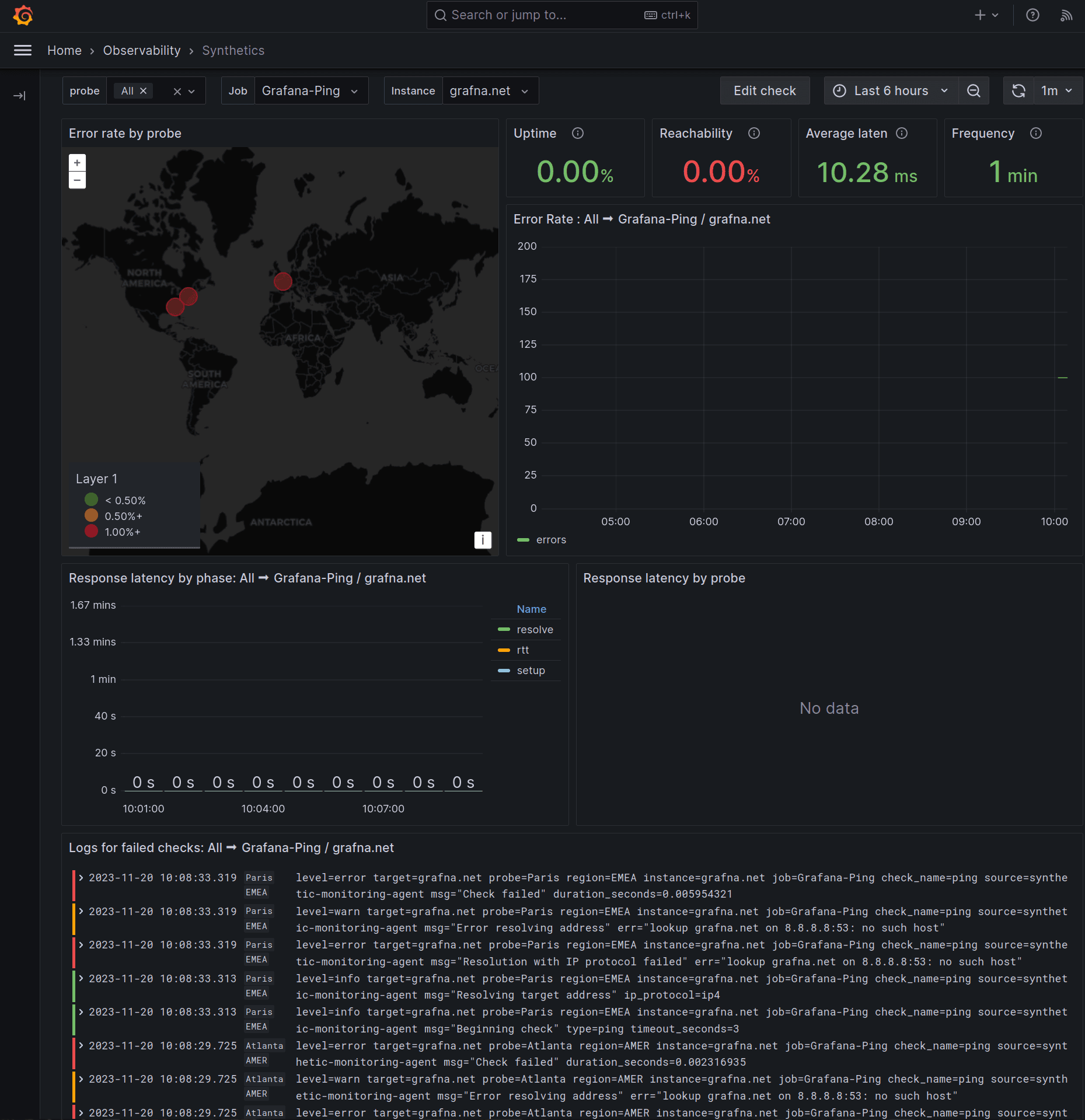

There are some interesting panels here, although a couple of them are empty. This is, as you may have guessed, because the check is currently failing. The Downtime panel shows the locations of the probes that we added for the check. Red shows a failed check from a probe, while green shows a successful check. There’s also a stats panel that shows the Average Latency for the check, the Frequency for it (currently 60 seconds), and the Uptime for the check target.
So why’s the check failing? Well, we actually made a typographical error when specifying the target for the grafana.net server when we configured the check. Take a look at the **Error logs for .*: grafna.net** panel (which includes the target typo). You’ll see a repeated set of errors that look like this:
2021-01-22 17:52:35
level=info target=grafna.net msg="Resolving target address" ip_protocol=ip4
2021-01-22 17:52:35
level=info target=grafna.net msg="Beginning check" type=ping timeout_seconds=3
2021-01-22 17:52:30
level=error target=grafna.net msg="Check failed" duration_seconds=0.000799491
2021-01-22 17:52:30
level=warn target=grafna.net msg="Error resolving address" err="lookup grafna.net on 127.0.0.1:53: no such host"
2021-01-22 17:52:30
level=error target=grafna.net msg="Resolution with IP protocol failed" err="lookup grafna.net on 127.0.0.1:53: no such host"
This shows that the grafna.net target didn’t return an ICMP echo, because it couldn’t be reached (at the time of writing, this host doesn’t exist).

Shortly after changing the target, go back to the dashboard page for the check. Now you’ll be able to see that the check is working correctly, and you’re getting data from all six probes.
