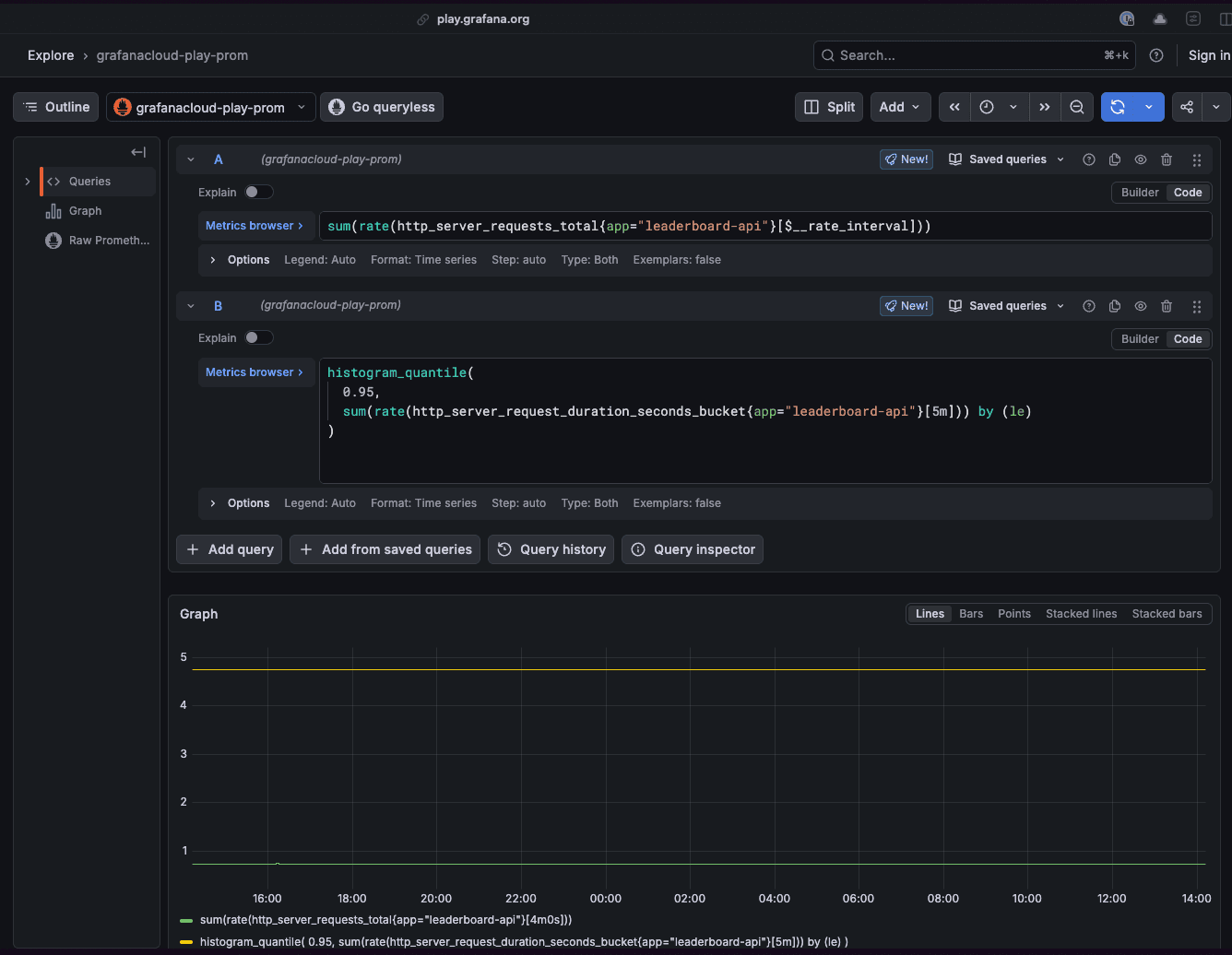

Step 1: Find your actual request rate
Open Grafana Cloud and run this query against your Prometheus or Mimir data source. Swap in your service name:
sum(rate(http_server_requests_total{app="leaderboard-api"}[$__rate_interval]))
Look at this over a representative window. A full week is better than a single day. You're looking for two things:
  1. Your baseline rate during normal operation (requests per second)
  2. Your peak rate, which is the highest sustained load you've actually seen
That peak number is your load test target. Not a guess or just 2x your average, but the actual peak your system has handled (or needs to handle).
If your baseline is 120 req/s and your peak is 340 req/s, you now have real numbers to work with.
Step 2: Get your latency baseline
This becomes your threshold. Run this query to get p95 latency under normal production load:
histogram_quantile(
 0.95,
 sum(rate(http_server_request_duration_seconds_bucket{app="leaderboard-api"}[5m])) by (le)
This value becomes the check in your Grafana Cloud k6 script, for example: http_req_duration: ["p(95)<280"].
Whatever this returns, such as 280ms, that's your threshold. If your load test pushes p95 above 280ms, the test should fail.
Also pull p99 while you're here. A gap between p95 and p99 tells you something about tail latency behavior that will matter under load.
A screenshot of a Grafana Cloud query related to server response rate..

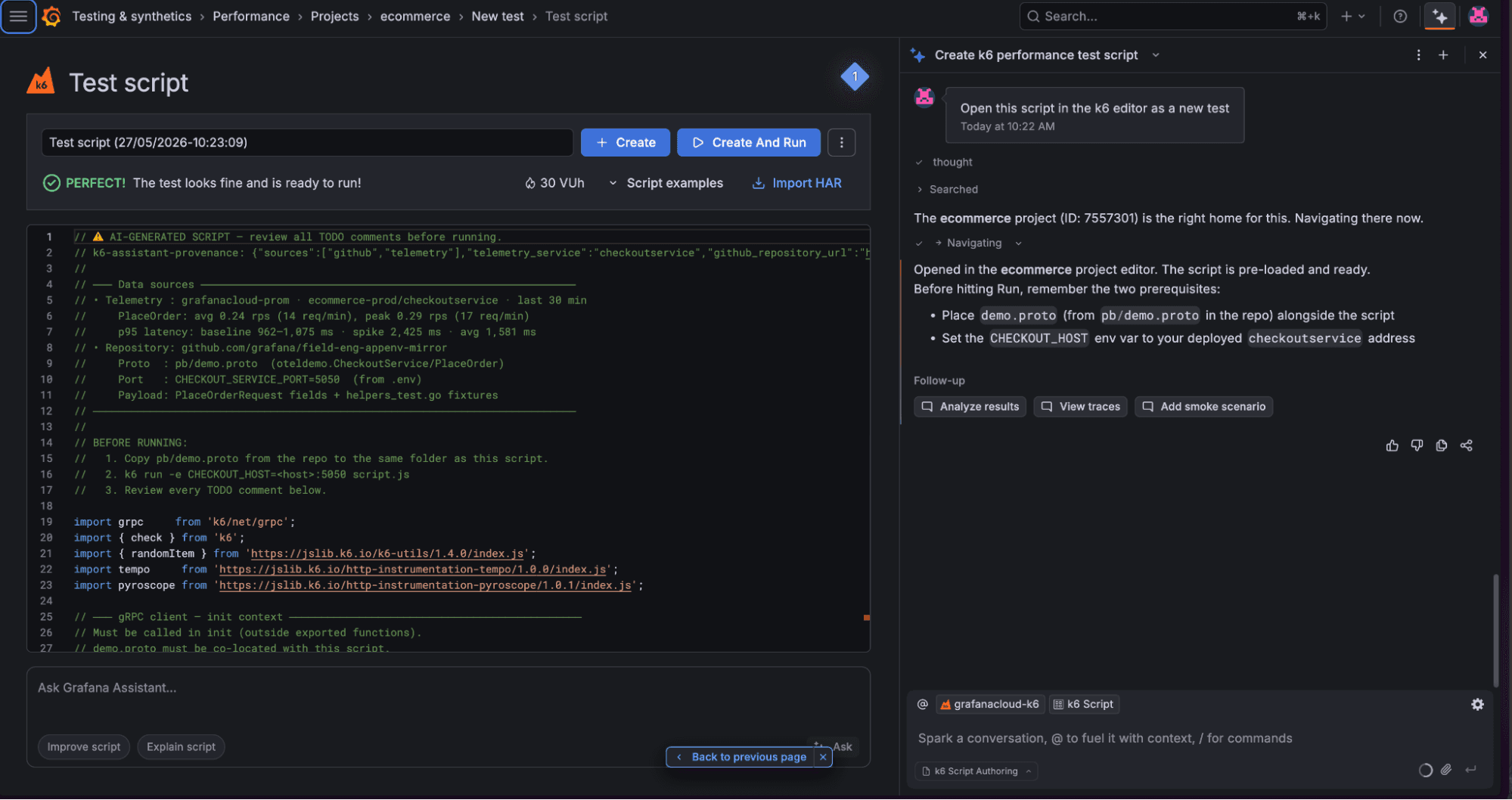

A simpler way: Generate your script with Grafana Assistant
While calculating all the values manually (request rate, p95 latency, stages) provides maximum control and fidelity, there is an easier path to achieving a production-ready script.

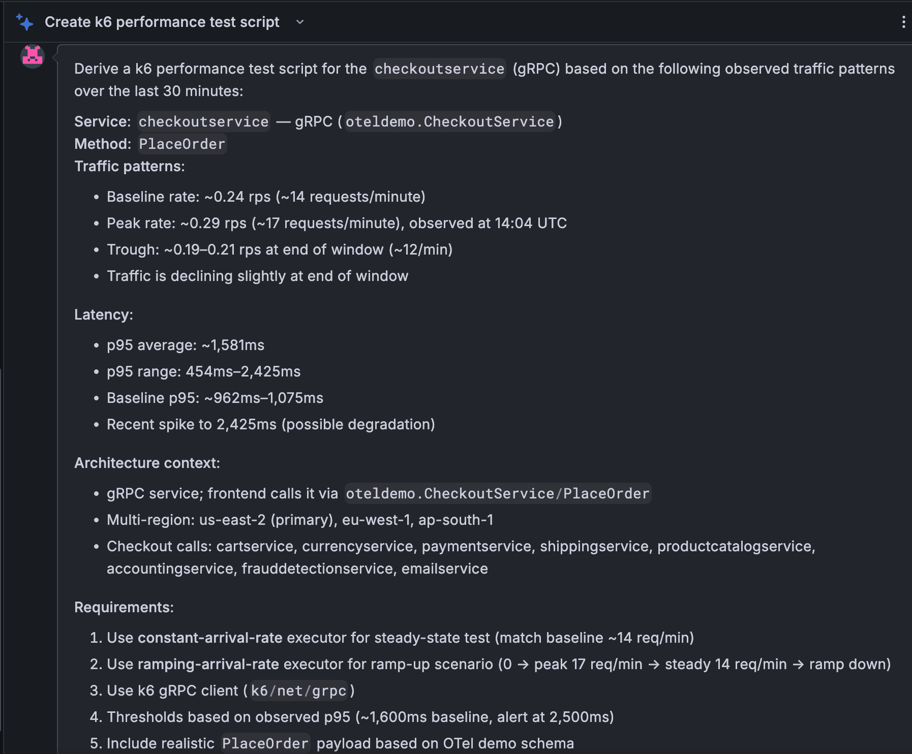

Grafana Assistant, the AI-powered agent in Grafana Cloud, includes a k6 script authoring capability that allows you to generate performance tests using natural language. This feature automates the heavy lifting of performance engineering by programmatically translating production-observed metrics—such as the exact request rates and latency thresholds identified in your panels—directly into a valid k6 configuration. Instead of manually parsing Prometheus queries and hard-coding values into a script, you can simply ask Assistant to derive a test from your service's existing traffic patterns.
Grafana Assistant analyzes your service context, including relevant metrics, logs, and traces, to mirror observed behaviors like morning ramps or evening peaks.
Blog image
By automatically mapping these real-world traffic patterns to k6 arrival-rate executors and defined stages, Assistant significantly reduces manual effort while ensuring higher fidelity to production conditions. This ensures your tests aren't just syntactically correct, but are grounded in the actual pressure your systems face every day.
A screenshot of a Grafana Assistant prompt on the right and the generated k6 test script on the left.
To learn more about k6 script authoring in Assistant, please check out our blog post and technical docs
