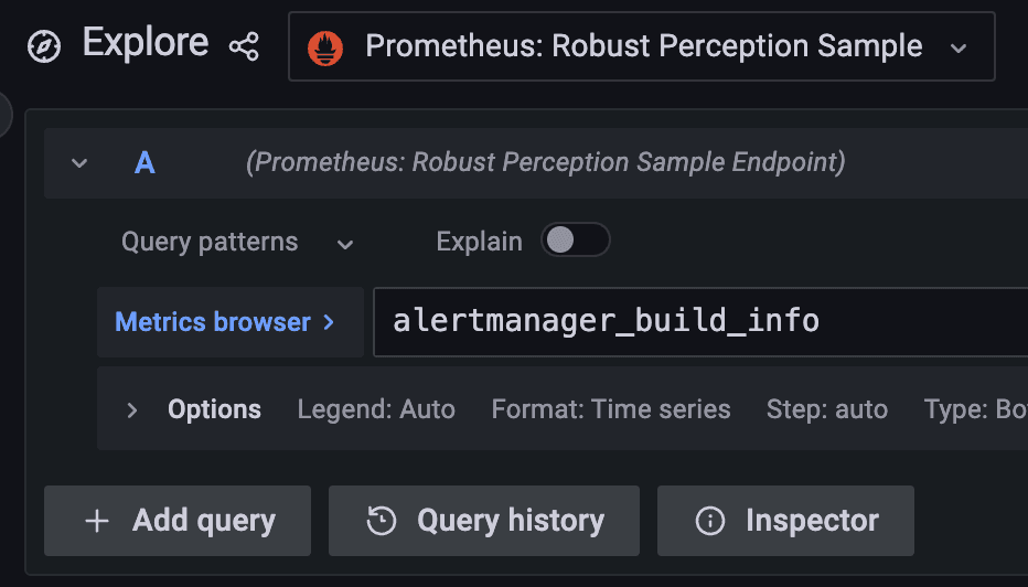

Let’s start with a Prometheus data source. If you go into the Grafana Play dashboard I just mentioned, you can click on the Explore icon. Choose “Robust Perception Sample” from the drop-down menu, search for the alertmanager_build_info metric, and then click Run Query. It should look something like this:
A screenshot of the query results, showing time and value.

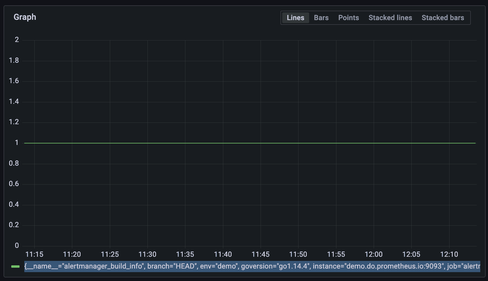

Let’s look at the alertmanager_build_info metric. As you’ll quickly see, the graph is not very useful, because the value is only 1. But if you look at the name of the metric, the number 1 isn’t the point here. All of the useful data is in the labels, where we can see the Alertmanager that’s currently running is a particular git commit from the HEAD branch, running on go1.14.4.
A line graph displays a flat line running at the value of 1.

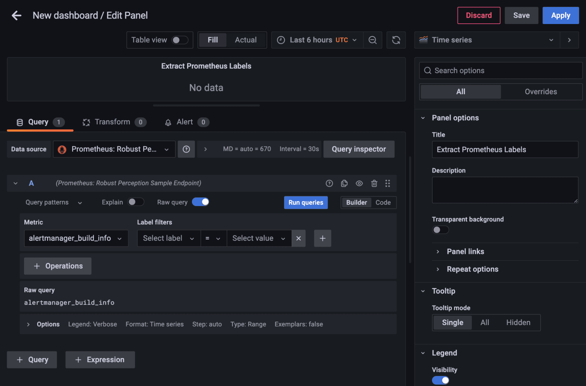

I will then create a new panel, and title it “Extract Prometheus Labels.” Under Data source, I’ll choose the sample data source we were exploring above, and I’ll choose the alertmanager_build_info metric.  If you have your own Grafana instance, you can follow along by picking most any simple Prometheus metric you have.
A screenshot of the new panel being created with the information described above.

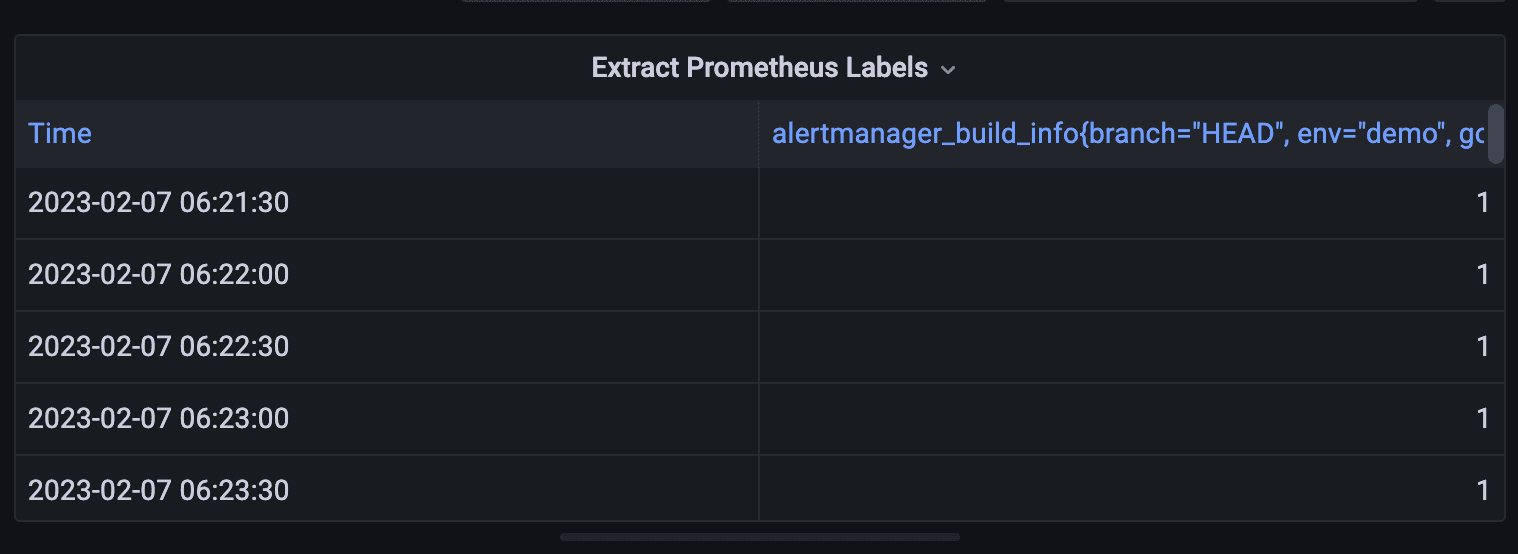

This gets us raw data, but it makes for an ugly table, as you can see below. It only shows us the time and all of the labels combined, so we’re going to need to explore some more options to clean things up.
A screenshot of the newly formed table showing the time and labels.

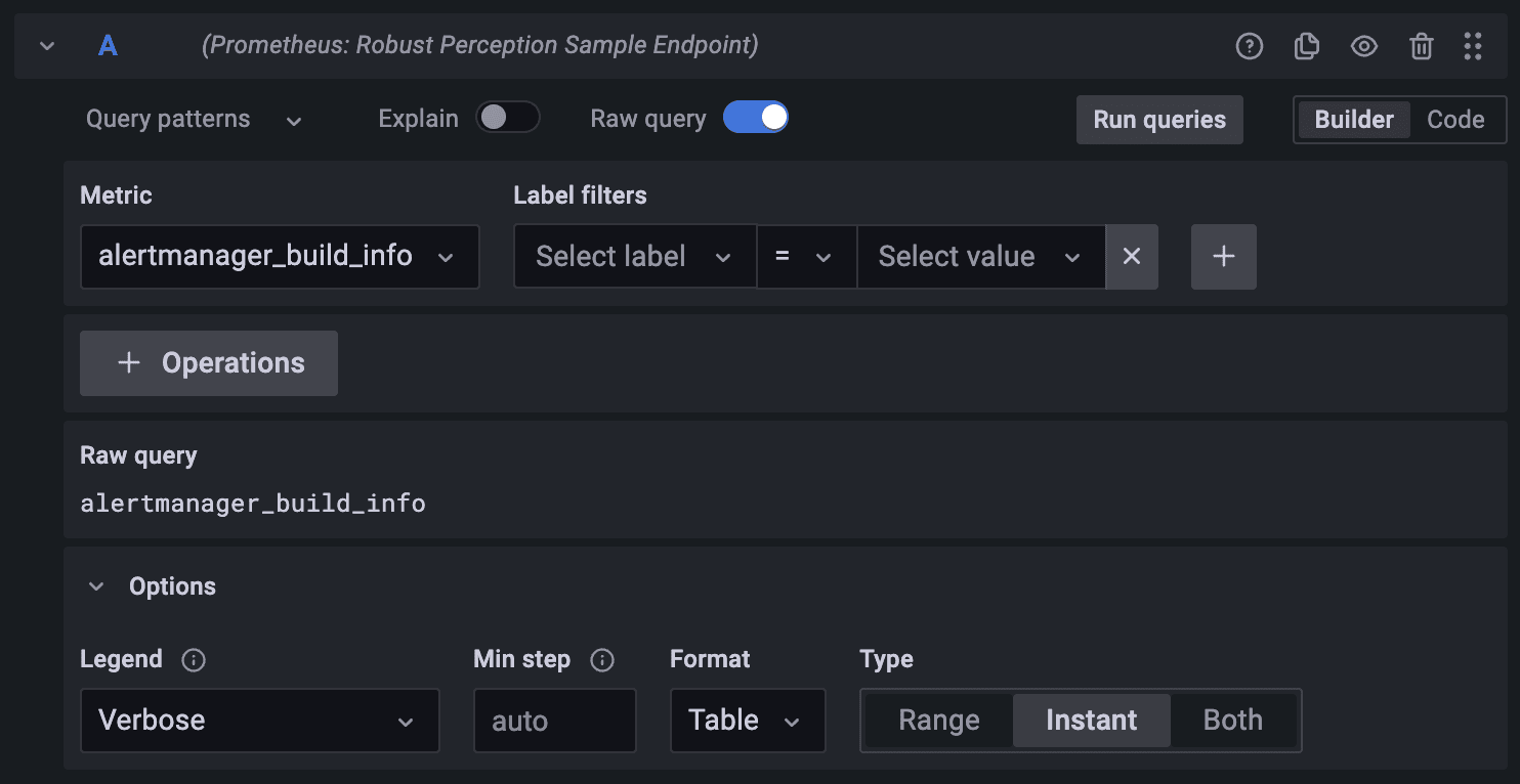

The first thing we’ll do is go into the query section and expand the options. Rather than a time series query, we want a table query, which will split out all of the values individually. Next, we want to select Instant rather than Range. If we are looking to create a panel with the software version, we don’t need a report of the version every five minutes, we only want to see the version that’s running right now. Here’s what those options look like:
A screenshot showing the query being described in the text above.

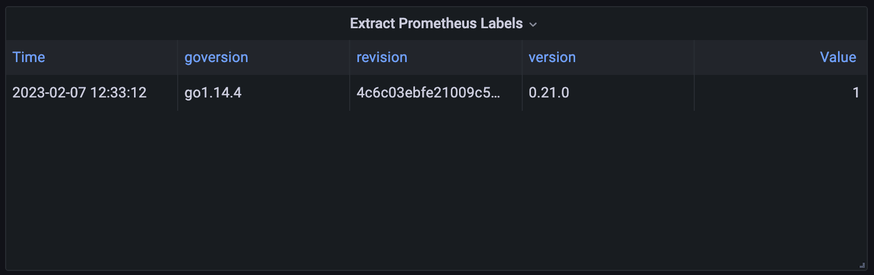

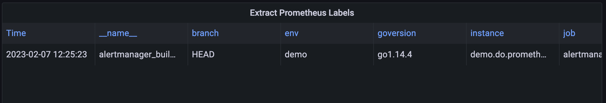

If we save our panel and go back to have a look at it, this is already much improved — a table broken out by label. But we can do better; in the next step we’ll customize which columns are chosen.
A screenshot of the table broken out by label.

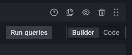

Once you’ve seen this table layout, go back into the panel edit dialog. In the query section, click Code to get into the PromQL view of our metric query, rather than using the query builder.
A screenshot showing the Run queries and Builder buttons in Grafana.

What does this do? The max function takes only the largest timestamp value, i.e., the latest/last observation. The by grouping selects only the columns in the table that we want.
Back on the dashboard, our new panel is already looking better:
A screenshot shows the improved panel.

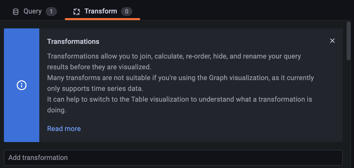

But since we only want to report the version on the dashboard, we don’t need the time of the observation, or the value. How do we get rid of those extra fields? Edit the panel, and right next to Query you will find an option to Transform.
A screenshot of the Transform option, which describes what transformations allow.

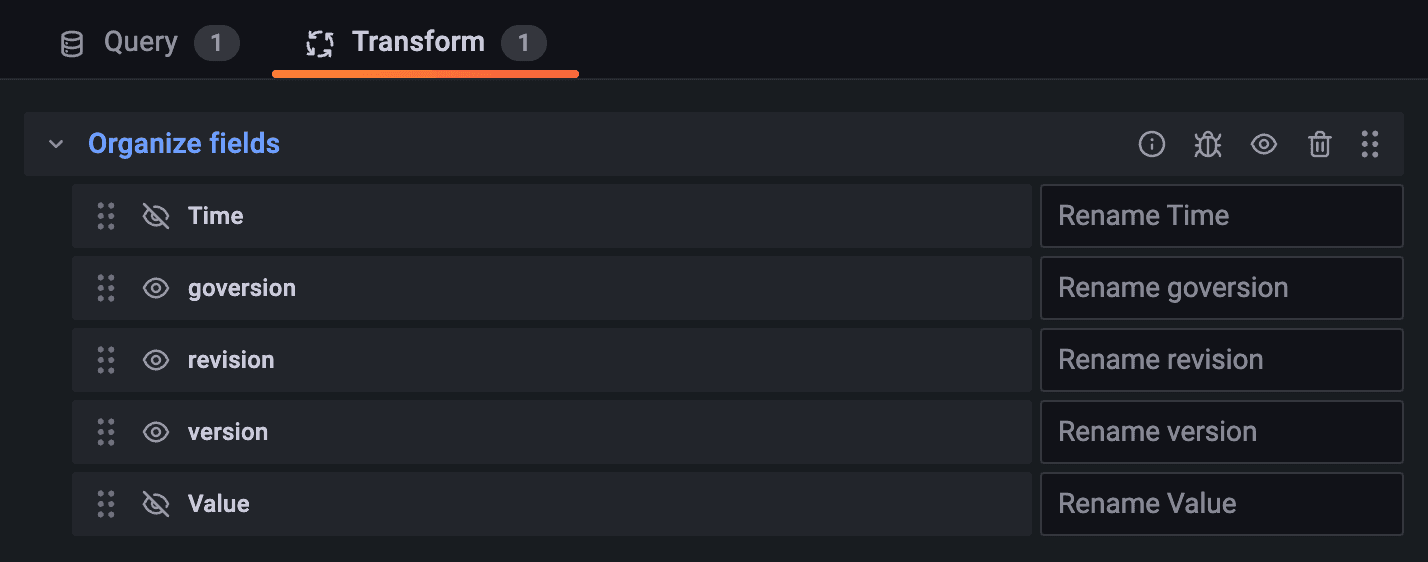

Organize fields with a data transform
Transforms are a powerful way to reshape data. We want to select a transform called “Organize fields.”
A screenshot of the Transform option to organize by different fields.
Notice the eye icons next to the field names. I’ve clicked the one next to Time and Value so those fields are now hidden. If I like, I can also add a new name so the field appears under a different name in the title.

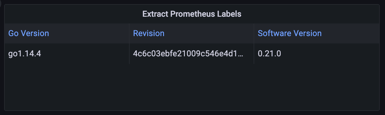

We’re simply transforming the data from the PromQL query by filtering certain columns out. Click Apply and we’re now back to our cleaned up table showing only the fields we like.
A screenshot showing the simplified table showing just the Go version, revisions, and software version.
