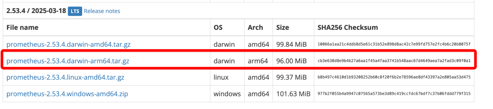

Head over to prometheus.io/download and grab the latest stable release for your operating system. For this guide, we’re using a MacBook Pro with an M3 chip, so we chose the latest LTS arm64 version.
arm64 file highlighted

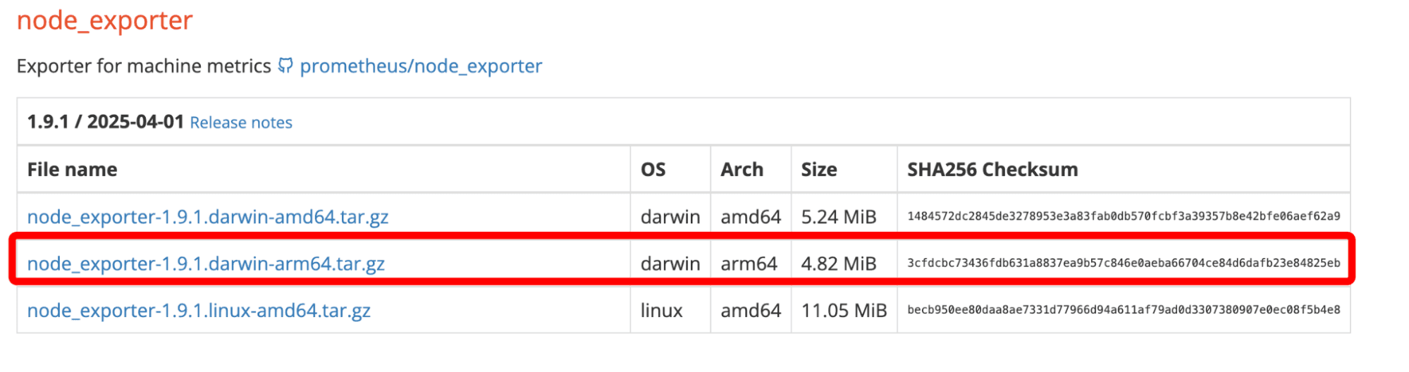

While you’re there, also download node exporter—this tool gathers machine metrics like CPU, memory, and disk space.
Node exporter file highlighted
