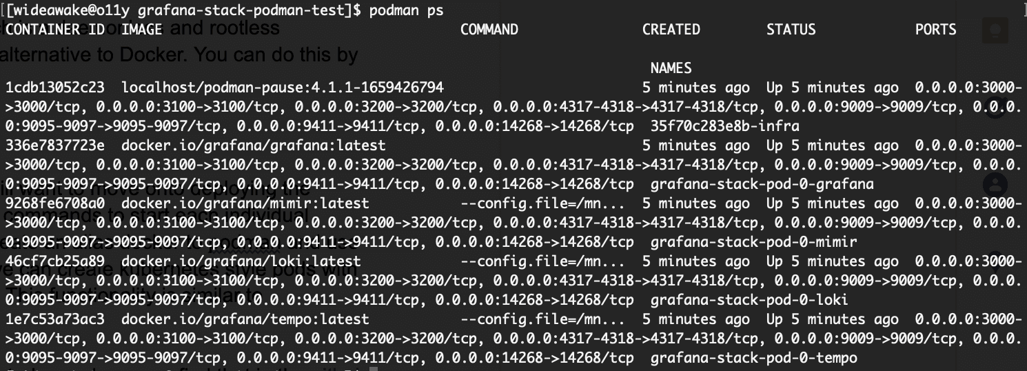

We can verify the pod with all 4 containers is running with this command.
podman ps
If all went well, you should see something like the following in your terminal windows:
Screenshot of successful Podman commands verifying pod is running in containers.

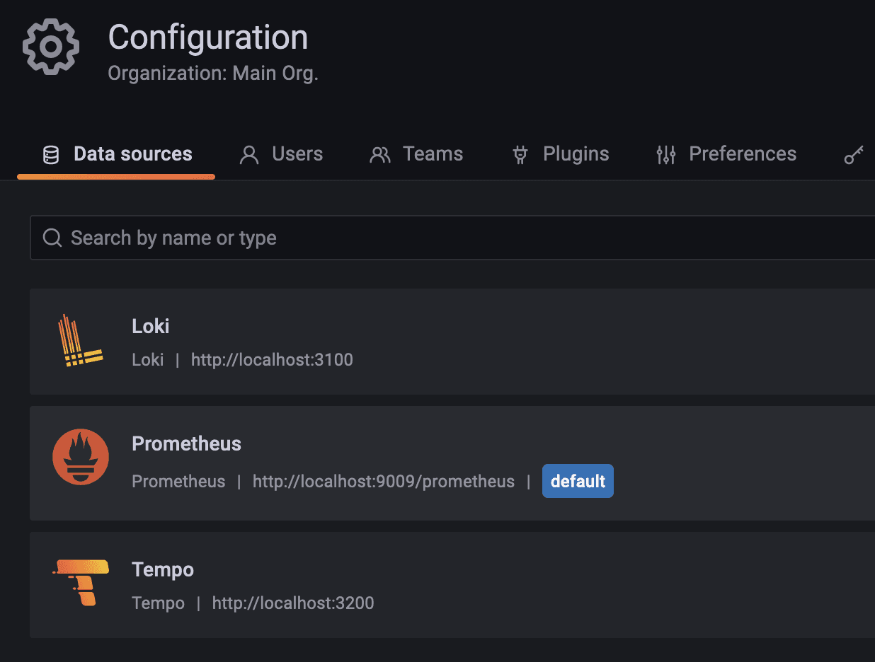

Next up, we want to add our metrics, logs, and traces stores by adding them as data sources. You can do this by clicking the gear icon in the lower left hand corner once logged into Grafana and clicking Add data source. When configuring the Prometheus, Grafana Loki, and Grafana Tempo data sources, you will want to configure them with the ports we exposed and the end result will look something like this.
Screenshot of configuration UI in Grafana.
