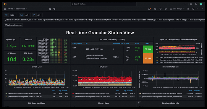

Real-time graunular status view in a Grafana dashboard
Metrics are the most common type of telemetry data used for monitoring systems, but they can quickly get out of hand as your data grows exponentially. Let’s first cover the two most common causes of a high metrics ingestion rate in Grafana: data points per minute (DPM) and cardinality.

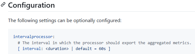

1 DPM is often sufficient for most use cases, and it’s the default setting for most collectors, including the OpenTelemetry Collector, Prometheus, and Grafana Alloy.
Configuration example
Accidental misconfigurations or inherited settings from other systems are the main causes behind accidental spikes and unnecessarily high scrape intervals.

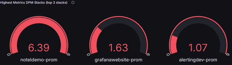

For example, running a fleet of web servers and accidentally setting your scrape interval to 10 seconds (6 DPM) rather than 60 seconds (1 DPM), will mean you’re ingesting 6x the data without added visibility benefits. Adjusting back to 1 DPM reduces both noise and costs by a factor of 6!

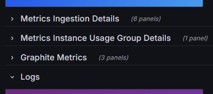

To find your current DPM configuration as a Grafana Cloud user, log into your Grafana instance. (If you don’t already have one, you can sign up for a forever-free Grafana Cloud account today.)  On the left-hand menu select Administration > Cost management > Billing dashboard.
Once you’re in your billing dashboard, scroll down to the metrics section and select the “Metrics Ingestion Details” drop down.
Grafana Cloud UI
Here you will find your current stacks and the DPM they’re running at, which should look something like:
Gauge panel for DPM

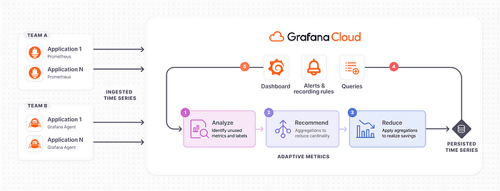

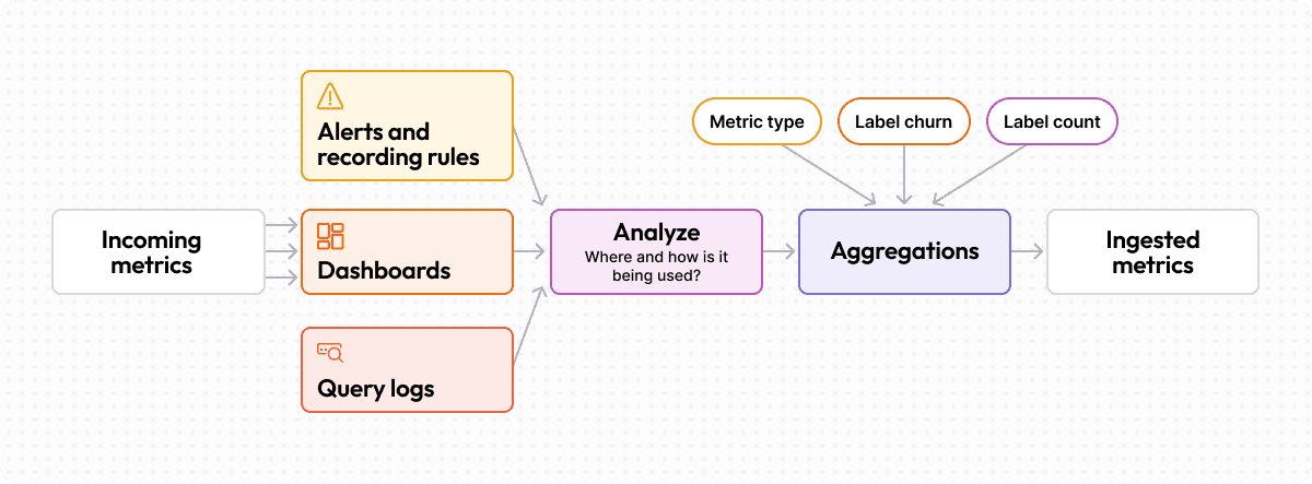

Manually analyzing usage patterns for millions of time series is a challenging and error-prone task. It requires you to examine how metrics are used across dashboards, alerts, queries, and scripts.
That’s why Adaptive Metrics is such a game changer. Unique to Grafana Cloud, Adaptive Metrics analyzes your metric usage and recommends aggregating unused or partially used metrics into lower-cardinality versions of themselves. To date, Adaptive Metrics has delivered a 35% reduction in metrics costs on average for more than 1,500 organizations.
“We carefully watch our metric and cost consumption, and in the past we manually evaluated every metric to identify what to drop, which was extremely time consuming and a tedious process,” says Lydia Clarke, DevOps Engineer at SailPoint. “Grafana Cloud Adaptive Metrics simplified this process for us by generating recommendations curated for our environment, reducing the amount of time spent by half. I wish I had this feature sooner.”
Among those who haven’t used Adaptive Metrics yet, one concern we often hear is: “What if I remove something I need later?” Well, don’t worry — you can toggle the rules and roll back changes on demand. Also, we aggregate the highest cardinality label, while maintaining others, to keep a trace of the metric around it so developers can discover it in the future if needed.
It’s important to note that we’ve specifically built this solution to have no effect on your existing systems. Aggregation isn’t new, but what’s unique here is the ability to honor your usage patterns, meaning no rewriting dashboards, alerts, or previously executed queries.
Review, decide, apply workflow

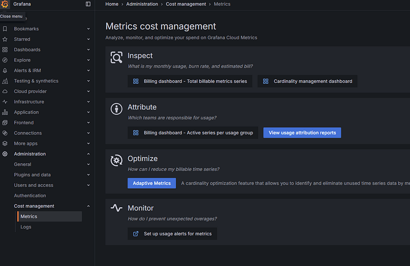

To start optimizing your metrics, it’s as simple as loading up your Grafana instance > selecting the Administration drop down in the left-hand menu > Cost management > Metrics cost management > Adaptive Metrics.
This will give you an insight into all of the current recommendations that you can toggle.

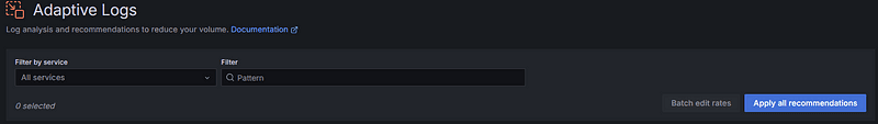

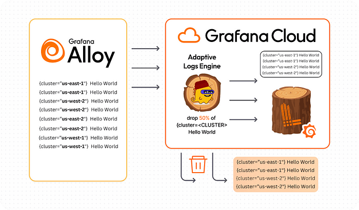

Adaptive Logs
Another game changer! Part of our growing Adaptive Telemetry suite, Adaptive Logs is an AI/ML-powered feature that analyzes observability data at scale to identify frequent log patterns and provide tailored optimization recommendations based on usage. Just like Adaptive Metrics, we recommend dropping telemetry that you aren’t using. (Outside of cost, this also improves system visibility by reducing noise.)
Adaptive Logs workflow
Introduced at ObservabilityCON 2024, users are already seeing the benefits of Adaptive Logs.
“Adaptive Logs helps reduce noise, making it easier to spot valuable logs and ultimately saves us costs,” says Andrew Qu, Software Engineer II at TeleTracking, an early adopter of Adaptive Logs that is already seeing a 50% reduction in log volumes, a leading indicator of potential cost savings.
Finding this solution is easy. Follow similar steps as Adaptive Metrics: load your Grafana instance > selecting the Administration drop down in the left-hand menu > Cost management > Logs cost management > Adaptive Logs).
Adaptive Logs UI

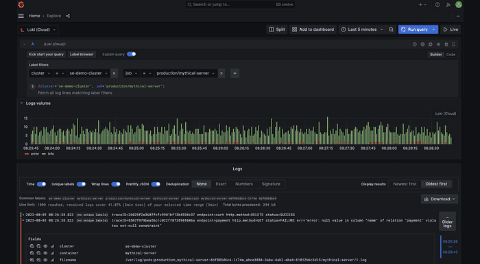

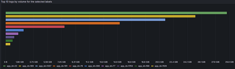

Adaptive Logs are great, but unexpected logging spikes can still cause chaos. Teams often scramble to identify the source (e.g., team, application, container, or namespace), assess whether logs can be reduced, and determine the cause of the spike, such as a new project or service.
Log Volume Explorer offers a read-only view of log volume, helping pinpoint log traffic origins using labels, so you can better understand and manage your logging usage.
This powerful view helps you:
  • Identify teams, environments, clusters, or apps generating the most logs
  • Visualize log volume trends to spot spikes or cost drivers
  • Drill down into specific labels to focus on concerns
  • Optimize retention policies by understanding log patterns, reducing storage costs
  • Spot opportunities to reduce verbosity or trim unnecessary logs

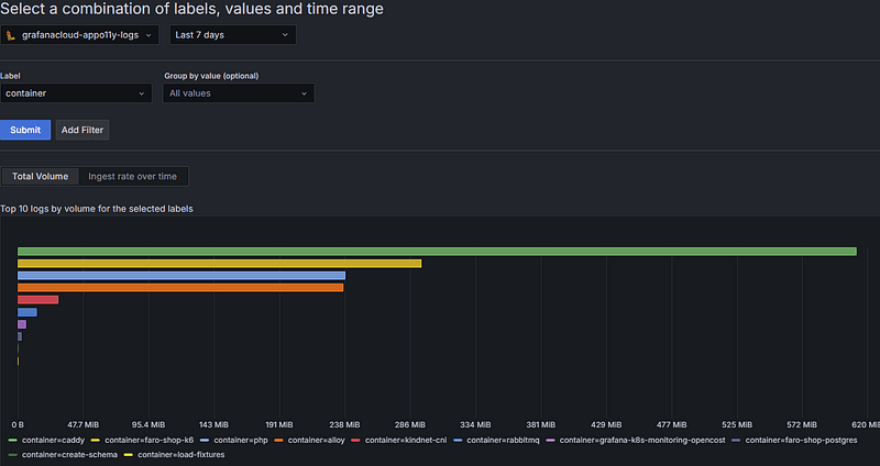

To get started, go to Administration in your Grafana Cloud instance on the left menu, then Cost management > Logs cost management > Log Volume Explorer.
Let’s say you want to find which service is responsible for the highest log volumes in your environment trailing the past week. In Log Volume Explorer, select the logging instance you want to explore, then choose “last 7 days” from the time range selector > choose the service_name label from the dropdown menu > Select “a group by value” (optional) > Submit.  Magic!
Top 10 logs by volume panel
