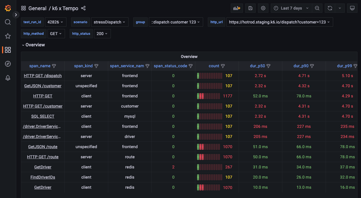

Grafana dashboard showing overview of traces during performance testing.

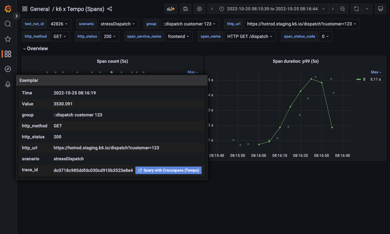

The collected tracing data is aggregated to generate real-time metrics such as frequency of calls, error rates, and percentile latencies that help users narrow their search space and quickly spot anomalous behavior. Further, users can query these trace-based metrics with PromQL or use the attached exemplars to jump from the metrics to a relevant trace to perform a root cause analysis, leading to quick resolutions to performance issues.
Grafana dashboard showing spans in k6 x Tempo.
