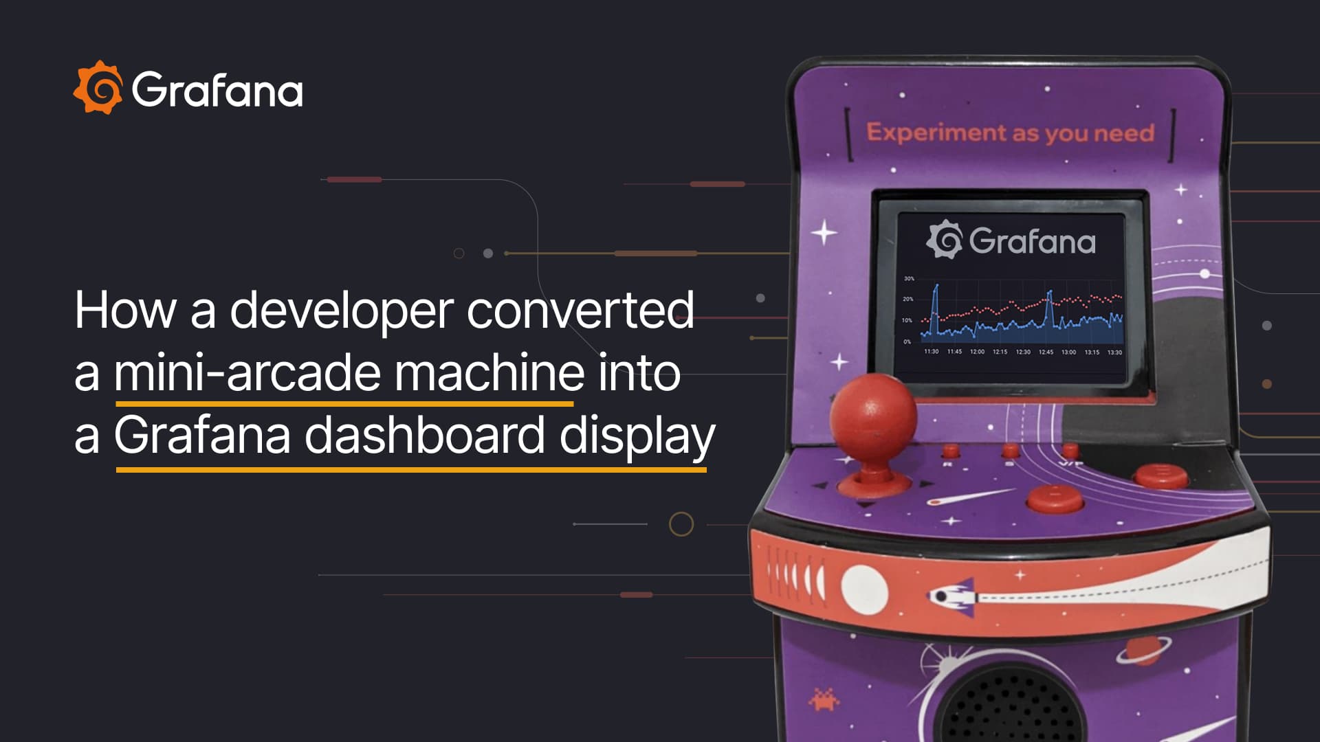

“I looked around my desk and I thought, ‘I really miss having this extra monitor just for Grafana,’ especially at this crucial time for this new service,” Mevorach said. “And I noticed that I have this mini-arcade machine branded from Wix Engineering that we got from one of our internal conferences.”
Mevorach had a self-described “eureka moment” looking at the arcade machine’s tiny screen. What if he could convert it to a Grafana monitor? It seemed unrealistic, but he went with his initial instinct anyway, especially because he knew coworkers had the same arcade devices sitting at their desks. He got approval to return to the office to pick up the machines and went to work. “They were fine with me taking some of their machines home and tearing them apart just to see if I could kind of guess my way through how they work,” Mevorach said.

Decorative imageAfter figuring out how to use the Grafana API to render graphs to the screen’s display-driver, the final step was using a soldering kit to wire the components together. Watching YouTube videos walked him through how to build his physical dashboard machine.
Ultimately, he got his mini-arcade display up and running to keep that extra eye on the Grafana dashboards.The entire process of his first-ever electronics hacking project “took a few weeks but it was very rewarding,” Mevorach said. And it won’t be his last, either. “I think it would be really cool to have something battery-operated or solar-powered and still be able to see graphs.”
