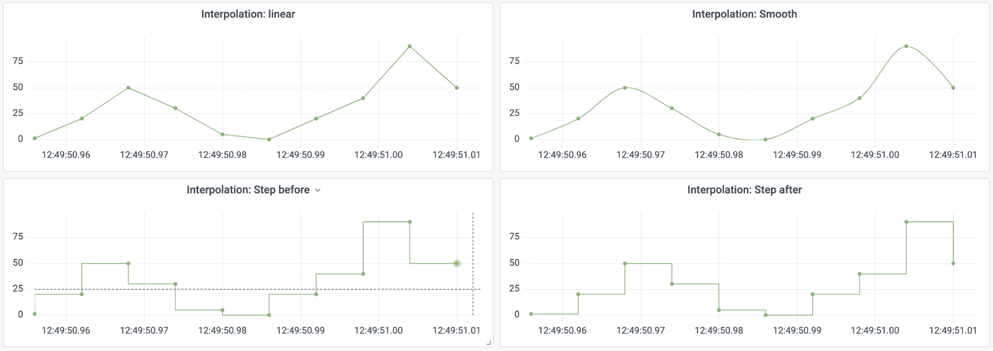

Line interpolation modes
The new option introduces the possibility to render the line with an interpolation mode of your choice. Smoothing (feature request) and the control of the stepped line (feature request) are the new additions to the graph visualizations that address popular community feature requests.

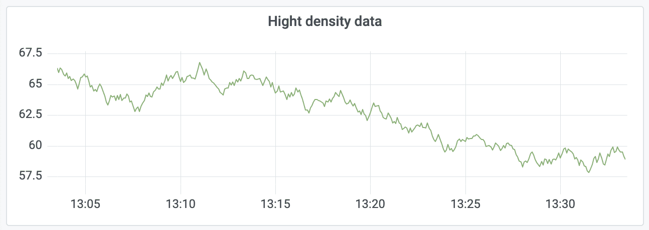

Auto point density
The Show points option enables control over the data points’ visibility. With this option set to “Auto,” Grafana will optimize the points’ display based on the number of data points in the visualization. If the density is too big, Grafana will hide the points by default, and when the visualization is zoomed in, the points will start showing up.
High-density data:
High-density data zoomed in:

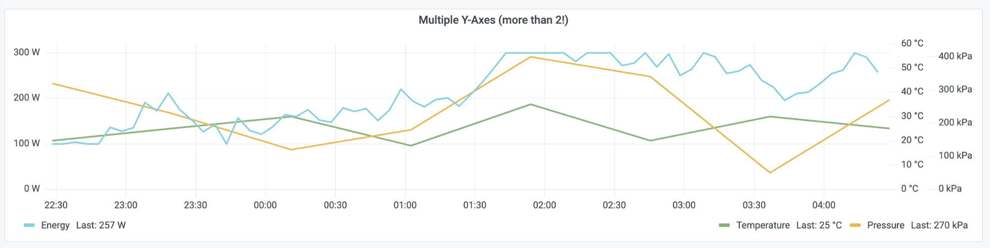

Multiple y-axes and y-axis ticks value mappings
Thanks to using the new panel architecture, the Time series panel integrates seamlessly with the value mappings and unit configuration, enabling multiple y-axes (feature request) with position control as well as custom y-axis ticks based on the series value.
Multiple y-axes: Each unique unit gets its own y-axis, and the position of that axis can be set to either the left or right.

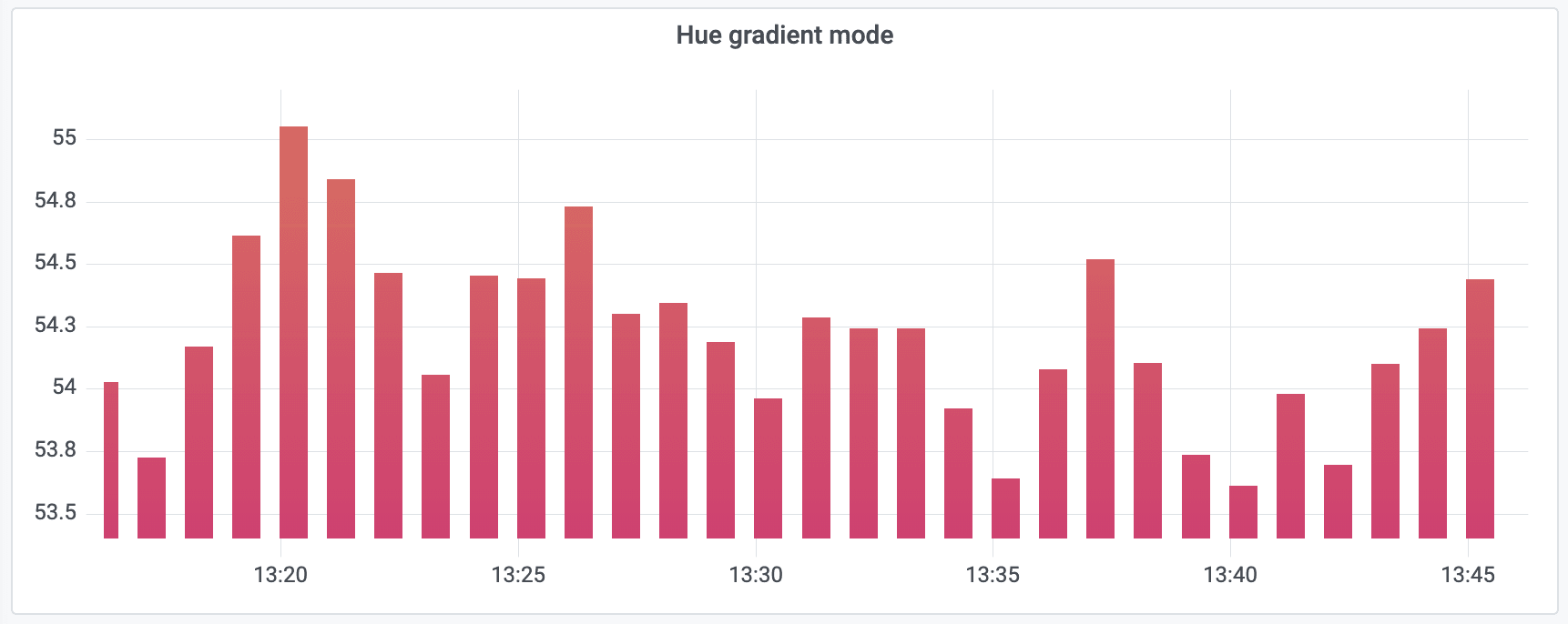

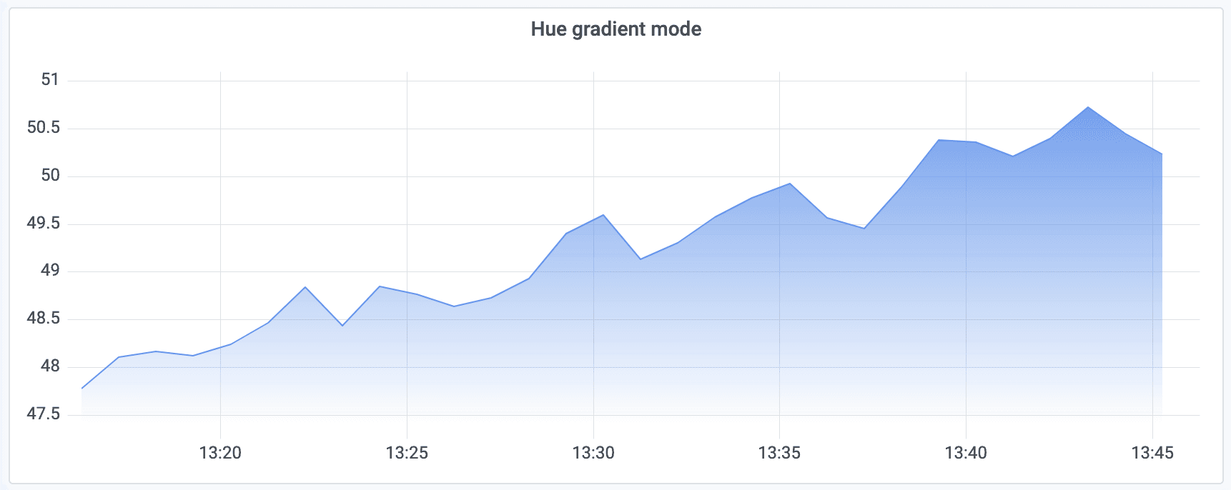

Gradient fill modes
There’s a new option to control the gradient type of the visualized data, which helps users create even more beautiful graphs in Grafana.
Hue gradient fill:
Opacity gradient fill:

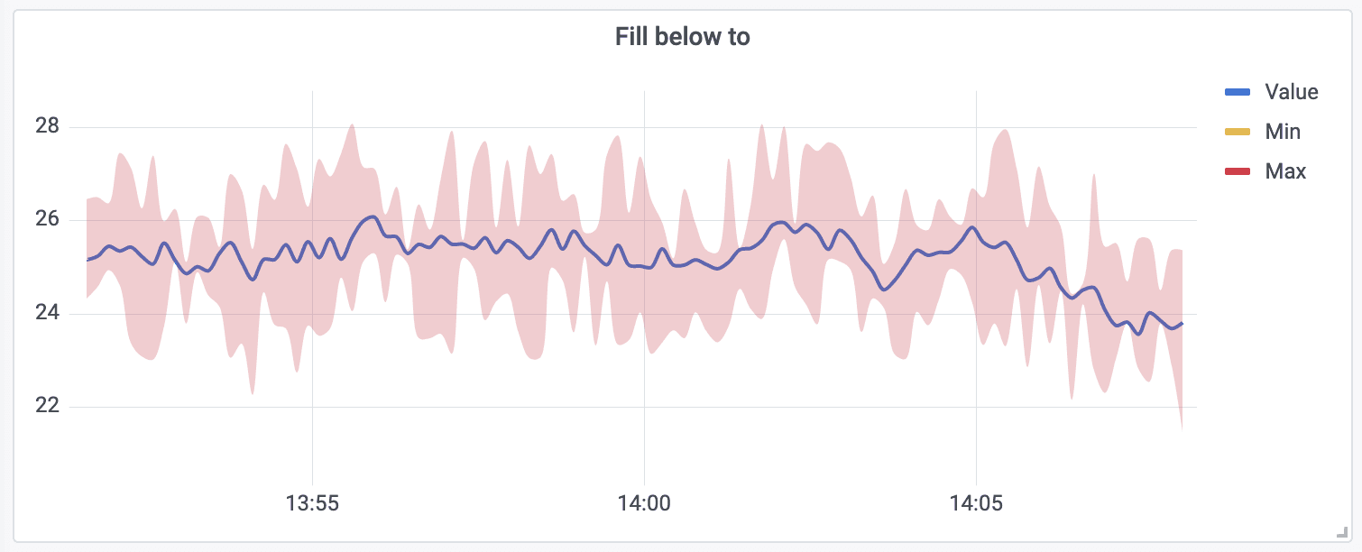

Bands support
A new option, Fill below to, available as a field option override enables easy bands configuration.
