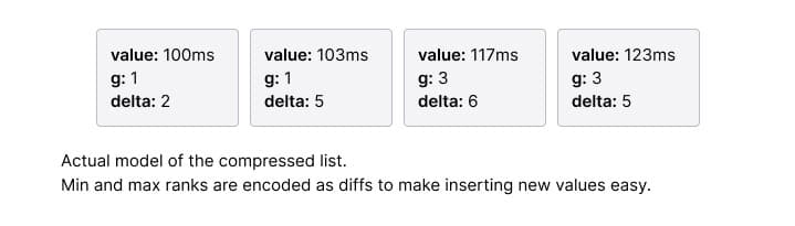

Therefore, the CKMS algorithm stores deltas instead of absolute values:
  • g: The difference between the minimum rank of this sample and the minimum rank of its predecessor.
  • delta: The size of the interval, i.e. maximum possible rank minus minimum possible rank.
With that encoding, the list of samples above looks like this:
Embedded image
Using that representation, we can insert new samples without updating the existing ones in the list.
We can easily calculate the minimum possible rank of a sample by adding its g value to the sum of g values of all predecessors in the list. The maximum possible rank is the minimum plus delta.

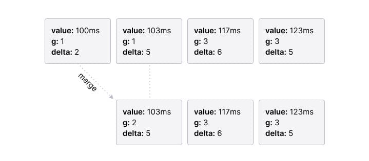

The compress function scans the list and merges adjacent nodes when this does not violate the error function. The merged node is initialized as follows:
  • value: The value of the right node, discarding the value of the left node.
  • g: The sum of the g’s of the left and right node. As we took the value of the right node, the difference between the minimum rank of the merged node and its predecessor is the sum of the minimum distances of the merged nodes.
  • delta: The delta of the right node.
Here’s an example of merging the first two nodes:
