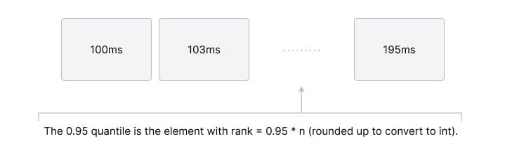

Given a complete sorted list of observations, it is easy to find the quantile. For example, if you are looking for the 0.95 quantile, you just need to take the element with rank = 0.95*n (i.e., the element at position 0.95*n rounded up to convert to int).

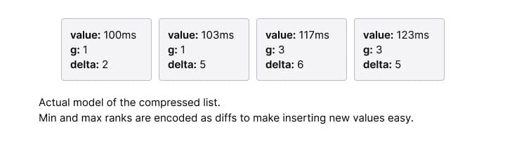

Therefore, the CKMS algorithm stores deltas instead of absolute values:
- g: The difference between the minimum rank of this sample and the minimum rank of its predecessor.
- delta: The size of the interval, i.e. maximum possible rank minus minimum possible rank.
With that encoding, the list of samples above looks like this:
Using that representation, we can insert new samples without updating the existing ones in the list.
We can easily calculate the minimum possible rank of a sample by adding its g value to the sum of g values of all predecessors in the list. The maximum possible rank is the minimum plus delta.

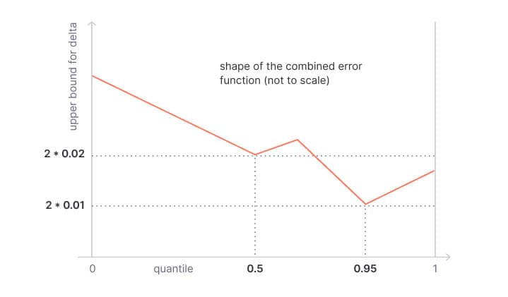

The CKMS algorithm defines an error function that keeps a strict upper bound on the target quantile, but relaxes the error margin the more you go to the left or the right.
The figure above shows the error function with 0.95 as the target quantile and 0.01 allowable error. That means, the actual result will be between the 0.94 quantile and the 0.96 quantile.
Here’s another example: It shows the error function with 0.5 as the target quantile (the median) and 0.02 as allowable error. That means, the actual result will be between the 0.48 quantile and the 0.52 quantile.
Interestingly, you can keep track of multiple quantiles by combining these functions.
Summary.build("name", "help message")
.quantile(0.95, 0.01)
.quantile(0.5, 0.02)
.register();
The combined error function guarantees a 0.5 quantile with allowable error 0.02 and a 0.95 quantile with allowable error 0.01.

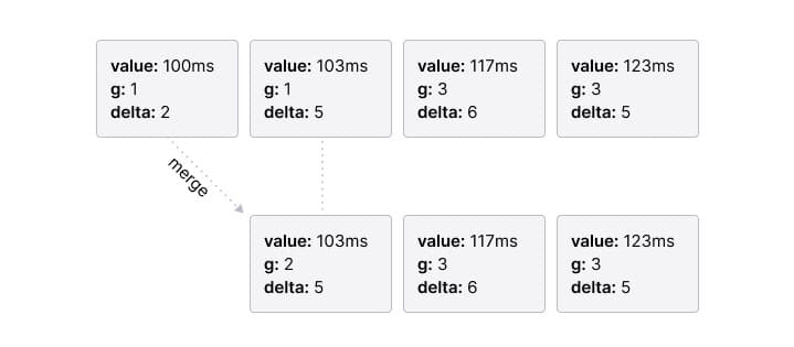

The compress function scans the list and merges adjacent nodes when this does not violate the error function. The merged node is initialized as follows:
- value: The value of the right node, discarding the value of the left node.
- g: The sum of the g’s of the left and right node. As we took the value of the right node, the difference between the minimum rank of the merged node and its predecessor is the sum of the minimum distances of the merged nodes.
- delta: The delta of the right node.
Here’s an example of merging the first two nodes:

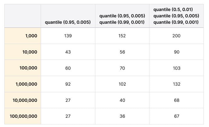

The compression rate is mind-blowing. I inserted between 1,000 and 100,000,000 random values and repeated this with tracking one, two, and three quantiles. The number of samples in the compressed list at the end of each run remained well below 100 in most runs, and it did not increase with the increased input size.
I used the client_java implementation for the evaluation, the source code for the evaluation is here.
