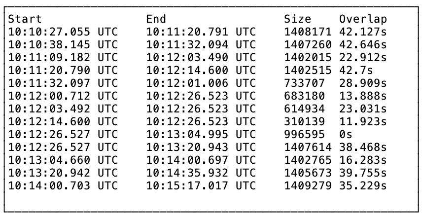

Example: Chunks get synced at 10:12:26.523 and desync right after. Why? We are not quite sure yet.

Embedded image

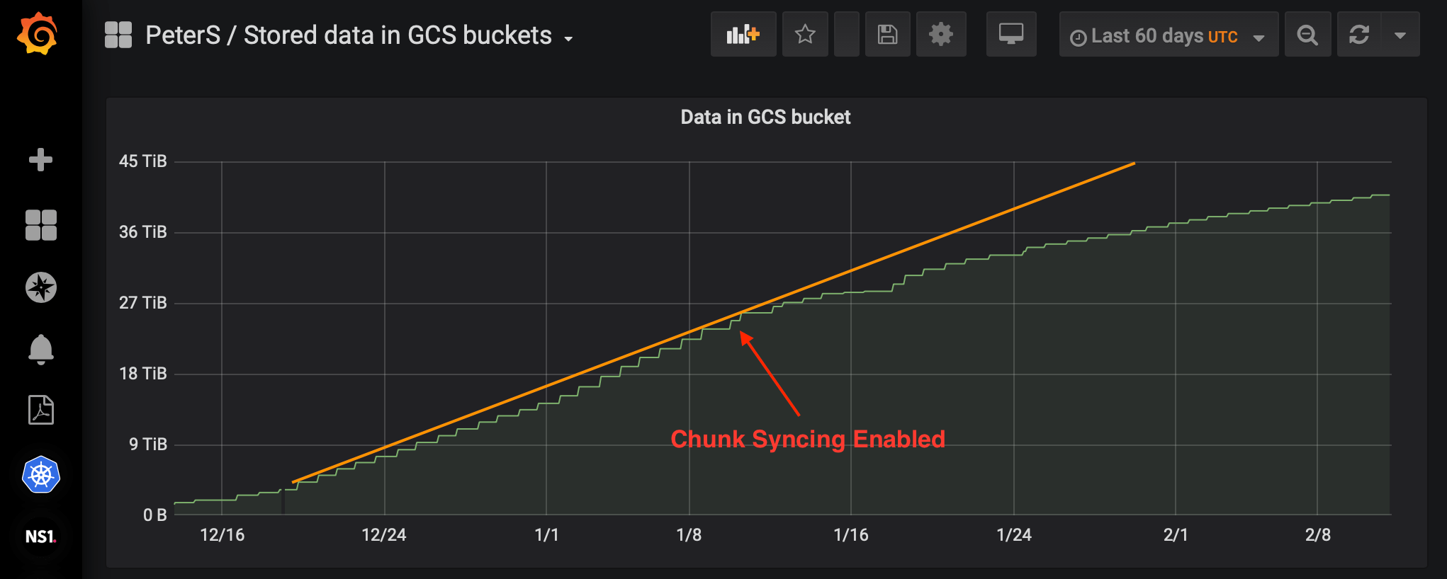

Even with this basic idea, we can see nice benefits already. For logs stored from one of our clusters in a two-hour period at the beginning of February, we can see storage use decrease to about 1.2x of what’s required (previously closer to 3x), with 160 percent time overlap between chunks on average (again, previously 300 percent).
