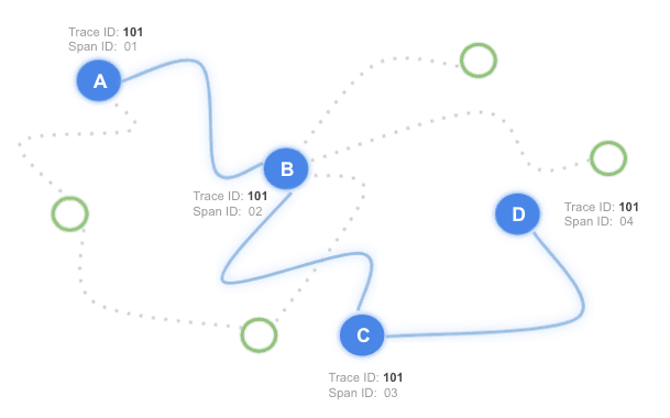

In order to be able to debug quickly, you need to mark the request with a unique ID. The mark is called Trace ID. And all the elements involved in the request, add another unique ID called span.
At the end of the road, you are able to filter out the exact set of traces involved in the request which produced the issue.
Embedded image
And not only that. You can also draw all this in a visualization to easily understand the pieces which compose your system.

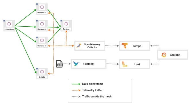

This will be your architecture:
Embedded image

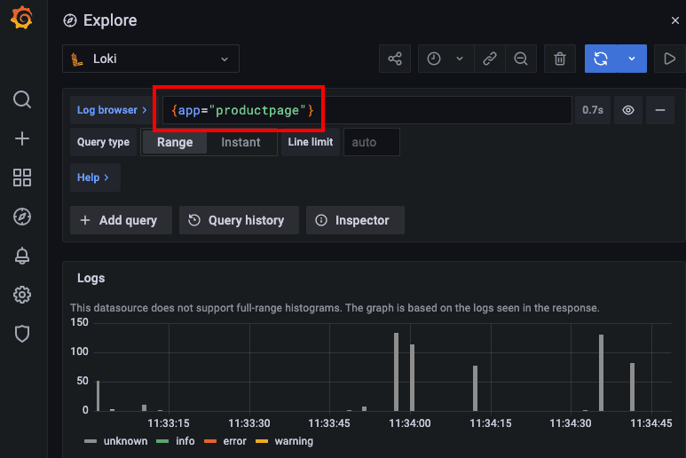

You are prompted to the Explore tab. There, you can select Loki to be displayed on one side and then click on split to choose Tempo to be displayed in the other side:
Embedded image
You will see something like this:
Embedded image

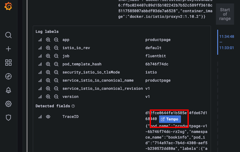

Refresh (hard refresh to avoid cache) the page several times until you can see traces coming into Loki. Remember to add the filter to ProductPage to see its access log traces:
Embedded image

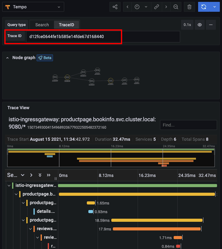

Click on the log and a Tempo button is shown:
Embedded image

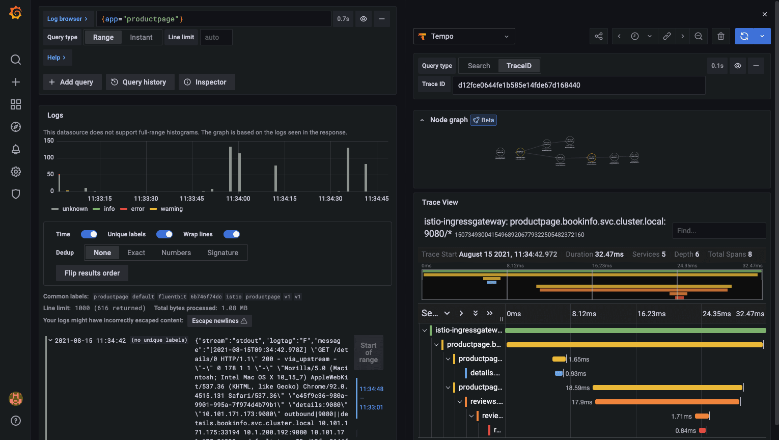

Immediately, the TraceID will be passed to the Tempo dashboard displaying the traceability and the diagram:
Embedded imageEmbedded image
