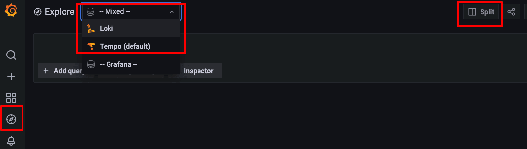

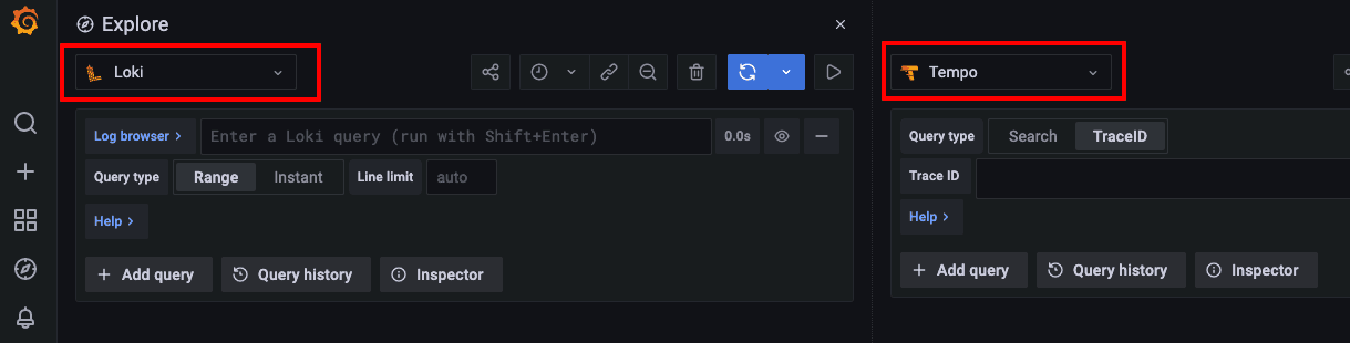

You are prompted to the Explore tab. There, you can select Loki to be displayed on one side and then click on split to choose Tempo to be displayed in the other side:
%3Aquality(100)%2F&w=3840&q=75)
You will see something like this:

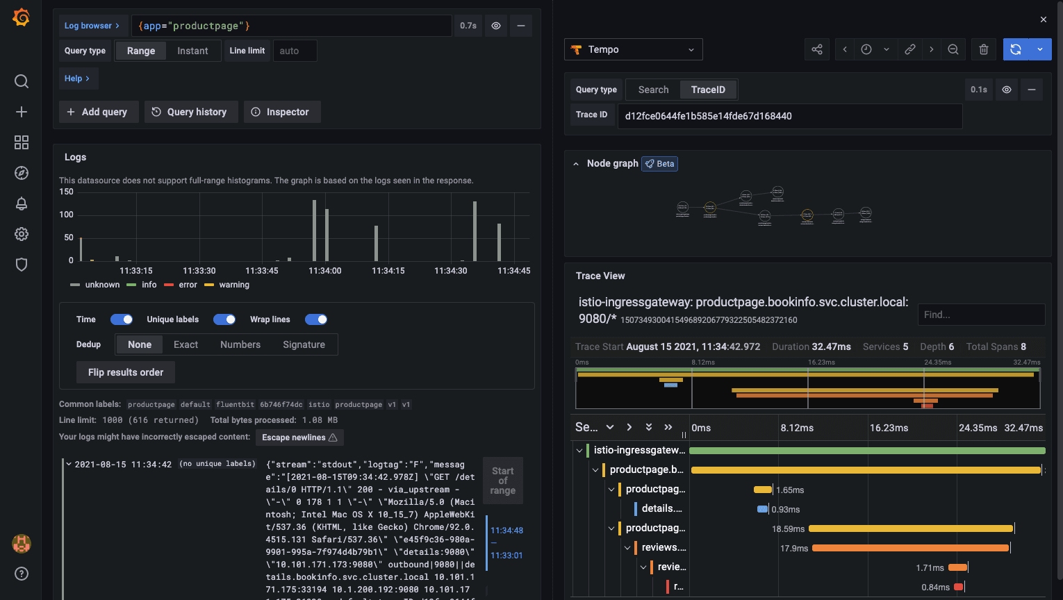

Refresh (hard refresh to avoid cache) the page several times until you can see traces coming into Loki. Remember to add the filter to ProductPage to see its access log traces:

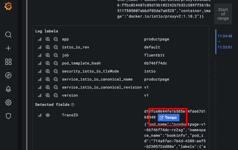

Click on the log and a Tempo button is shown:

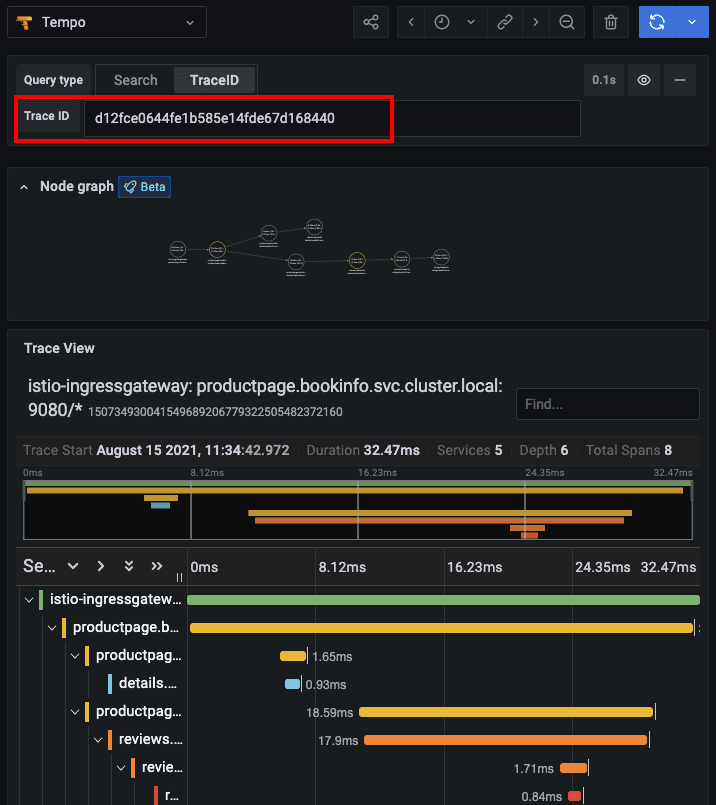

Immediately, the TraceID will be passed to the Tempo dashboard displaying the traceability and the diagram:
