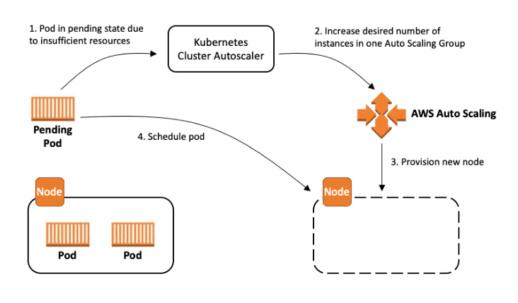

CA works by scaling Kubernetes node groups up and down. It watches for pending pods that cannot fit onto the existing nodes, and it will provision new nodes for them to land on, according to the node groups definition and their underlying Auto Scaling Groups.
An architectural diagram for Cluster Autoscaler
AWS allows you to define a diverse range of instance types for your node groups. However, if you list multiple types for your group, CA will only run calculations for one of them in order to determine how many nodes it needs to scale up. It will then request that many instances to AWS, but you have no control over which instance types you’re actually getting. You may end up with capacity that does not match your actual needs, leading to more readjusting.

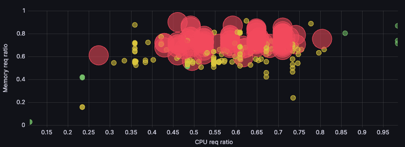

This was the issue that put the nail in the coffin for us. We were keeping track of our clusters’ combined memory and CPU utilization ratio, and our AWS clusters were falling way behind the performance of the clusters we were running on other cloud providers. This meant we were burning cash, with some of them reaching north of 40% idle ratios!

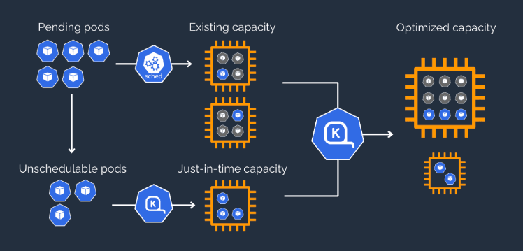

Karpenter is a huge paradigm shift. It brings up nodes just in time, using what it calls provisioners and node templates. It leaves behind the idea of predefined node groups, which we wrote as Terraform code, and it uses Kubernetes constructs instead. The idea is that Karpenter’s provisioners act as a set of requirements that a node conforms to. Unschedulable workloads are then matched with those provisioners, which select the optimal nodes for them to run on and spin them up.
Karpenter architectural diagram
This intelligent capacity management with a Kuberentes-native resource would mean not just more flexibility, but also better ease of use for our developers. They could adapt those resources to their needs in a form that was familiar to them already, making experimentation easier. On top of that, the docs said it would make our fleet run on exactly the resources we needed — no more, no less, which would hopefully bring our idle ratios back under control.

Our biggest cluster workload utilization and distribution went from this:
Cluster workload utilization and distribution displayed in a Grafana dashboard, with mostly large red circles in the middle

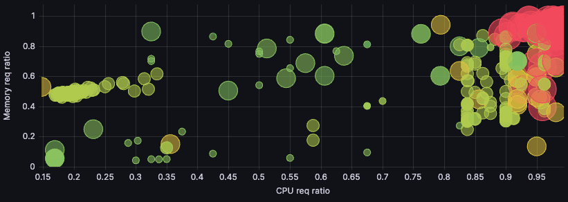

To this:
Cluster workload utilization and distribution displayed in a Grafana dashboard, mostly green circles, with some red in the top-right corner
This visualization shows utilization ratio for memory and for CPU. We strive to get both as close to 1 as possible (top right corner), which would mean complete utilization. But because CPU is our main cost driver, we use the points’ sizes to visualize the number of cores of those nodes at a glance. The points’ colors represent pricing — green for cheaper nodes, up to red for more expensive ones.
CPU being the main cost driver, as we said, means size somewhat correlates with price: The bigger the point, the more expensive it’ll be in most cases. That means we care most about the biggest, reddest points, and we care more about getting them to the right-hand side (maximizing CPU utilization) than getting them to the top of the graph (maximizing memory utilization).
Here, our most relevant nodes moved from the top center to the top right, where they clustered even more. Success!
