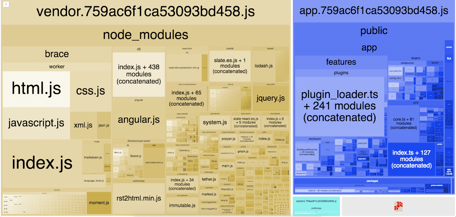

Here’s the output from before any optimization was done:
We can tell from the output that three bundles are produced: 1. “vendor” bundle that contains all of Grafana’s external dependencies 2. A main bundle that contains (almost) all of Grafana’s internal code 3. A bundle that contains some Explore-related code that was produced using Webpack’s dynamic import feature
The problem with having all of our external dependencies in one big file is that, at any given moment, most of the resources are going unused.
Translation: We’re downloading a lot of data for no real reason.

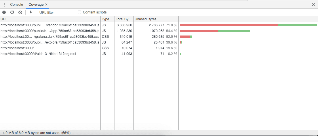

Chrome devtools has a handy “coverage” feature that lets us find out exactly how much is going unused.
We can see at the bottom that 4MB, or two-thirds of the downloaded resources, are not being utilized.

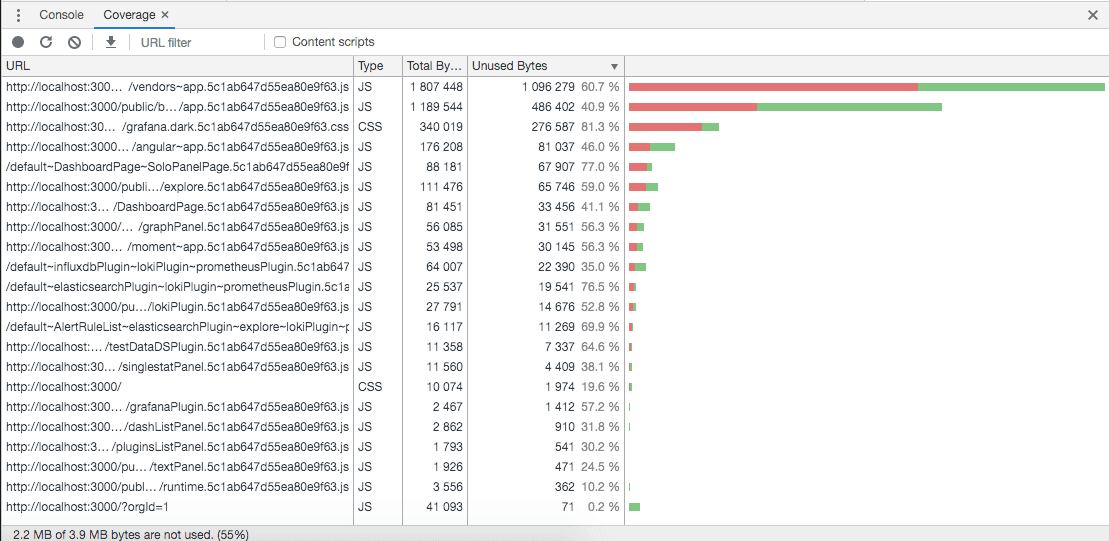

Here’s what our coverage looks like after these changes:
Here’s what the produced bundles looked like after optimization: [[SC_TOKEN_]3]]

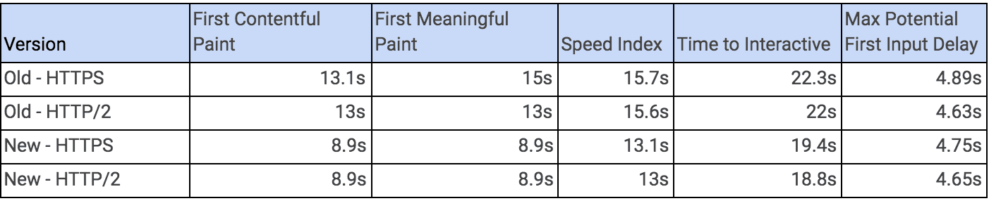

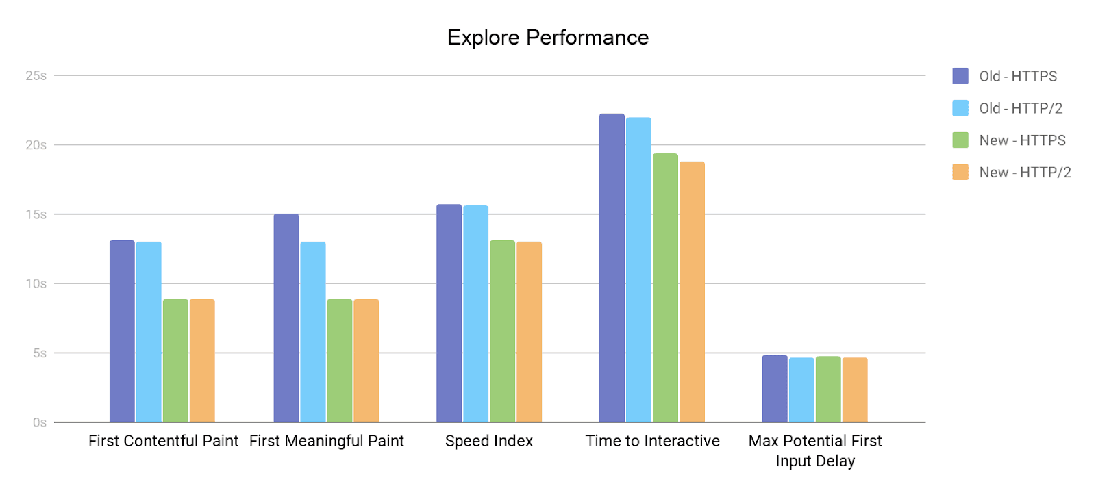

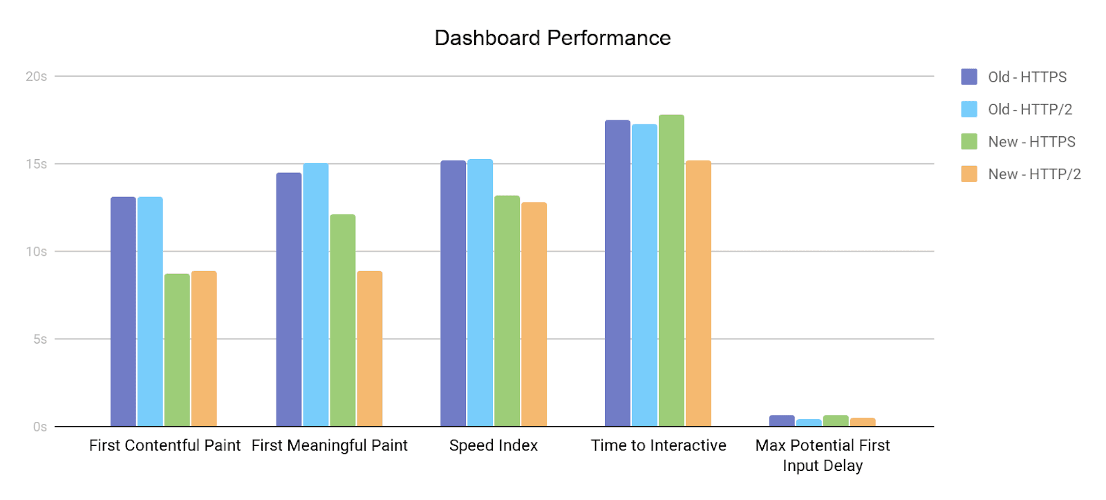

We can see that several key performance metrics such as First Contentful Paint, First Meaningful Paint, and Speed Index experience significant improvements after our changes. Making use of HTTP/2 sees an even greater uptick in these performance metrics.
Here is a look at our Dashboard Performance:
Here’s a look at our Explore Performance:
