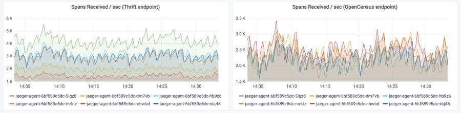

We have been using the collector with the aggregate and tail sampling processor in our internal infrastructure. We are ingesting ~14k spans a second with ~60 spans per trace with success. These are some graphs from our internal deployment of the OpenTelemetry Collector:
Embedded image
  1. Spans received from the application at the thrift endpoint.
  2. Spans forwarded between peers and received at the OpenCensus endpoint.

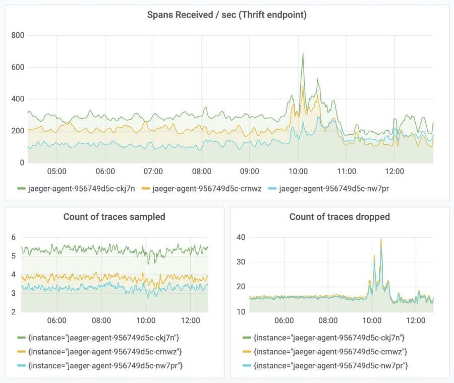

Another advantage of running the horizontal scaling tail sampling processor is that in case of a spike in incoming traffic, the storage backend is not overloaded because the number of sampled traces remains almost constant. This is depicted in the following figure: We are consistently sampling very few traces even through a spike in traffic.
