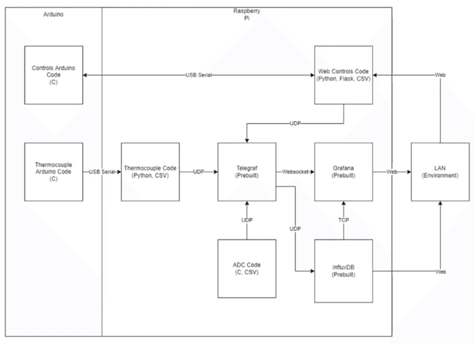

Our software stack for this year includes Flask, Telegraf, InfluxDB, and Grafana. Here is an overview of the entire ground systems architecture:
A diagram with boxes and arrows showing an overview of Rocket Project's ground systems architecture

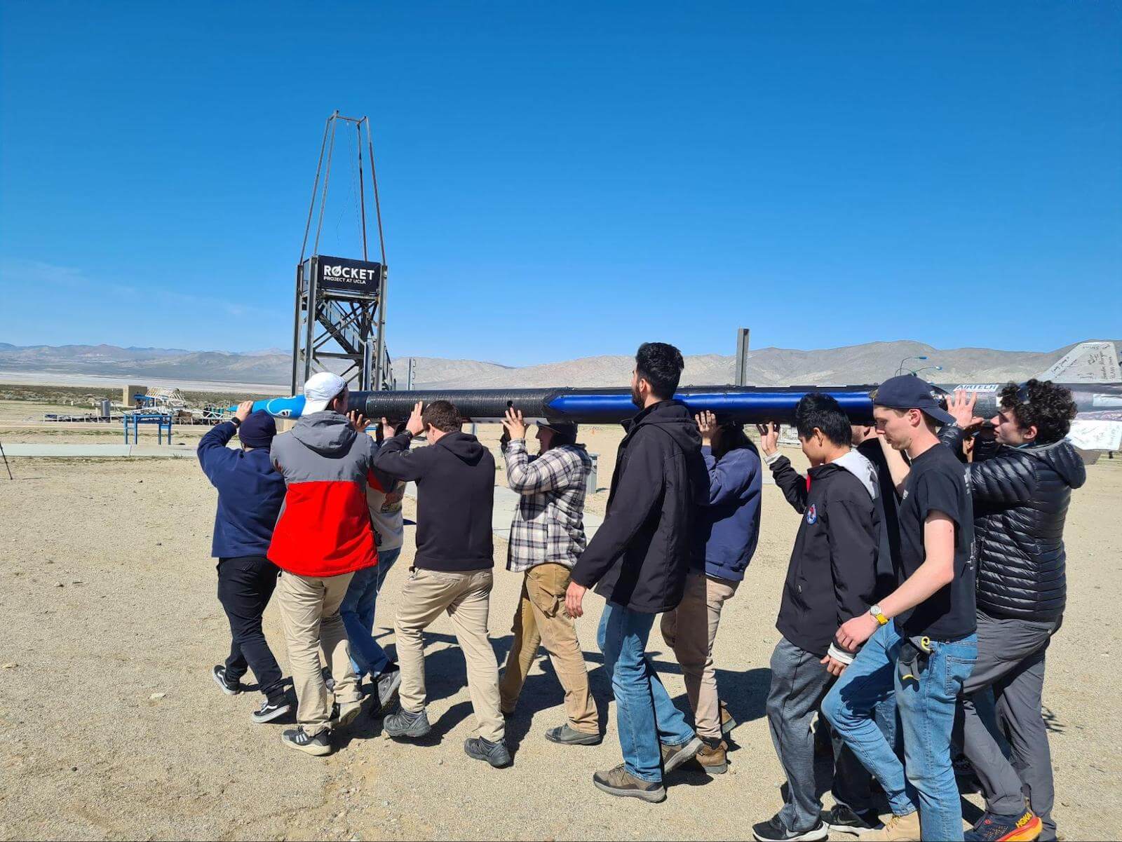

A photo of a group of people in the desert carrying a large rocket.

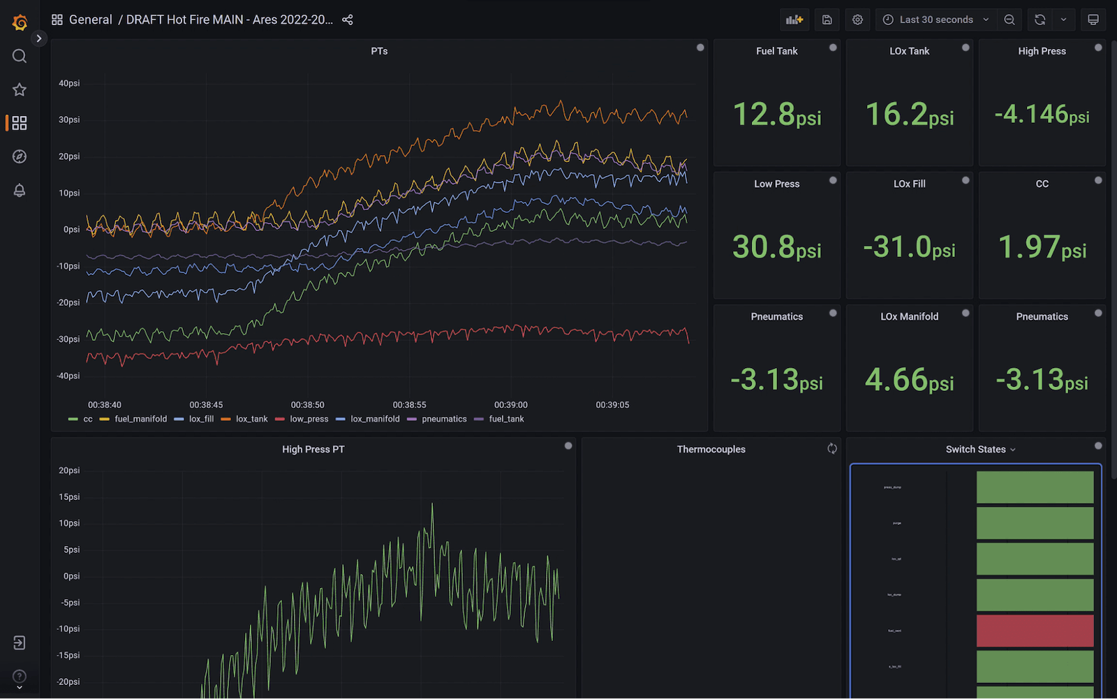

Part of our preparation includes bringing all our components to the Mojave and performing leak checks and actuation checks using the Grafana dashboard below. It shows all of the pressures, temperatures, and valve switch states I’ve previously mentioned.
A screenshot of a Grafana dashboard with sensor and valve data from a rocket test
Having a dashboard like this on hand means we can view live data from the tanks and quickly notice issues and fix them on the fly — which is exactly what happened right before the record-breaking launch.

Here is a look at the sensor and valve data in our launch dashboard:
A screenshot of a Grafana dashboard with sensor and valve data from a rocket launch
