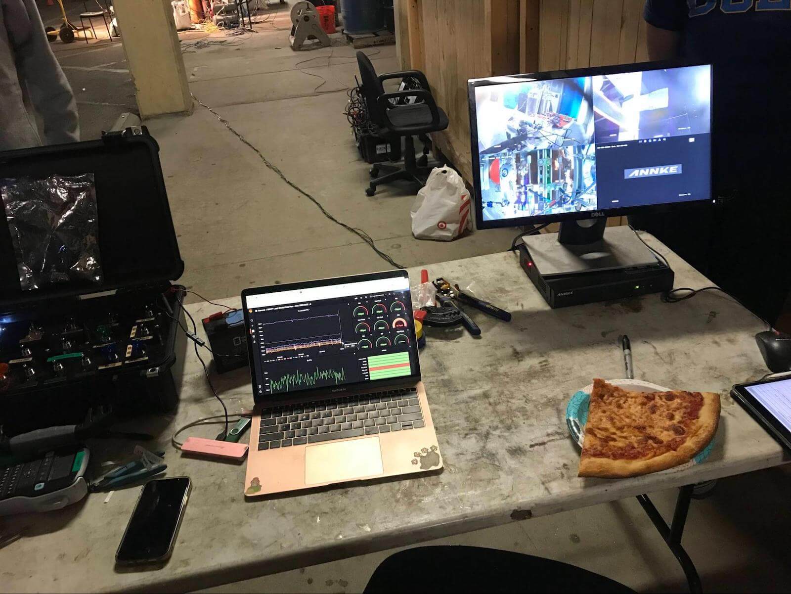

The first phase of our testing, cold flows, is done on campus and involves pressuring our system and allowing liquid nitrogen to flow through our plumbing to make sure there are no leaks and anomalies. We use Grafana here not only to observe the pressure and temperature of our liquid oxygen and fuel tanks, but also to make sure that our valves are properly actuating.
Having a timeline in Grafana that displays when the relays actuate also allows us to make sure we are properly cycling through the correct order of switches. Additionally, the quick visualization of data helps us calibrate our sensors to properly convert the raw voltages into useful metrics.
A photo of an open laptop displaying a Grafana dashboard beside a monitor and a slice of pizza

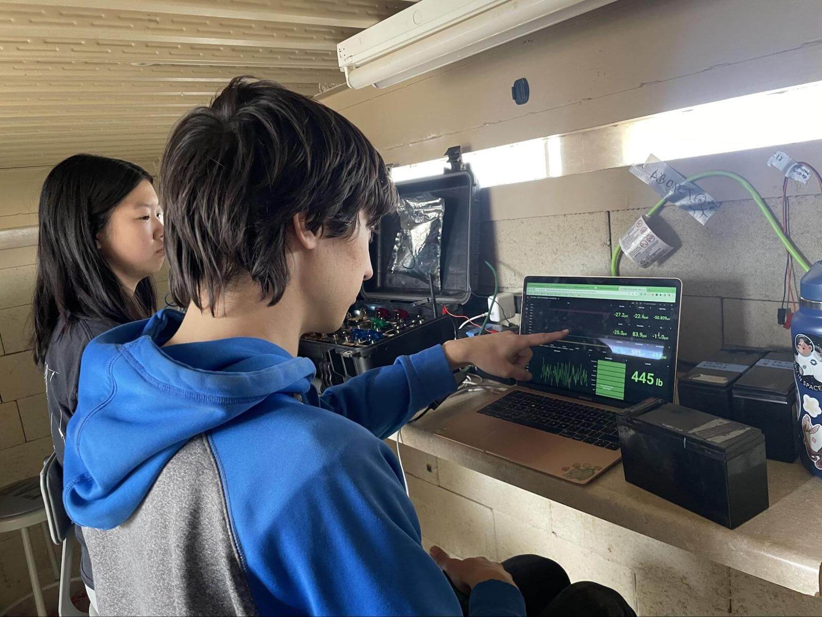

The second phase of our testing, hot fires, is performed at a test site in the Mojave Desert. It is very similar to the aforementioned cold flows, but with one key difference: We also read in load cell data.
The load cell data that is also displayed on our Grafana dashboard is used to generate a thrust curve that we can use to verify that our system is able to reach our targeted apogee.

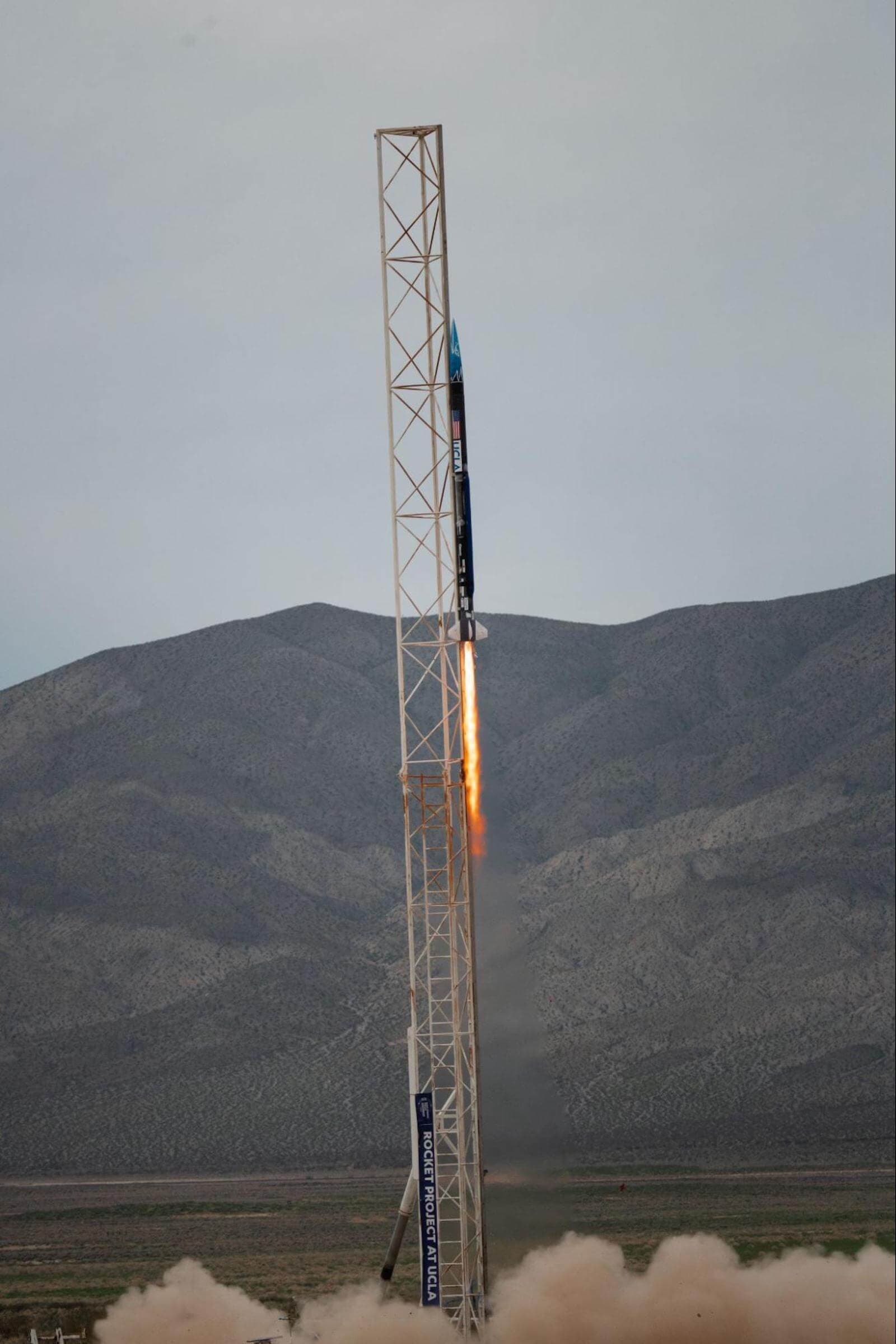

On launch day at 4:59pm, there was tension in the air — and only one minute left on the clock before the FAA disallows launches. As the ignitor went off, we watched a year of hard work shriek through the sky and clouds.

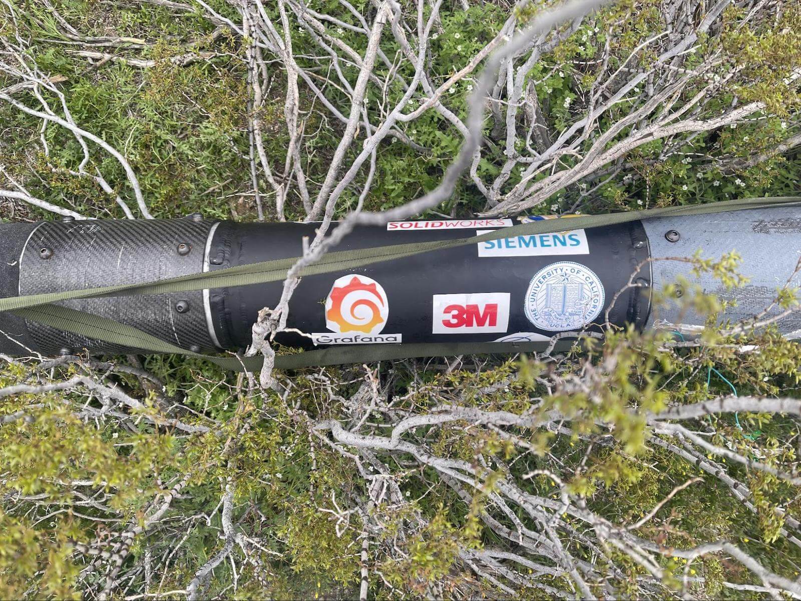

Touchdown marked the first time that our team was able to successfully recover a rocket entirely intact, a key component of the competition. A sigh of relief and sense of pride was ignited as we hiked towards the landing site, thrilled with what we had accomplished.
