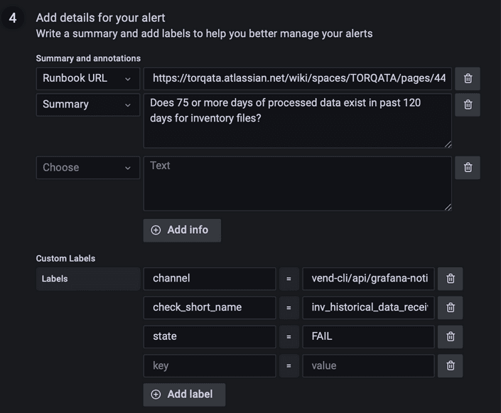

The system is designed to simultaneously signal issues with data quality and direct admins to the most efficient act of remediation. This helps eliminate downtime and fix issues before they ever get to end users and consists of three parts:
- Rule type. Groupings and names provide a quick glance into the relevance of an alert and help designate priority.
- Query and conditions. Multi-dimensional queries, along with wildcard notations, help the team parameterize a single query and apply alert conditions to all store locations within the Torqata platform.
- Details. Alerts can be tailored to automatically send the necessary information to the designated channels.
