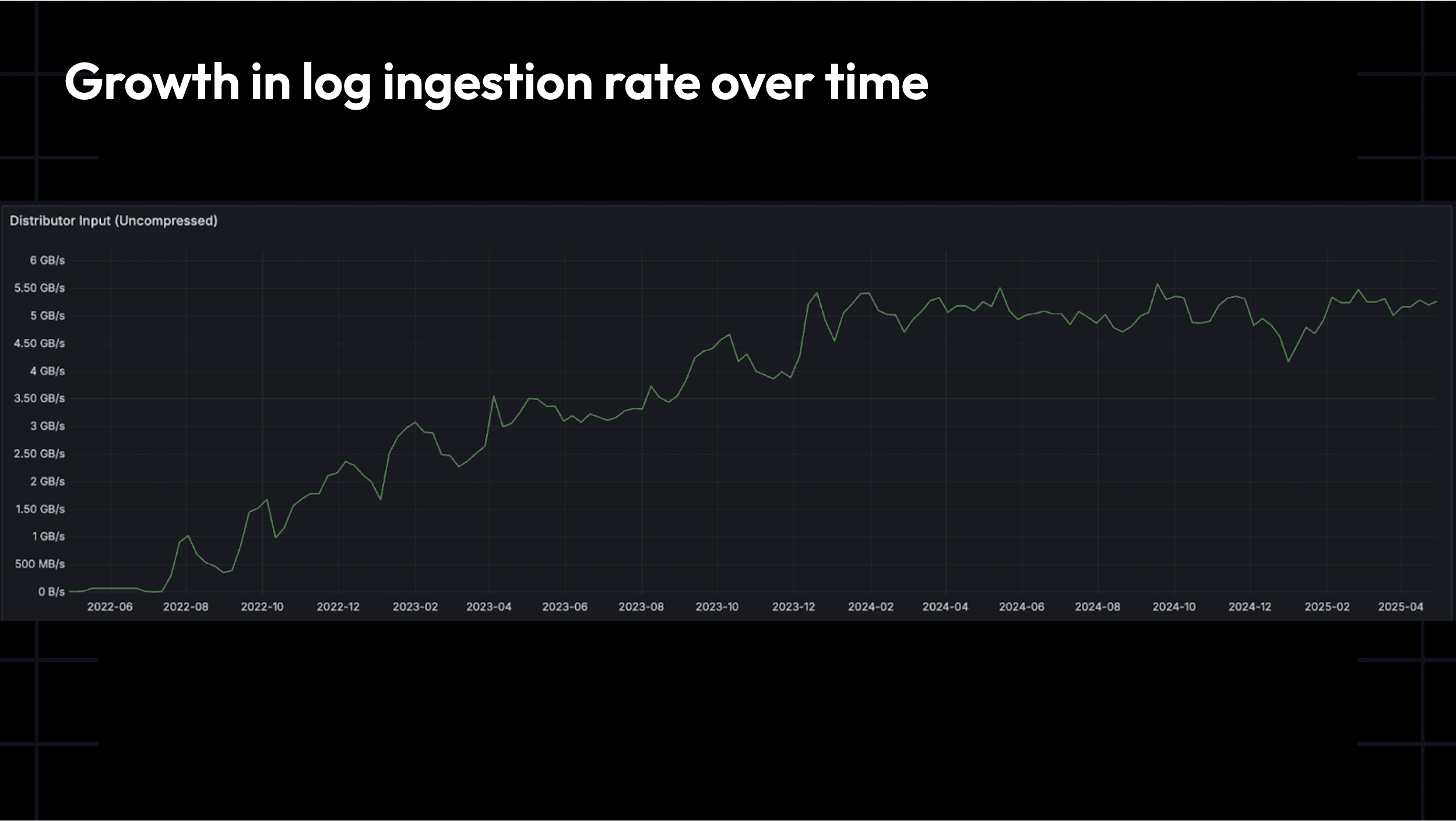

A Grafana dashboard shows how Dropbox has grown its log igestion rate over time
Today, Loki has become a trusted system across the entire company—so much so that Dropbox shut down its legacy logging system. Its shared storage and DNS-based region switching enable fast failover for high availability. And it operates at a massive scale as a core part of Dropbox’s observability stack. It now ingests 5 GB to 6 GB of logs per second, with 30-day retention totaling 4 PB to 5 PB at any given time.
